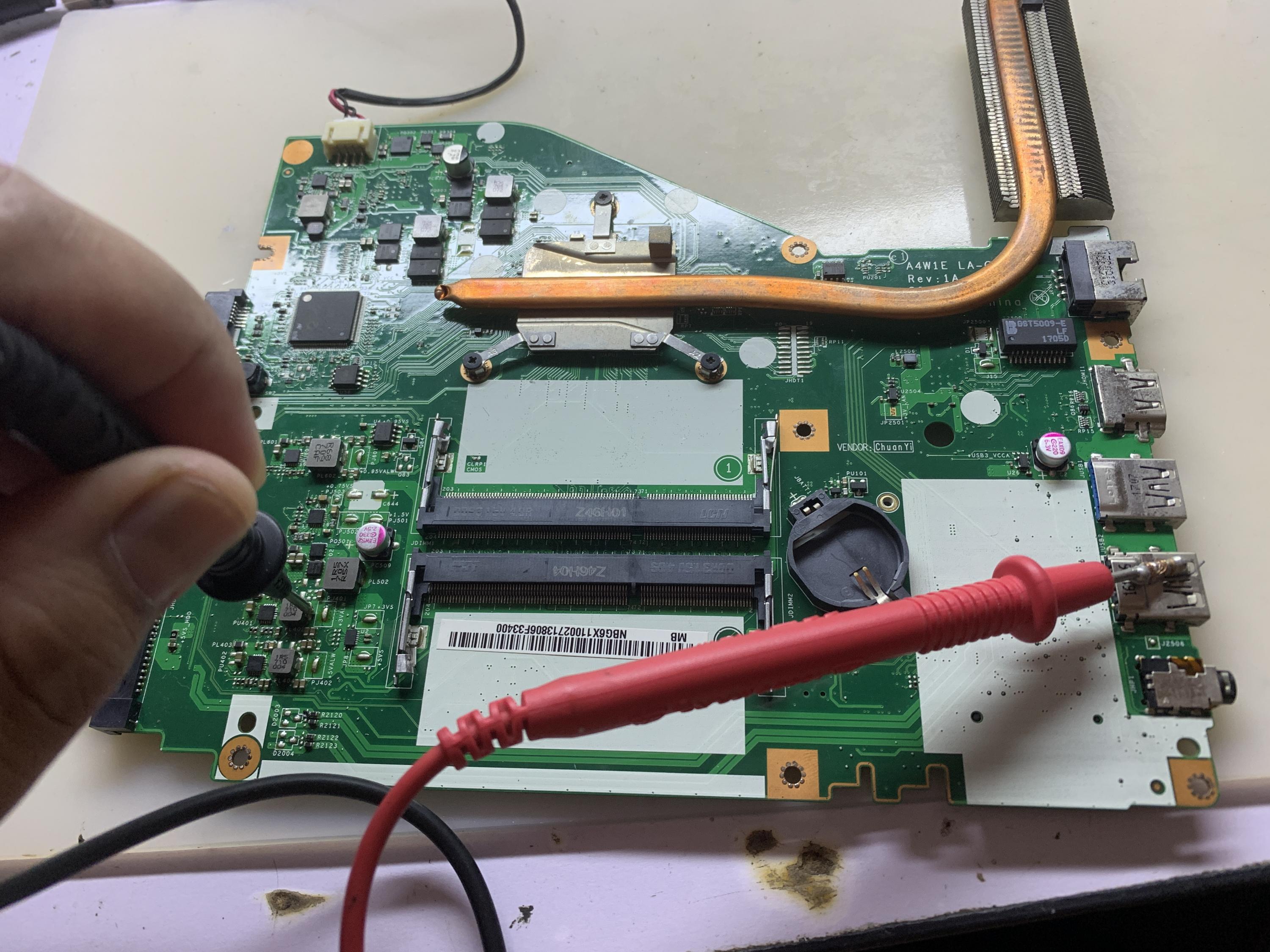

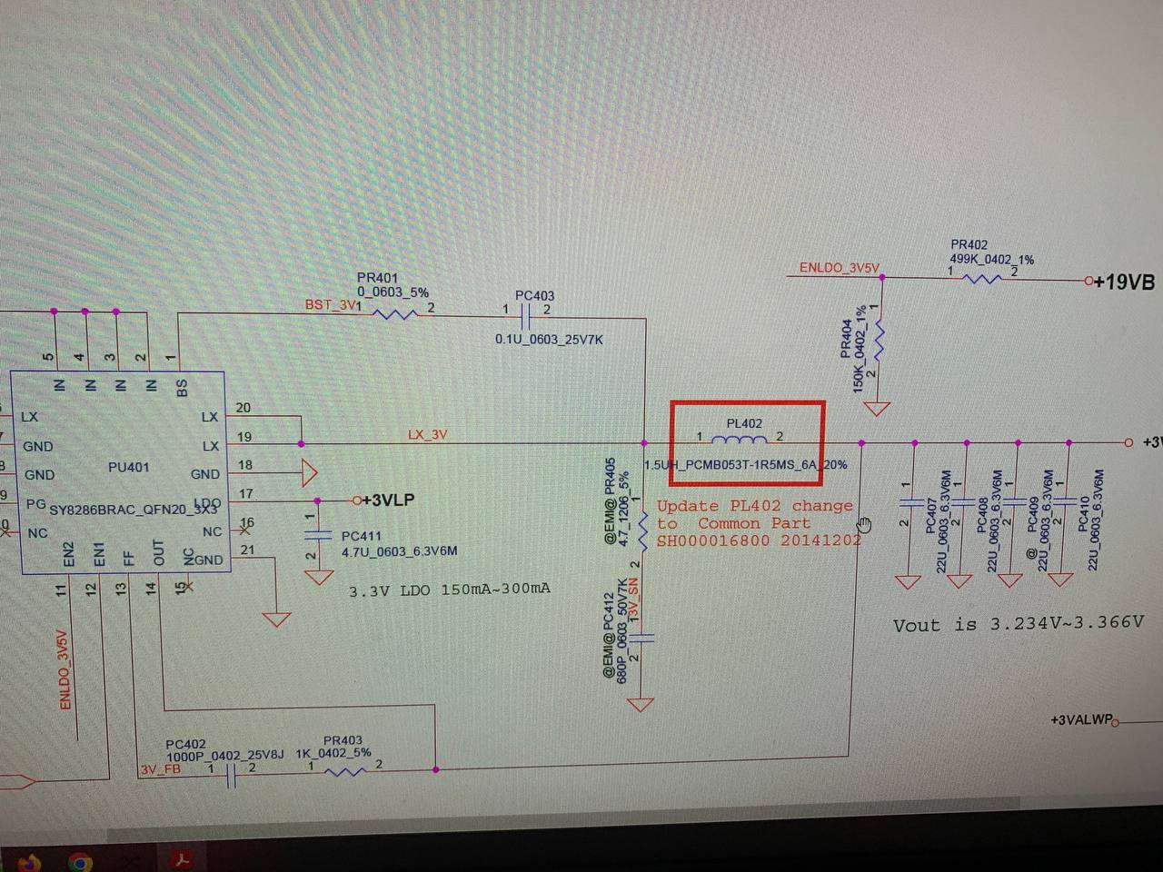

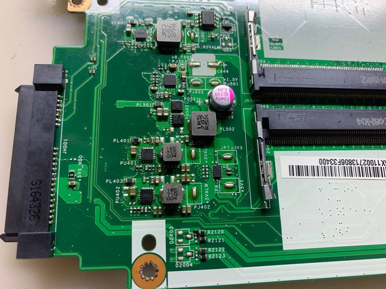

    i see the problem 3v is missing on PL402...PU401 pin number 11 read 4.34v and pin 12 read nothing...please help how to diagnos this

    What is the voltage to ground of pin #17?
    That is the 3v LDO rail.
    Next, remove all power. Meter in resistance mode. Measure the resistance to ground of the missing 3v switching power rail at the inductor / coil (PL402).

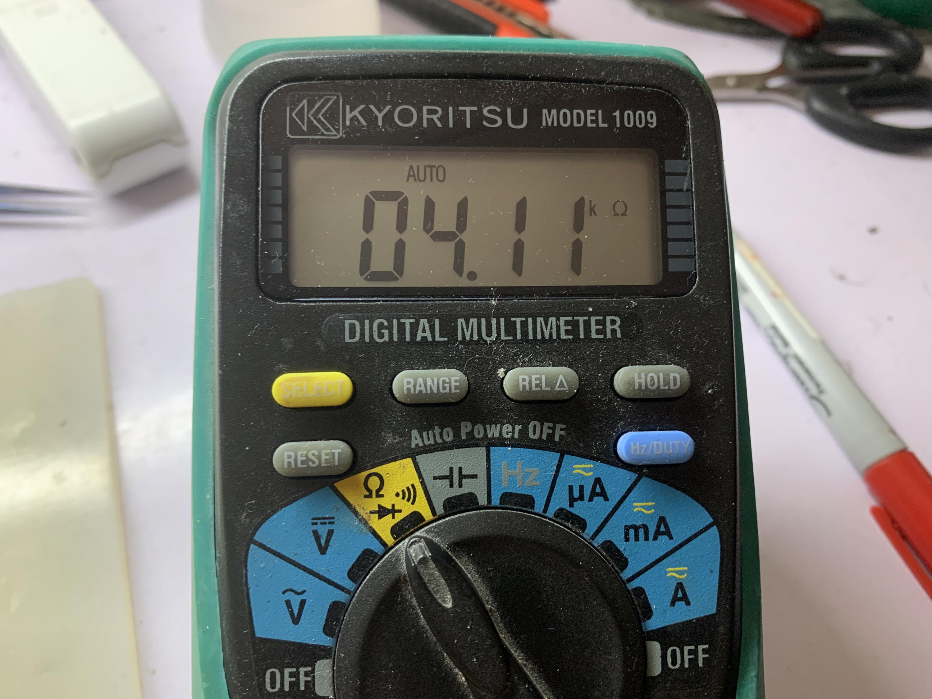

      pin 17 read 3.2v...pl402 read this

        So the output of this rail is not shorted but is not being enabled.
        With no power, measure the resistance to ground of pin #12.
        Can you link or post the schematic for this laptop model?
        Who is driving pin #12?

          pin 12 resistance read 0.981m Ohm...here the schematic and boardview sir

                Pin12 of PU401 is enabled by EC_ON released from SIO. So the focus should be on SIO's basic requirements check like VCC/AC_IN/RSMRST#/EC_RST#/LID SW# etc. Unless and otherwise SIO's requirements are fullfilled, it wont release EC_ON.
