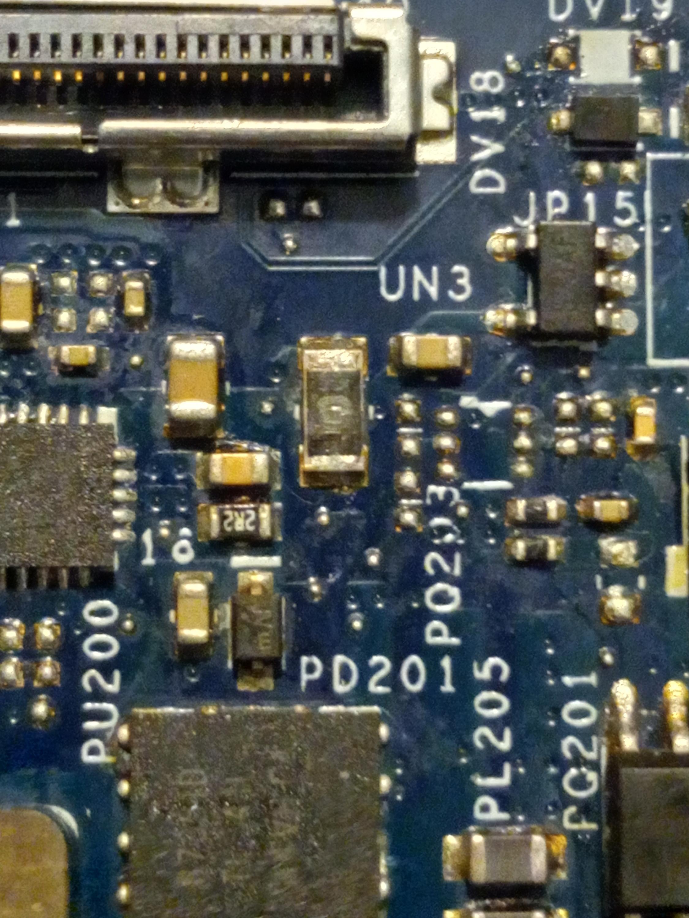

    Actually, I haven't been in to Windows on this laptop. Just got in to the Dell Diagnostics. It is a pre-Windows thing.

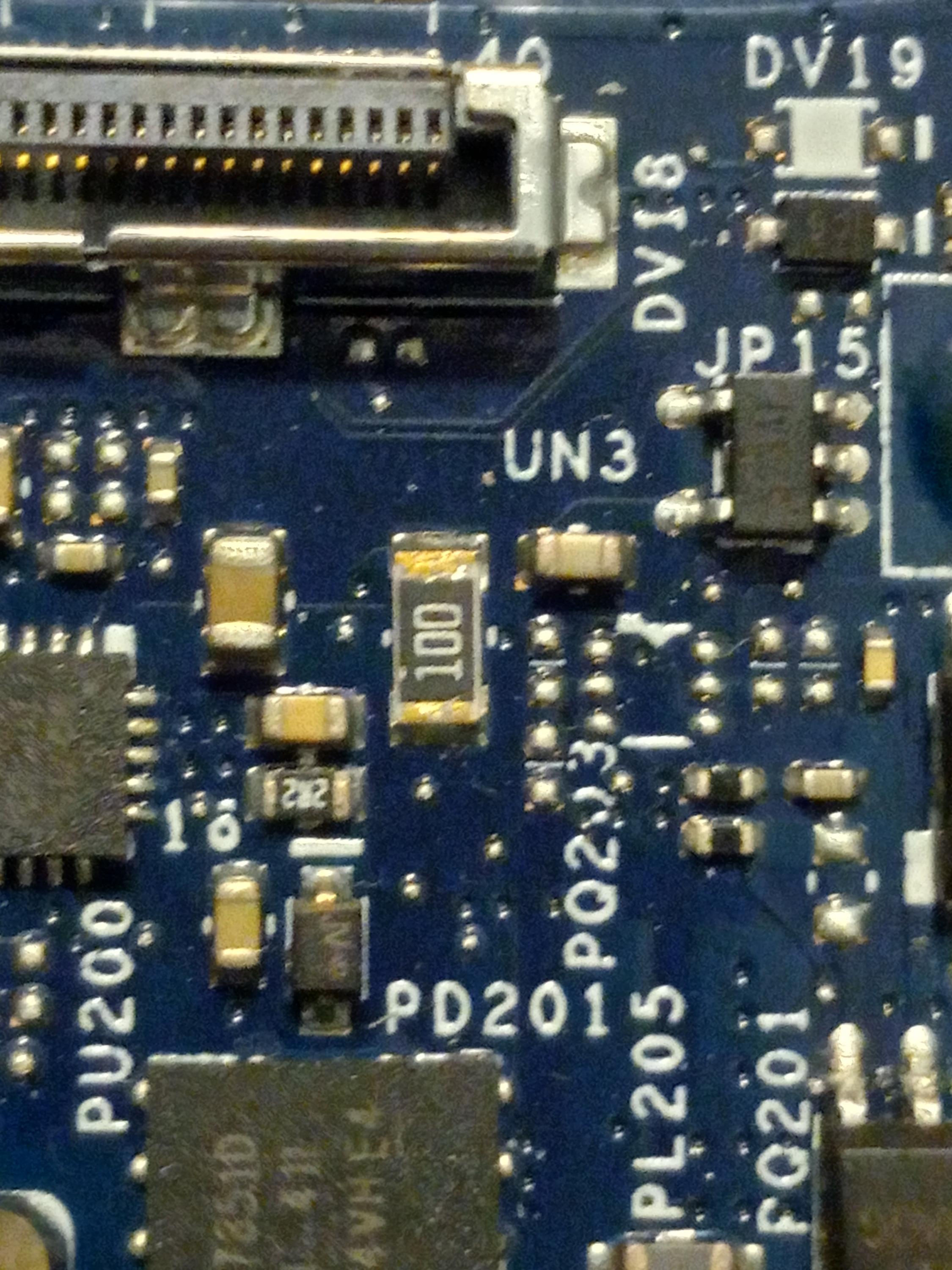

    VCC going in to PU200 is supposed to be about 19V. Also, I noticed that PR213 on the broken board looks a bit off. It's numbers on the surface are gone and the center has a light area. I measured its resistance and got 12.7K Ohms but the schematics say it should be 10 Ohms. Included is a pic of the bad resistor and a pic of a good resistor on the working board. Maybe this will help someone. The bad resistor is dropping the voltage that is going in to PU200 to 2.9V.

      Maybe I was wrong all the time but from my understanding the battery wouldn't work with a bad 10 Ohms resistor at the charging controller VCC, too. Otherwise someone would have already suggested to check there. But yeah, the resistor looks odd and the internal resistance of 12.7KOhms isn't okay (10 Ohms are correct). So check for a short to GND at any side of the resistor and if nothing turns out, replace it.
