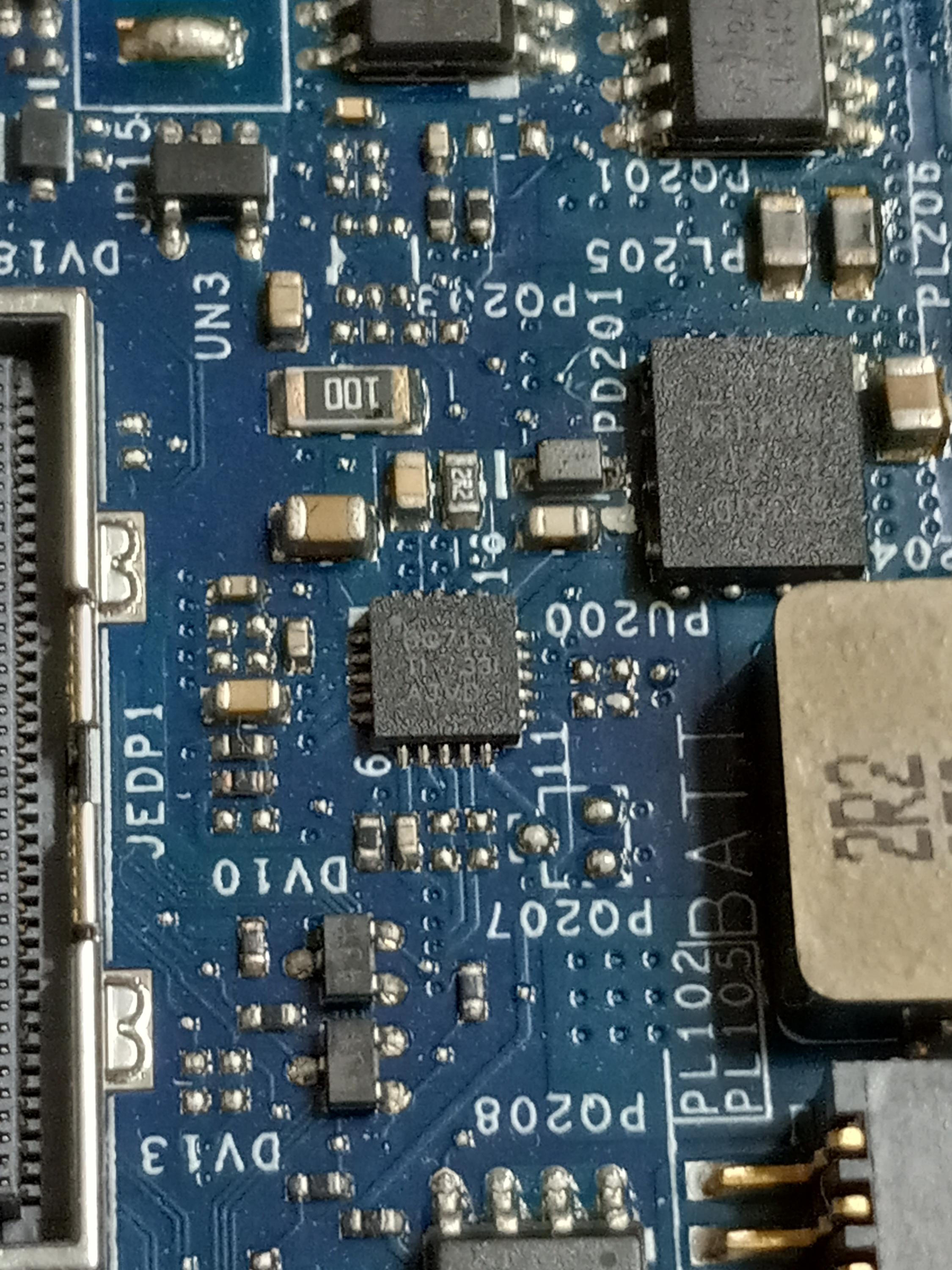

    The laptop wouldn't turn on and the charger would shut off as soon as it was plugged in to the laptop suggesting a short on the motherboard some place. I found capacitor PC205 was cracked and shorted. I replaced that. Now the charger doesn't shut off when plugged in to the laptop but the laptop still doesn't turn on. After some more probing I think I found that MOSFET PQ200 is shorted. Seems that the source, drain, and gate are all connected. I did try shorting pins 3 and 4 of the MOSFET which I think is supposed to dissipate any charge that might be in the MOSFET. If there is a charge then the gate might be open giving one the impression of a short when there really isn't one. If I have that wrong somehow then please let me know. Looks like PQ200 and PQ201 are connected to PU200. So I guess 19V was being dumped on PU200. Is PU200 probably fried? Is there a way I can check if it is OK before replacing MOSFET PQ200?

        1) the battery charger operation sticky by @piernov posted above is a must read.
        2) meter in dc volts mode (20v or higher). Measure the voltage to ground of the following points:
        a) REGN
        b) ACOK
        c) ACDRV
        On pu200. Post each measurement.

          I plugged in the AC adapter. All three of those showed as 0V which I thought was weird so I backed up to the PQ200 MOSFET and it had no voltage which I thought meant something new broke. I just forgot to plug the AC adapter port back in to the motherboard.
          REGN is 5.85V
          ACOK is 3.27V
          ACDRV is starting at 19.9V when I first connect then dropping to a range of 18.9V to 18.6V
          I guess I'm missing something basic. How do you know what the voltages are supposed to be at those three pins? I tried searching the PDF for various things but only found the diagram on page 51 that shows PU200 outputting +5VALW and +3VALW.

              ACDRV should be ~25v if all is normal and this boosted voltage will enable the DCin mosfets.
              ACDRV voltage = adapter voltage + REGN voltage.
              Carefully remove the ~4k resistor at PR208. Use flux to help. Do not lose this part.
              Then power up again. Measure the ACDRV pin voltage to ground on pu200 charger IC.
              What is the ACDRV pin voltage now?

                  When 19V rail is shorted, usually 1st dc-in mosfet is also shorted. Before troubleshooting charging IC, i think mosfet should be checked in resistance mode(without any power source) between
                  pin1-4
                  pin1-8
                  pin4-8

                      Prior to this laptop mosfets were something I'd heard and read of but not actually identified and probed so this is my first experience working with them. The nice thing about this board is I have two identical mosfets on the board and another M3800 laptop that will power on and POST ok though for some reason the second M3800 doesn't charge its battery. So even more identical model mosfets to look at if I need to. Initially I thought PQ200 was shorted but then suspected it wasn't always that simple to figure out so I went to Youtube and found a video of someone checking 8 pin mosfets on a laptop motherboard. I did what he did, being sure there was no residual charge and checked the diode that is built in, and found my PQ200 was still not behaving right and concluded it really is shorted. However, in my lack of experience I still might have missed something so went ahead with mcplslg123's request.
                      With the black probe on the first pin and red on the second and meter set at 200 Ohms
                      PQ200
                      pin1-4 1 Ohm
                      pin1-8 0.5 Ohm
                      pin4-8 1.2 Ohm
                      Looks like the source, gate, and drain are all shorted.
                      PQ201
                      pin1-4 1.1 Ohm
                      pin1-8 not connected
                      pin4-8 not connected
                      Do I have a partly shorted PQ201? I guess I missed that earlier or maybe it is a new short that recently developed.

                        The mosfets can often be replaced by others that are available from Digikey / Mouser / Arrow in North America. For example, TI and other brands can work here. If there is an interest, can check around..before Magnum PI starts.
                        On the mosfet checking, you can check the resistance of the points as follows.
                        Meter in resistance mode. Remove ALL power.
                        One meter probe to one set of pins; other probe to the other side.
                        What is the resistance ? If you see 'OL' = over limit, so select the next higher meter resistance scale...unless you have an auto-ranging meter.
                        If you see a low resistance reading, the mosfet is shorted and must be replaced.
                        A good mosfet should be hundreds of kilo-ohms in resistance.
                        So as per above, check:
                        source (1-2-3) & drain (5-6-7-8)
                        source (1-2-3) & gate (4)
                        gate (4) & drain (5-6-7-8)
                        Post each measurement AND the units of measurement shown on your meter face.

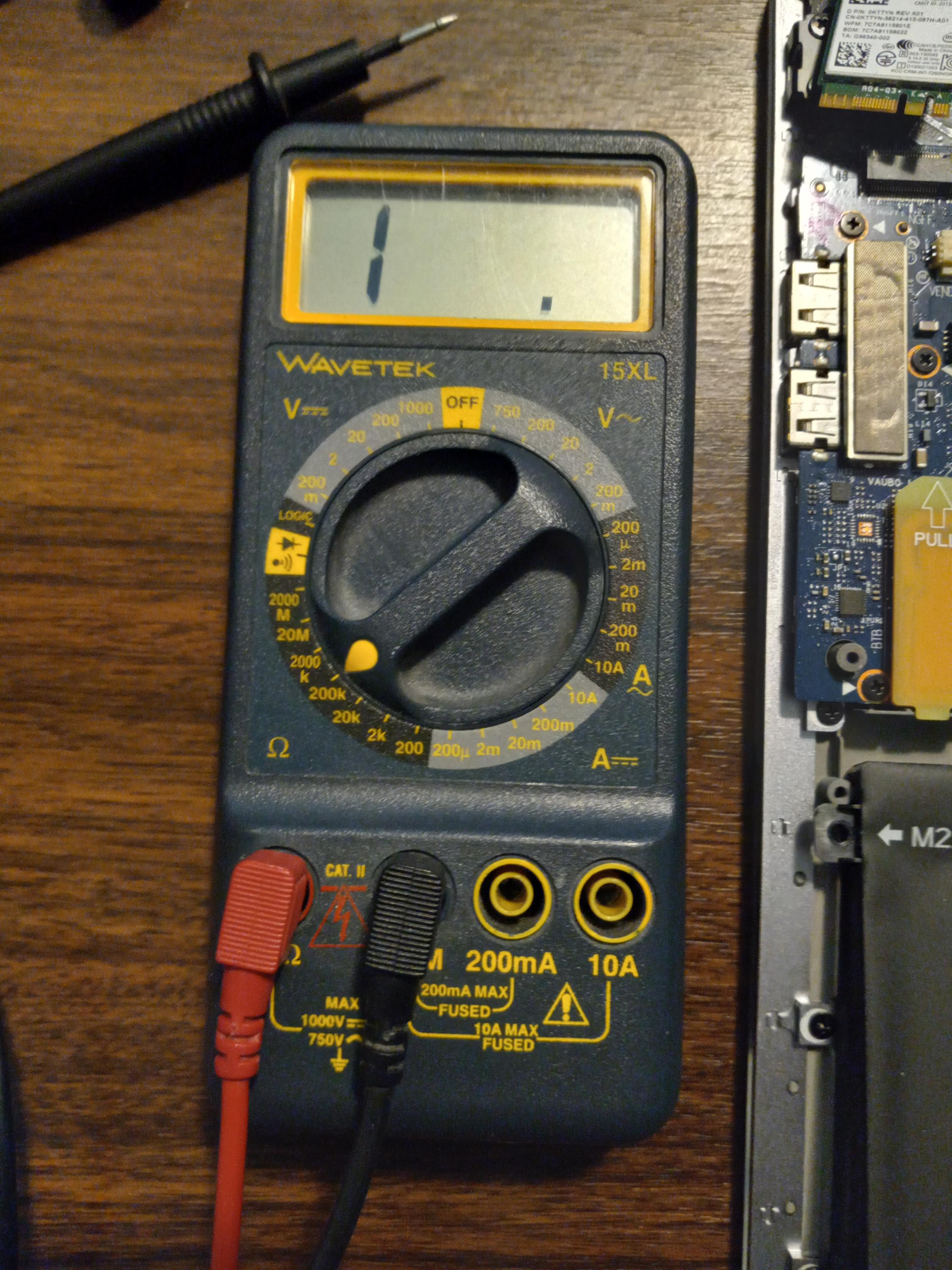

                          I had a whole thing typed out and lost it to a request to log in. So here's the abbreviated version. I've probably been typing too much anyway.
                          PQ201
                          source (1-2-3) & drain (5-6-7-8) mm set at 2000M, 12
                          source (1-2-3) & gate (4) mm set at 200, 1.3
                          gate (4) & drain (5-6-7-8) mm set at 2000M, 12
                          I tried the 20M and lower ranges but got nothing.
                          Attached is a pic of the multimeter in case that helps inform every one of what I'm working with. I don't trust the 2000M range setting. If I touch the probes together I get a 9 and if I touch them to my thumbs I get a 13.

                              From the shared measurements, this mosfet does not appear to be shorted.
                              BTW - for your meter, if you see the left side '1' = the meter scale is too low to measure the device under test. Then select a higher resistance scale.
                              '1' = over limit for your meter.
                              Proceed to perform the same measurements on mosfet PQ200.

                                  PQ200 is clearly shorted and needs to be replaced. PQ201 is not shorted.However, you can re-measure resistance on PQ201 after removing PQ200 and that'll prove that PQ201 is not shorted.

                                    Right, PQ201 sort of is shorted but the short isn't in PQ201. The source to gate short is most likely in PQ200 and I'd have to separate them to be able to check for sure.
                                    PQ200
                                    source (1-2-3) & drain (5-6-7-8) mm set at 200, 0.5
                                    source (1-2-3) & gate (4) mm set at 200, 1.1
                                    gate (4) & drain (5-6-7-8) mm set at 200, 1.3
                                    The drain of PQ201 is not shorted to ground but it would have been if I hadn't replaced PC205 earlier as I mentioned in my opening post. The mm showed a left 1 until I set it 2000M and then I got a 10. So, basically, no short there.

                                      I replaced PQ200. Now the laptop will turn on, shows a power button light, then turns itself off after about 4 seconds. So, some progress was made but there is still something wrong with it.
                                        Re: Dell Precision M3800 won't turn on
                                        PU200
                                        REGN is 6V
                                        ACOK is 3.3V
                                        ACDRV is 25V
