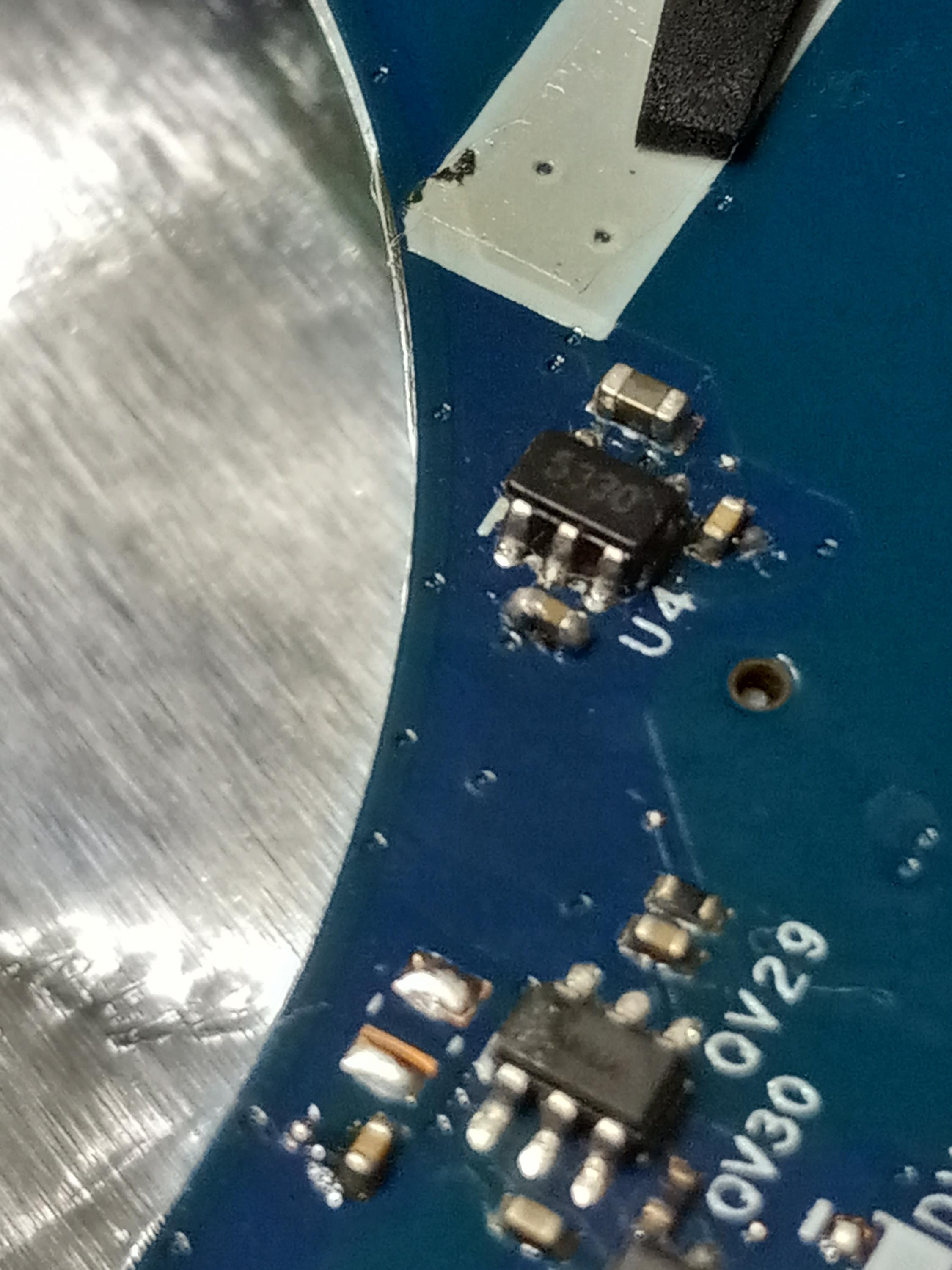

        I was probing around QV29 and QV30 and saw a messed up capacitor nearby. See attached photo. It is CT44.
          Re: Dell Precision M3800 won't turn on
          Apply flux and use low air pressure on this area. Apply the heat from the topside of the cap. Allow for the flux to trigger and the cap will swim back onto it's pads. Test again after this repair.
            I guess I somehow caused this damage while taking the board out and putting it back so many times. Looking at it, I think one pad is still in place on the board and the other pad pulled up with the capacitor but is still holding on to the board on one end and that is what is still holding the capacitor where I found it. Could I just solder it to pins 2 & 3 of U4? I'm going to check the connections of pins 2 & 3 just to be sure they are still connected to the things they are supposed to be connected to.
            Edit: I just probed for continuity. I'm not sure how but that little capacitor seems to be still connected to everything!

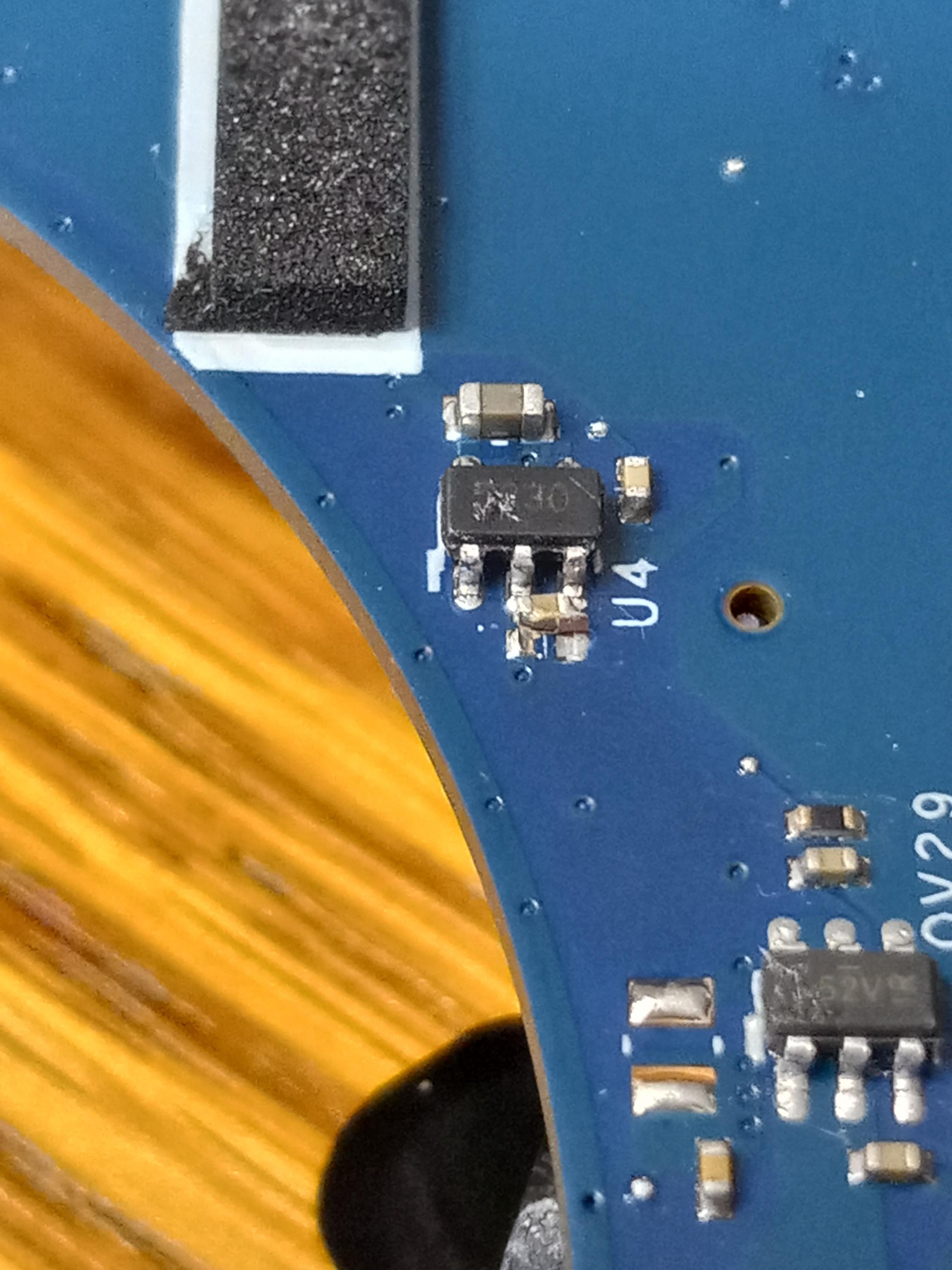

              Post pics of what you are up against.
                A couple more pics. I think that's the best I can do for quality.
                Maybe I need to just gently push the cap pad back in to its spot, reflow the connection points, and then get some UV setting conformal coating to keep it in place.
                Or, I have some spare 10uF 25V 0805 caps. I could put one running diagonally from pin 3 to CT44's pad that is still on the board.
                  You will need to apply ample flux. I read on a PCB website that even vaseline will work as a flux for soldering.
                  reference:
                  https://www.candorind.com/what-is-solder-flux-guide/
                  * see details in this article
                  * PS: We have used Candor in the past with excellent results. In our opinion, one of the best PCB shops in Canada.
                  After you apply the flux, be sure that your hot air tool is at least 350C (or higher) so that the flux activates and the solder on the PCB starts to melt. Only then, use your tweezers to shift this capacitor away from the IC and onto the pads where it belongs. When the heat is high enough, the capacitor will swim and move away with a gentle push. Be patient.
                  Use the solder in liquid state as a guide on when to nudge the capacitor.
                  Try again.

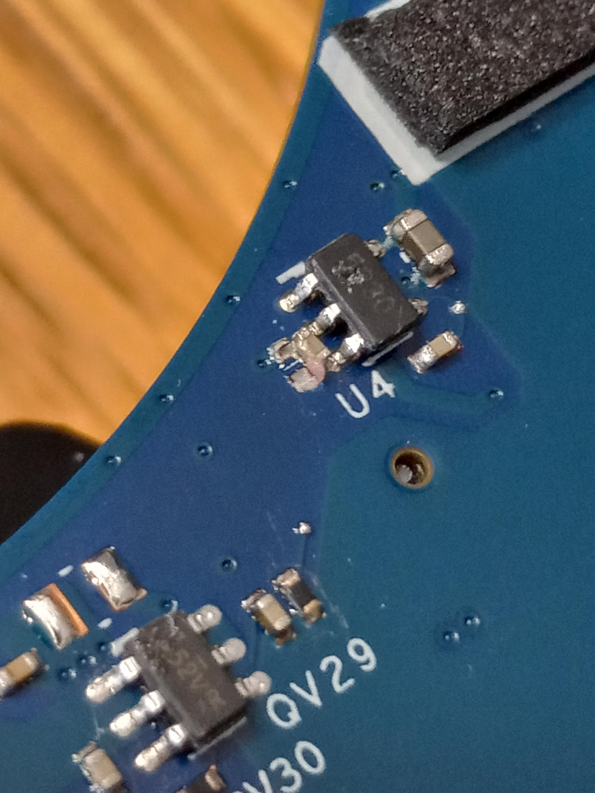

                    I got it back to where it belongs. See photo. Plus, I made sure there is continuity between the capacitor ends and pins 2 & 3 of U4 like there should be and I made sure I didn't short the capacitor somehow.
                    Though, that didn't fix the problem. I press the laptop power button and see a power light for about 4 seconds, no keyboard backlight and no screen backlight, and then the laptop switches itself off.
