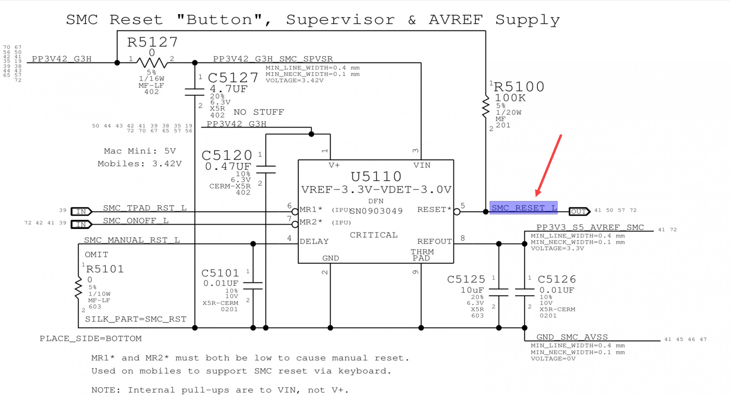

          can´t find SMC_RESET_L my be your mean SMC_LRESET_L? I measured it on Resistor R2083 pin 2 and i get 0,00V.
          and PP3V3_S5 3.30V
          • mon2
            • Dec 2019
            • 14662
            Re: A1398 820-00138 Power on but No Charging no Green or Orange Light
            See attached.

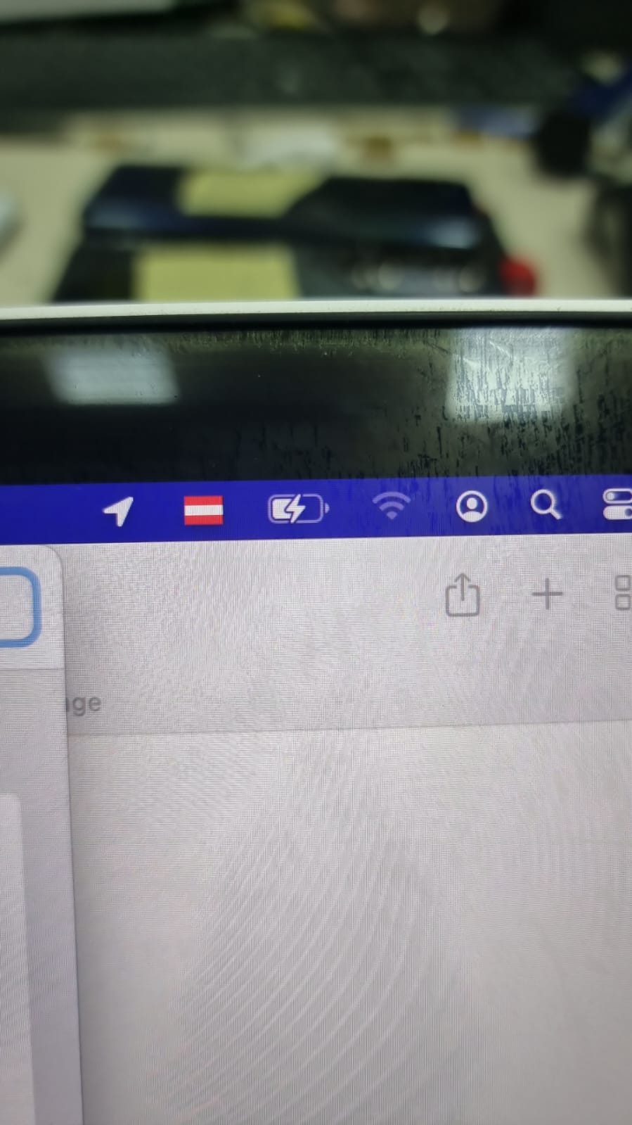

                        can some one say me, the macbook charging now, but I dont see charging symbol.
                        What can be problem?
                                  After reinstall OS, the Symbol is again here.
                                  • mon2
                                    • Dec 2019
                                    • 14662
                                    What symbol??
                                    • isa198585
                                      • Feb 2020
                                      • 71
                                      • austria
                                      look this
                                      • mon2
                                        • Dec 2019
                                        • 14662
                                        So it is now working ?
