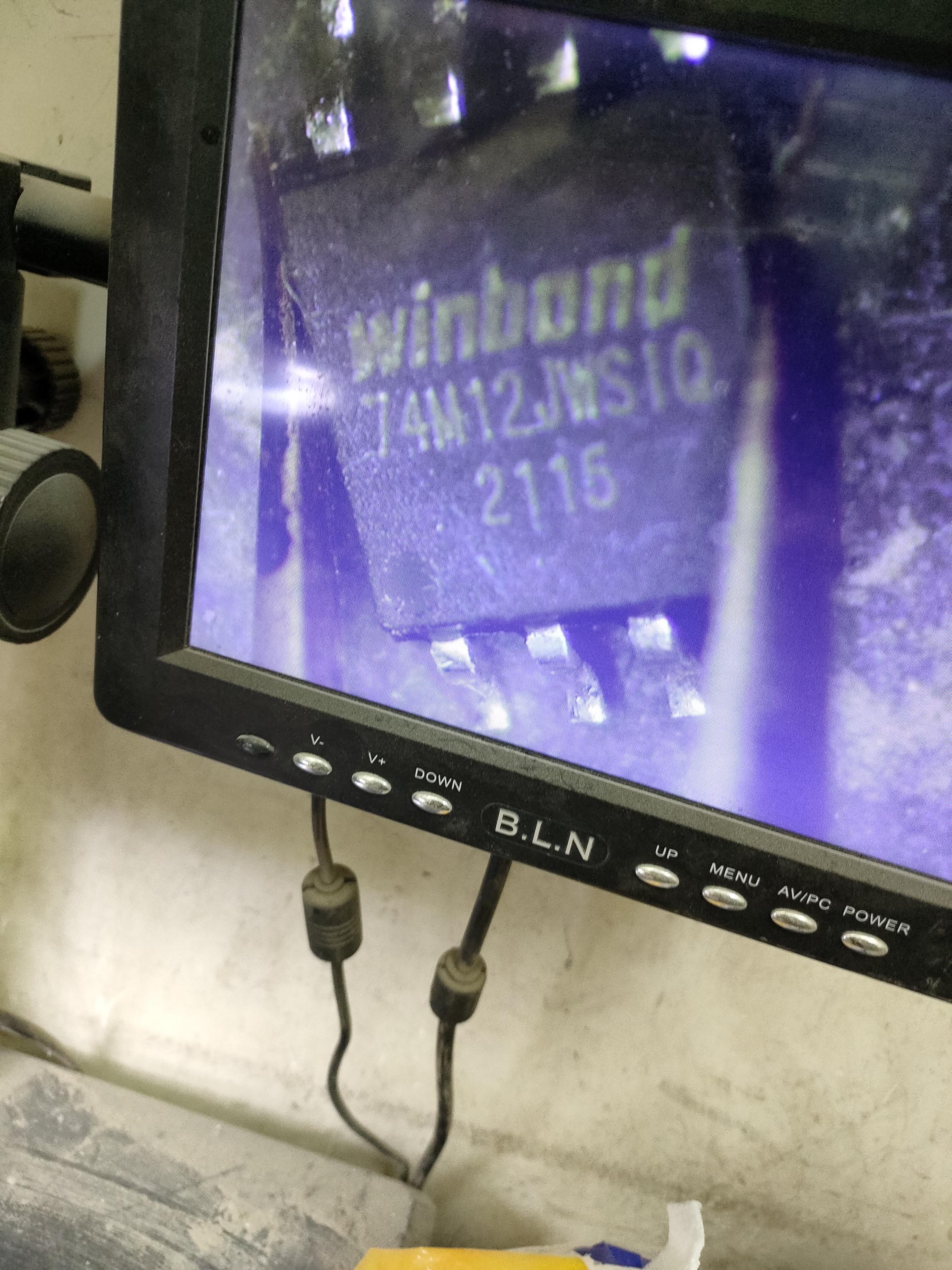

need help how to programming winband ic id 74m12jw

    Can you post a clear pic of this part?
    Unable to locate this part from Winbond.

      Re: need help how to programming winband ic id 74m12jw
      this plz help
        Hmm..house marked ??
        From which computer / laptop / logic board ? Can you post more details ?

          Do you have a programmer, if so what model is it ?
            yes i have rt809h
              Is this of any help?
                Thanks @R_J. Never knew this line of parts even existed from Winbond, till now.
                  What kind of device is using this currently? Seems to be challenge/response SPI flash and would prevent copying and unauthorised updating. No data sheets so difficult to know.
                    I also found this: https://forum.reveltronics.com/viewtopic.php?t=972
                    All W74xx can be programmed as standard 25 series SPI FLASH devices. It has even the same chip IDs as W25xx. The difference is in authentication layer. W74M stores up to 4x SHA-256 keys for authentication procedure. What's important - keys are not used for encryption. Keys are one-time programmable - once programmed, it can not be changed. It's usually used for anti-clonning protection.
