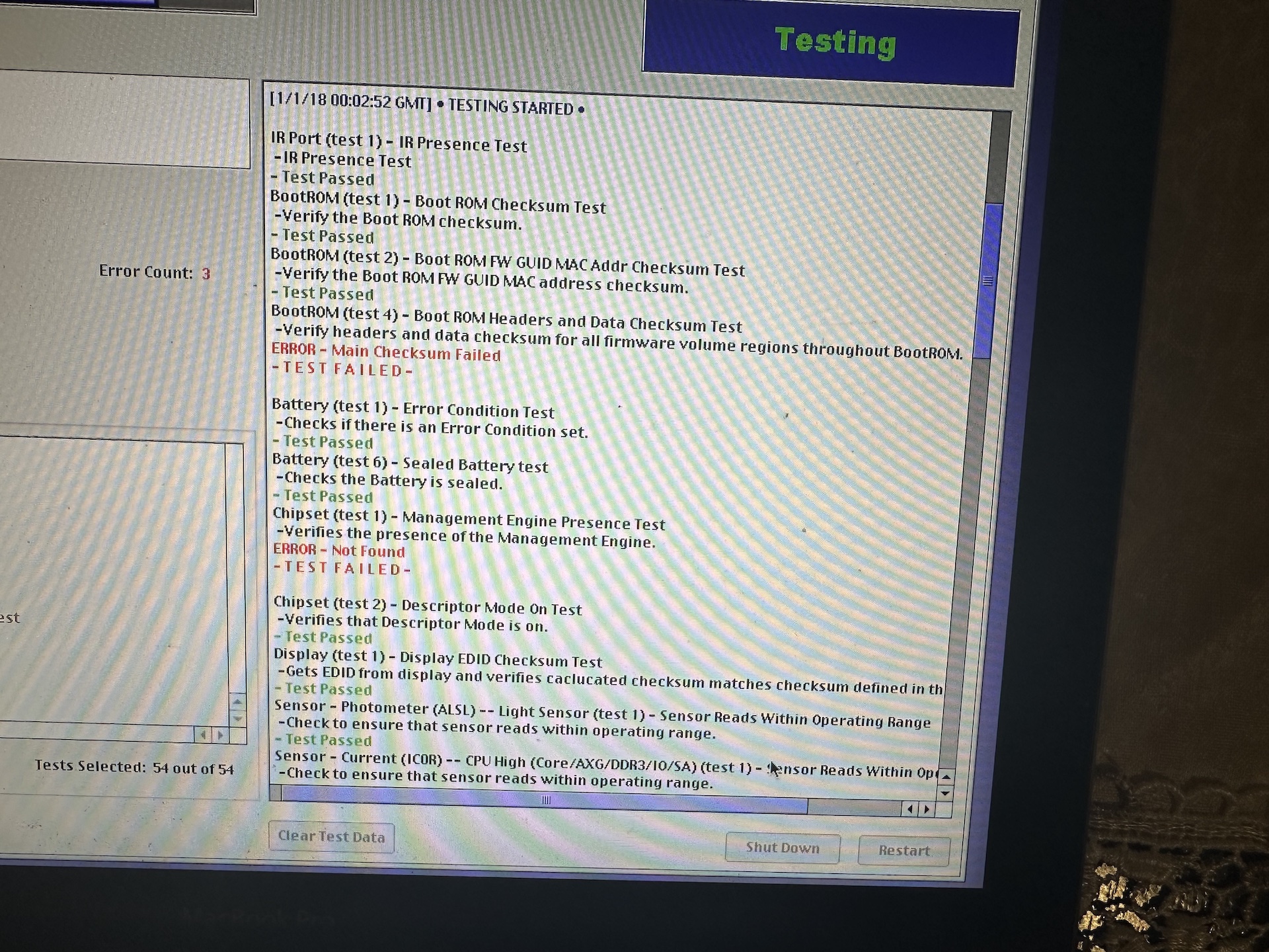

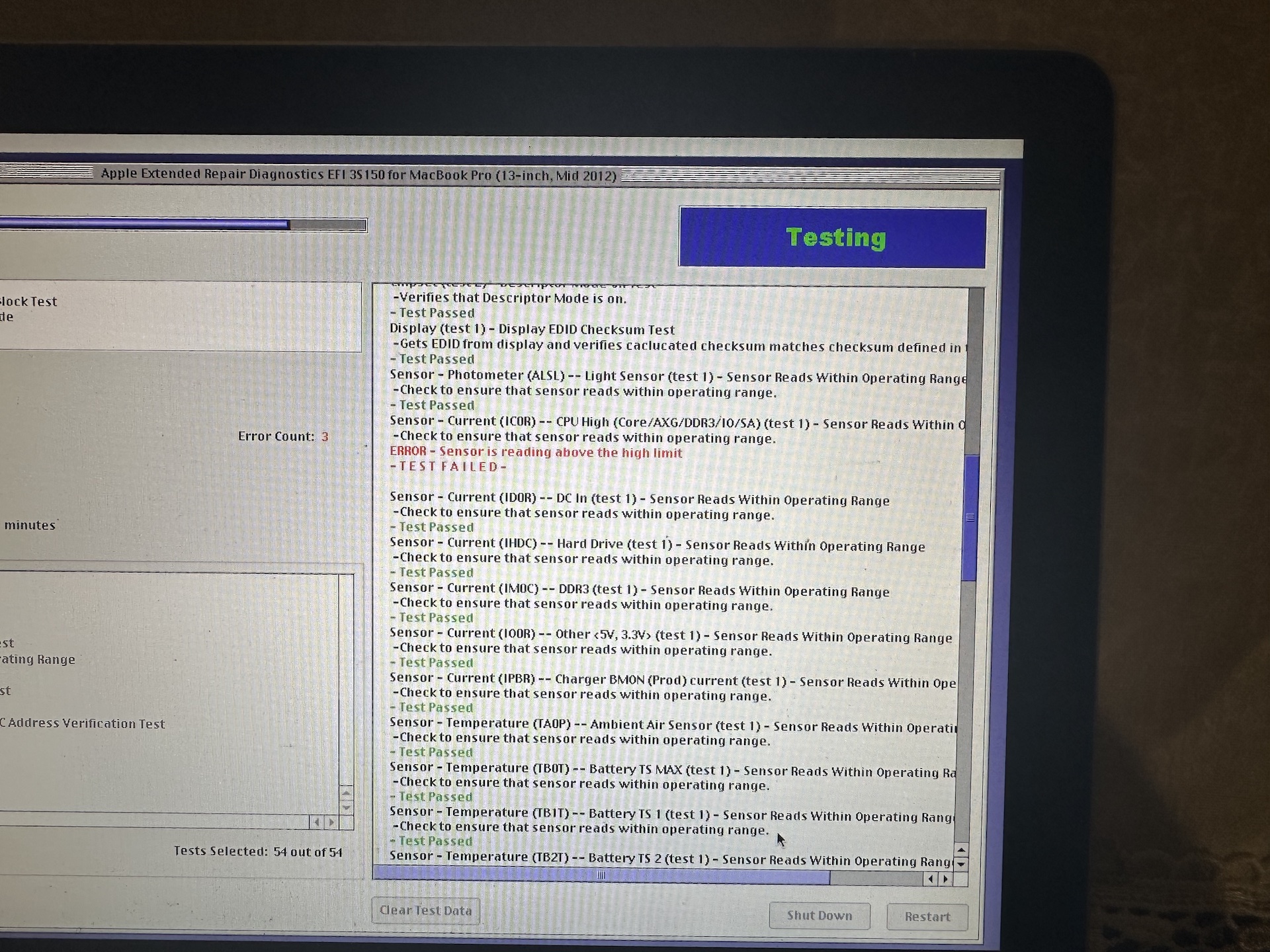

    hi there
    this mac 820-3115 , soo slow and not booting i start using ASD please check attached photos

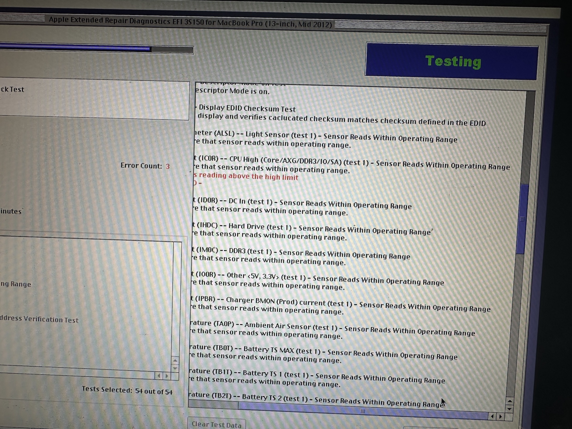

    i satrt with "Power Sensors: High Side"
    i found there is issue @ "OTHER High Side Current Sense (IO0R)"
    PP3V3_S0_HS_OTHER_ISNS = 3.3
    ISNS_HS_OTHER_N = 12.6
    ISNS_HS_OTHER_P = 12.6
    HS_OTHER_IOUT = 0
    so i removed R5419. and still same issue no short to ground at all clean board and i replaced U5410 with same issue no change
    any suggestion

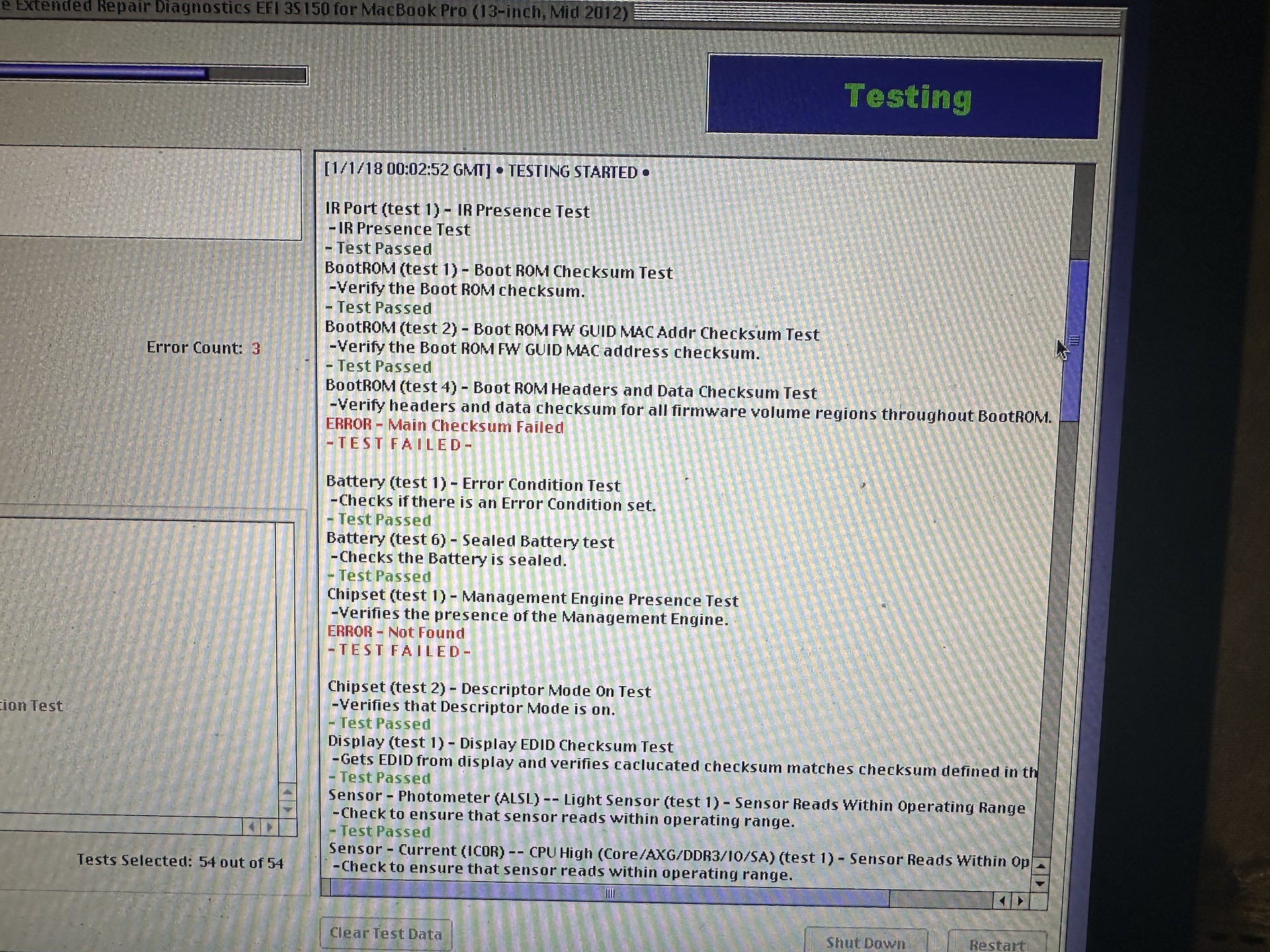

    Re: A1278 "OTHER High Side Current Sense (IO0R)"
    I believe that you also have a bios fault from the error linked to the ME. Suggest to review the bios. Has it been replaced?
      yes sir
      i did already sir bios was totally damaged and someone expert here in the forum helped me with bios clean version and replace bios chip
