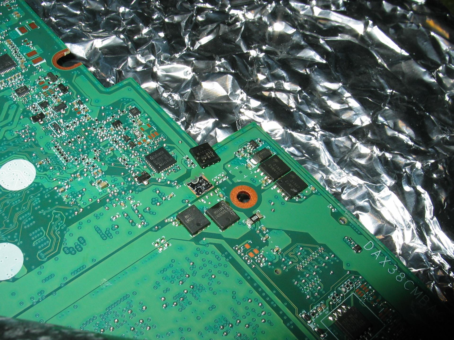

HP Sprectre x360 15-DF DAX38CMBAG0 (Quanta X38) not charging

    Re: HP Sprectre x360 15-DF DAX38CMBAG0 (Quanta X38) not charging
    replacement board
    You ordered the complete logic board and it does not charge???
    I am with @reformatt, the adapter is not being sensed to be powerful enough. Test others. HP uses a resistor to define the power rating of the adapter.
    • Rainbow
      • Aug 2005
      • 1375
      I've already checked continuity from the adapter's center pin to the board and it's OK. Also the center pin voltage on the board changes - it's 820mV with the original 135W adapter and 682mV with 60W or 90W adapter. It does not charge with any of them...
      Maybe the fault is so common that the "new" board has the same problem?

                    Discovered some more FETs on the back side of the board (completely covered by black plastic sheet)!
                    There are two AC switching FETs and three that look like bypass FETs from ISL9241 datasheet. As they were nowhere to be found (and there's no schematic), I thought that there was no bypass.
                    There are two 0203GMT (AP0203GMT) (in parallel) on VADP side and one M3092M (QM3092M6) on VSYS side. There's G-S short! Used bench supply to force current through the short and looks like the short is in QM3092M6.
                    • Rainbow
                      • Aug 2005
                      • 1375
                      #30
                      Removed QM3092M6 and it's really shorted G-S. S-D looks good, however. No more short on the board.
                      Replaced by FDMS0310AS (from a dead board). It's charging now!

                        #31
                        So both boards had the same fault then?
                        • Rainbow
                          • Aug 2005
                          • 1375
                          #32
                          Yes, the "new" one has the same short. Haven't fixed it, will try to return it instead. Seems to be a common failure.
                                    Attaching photo of the shorted FET.
