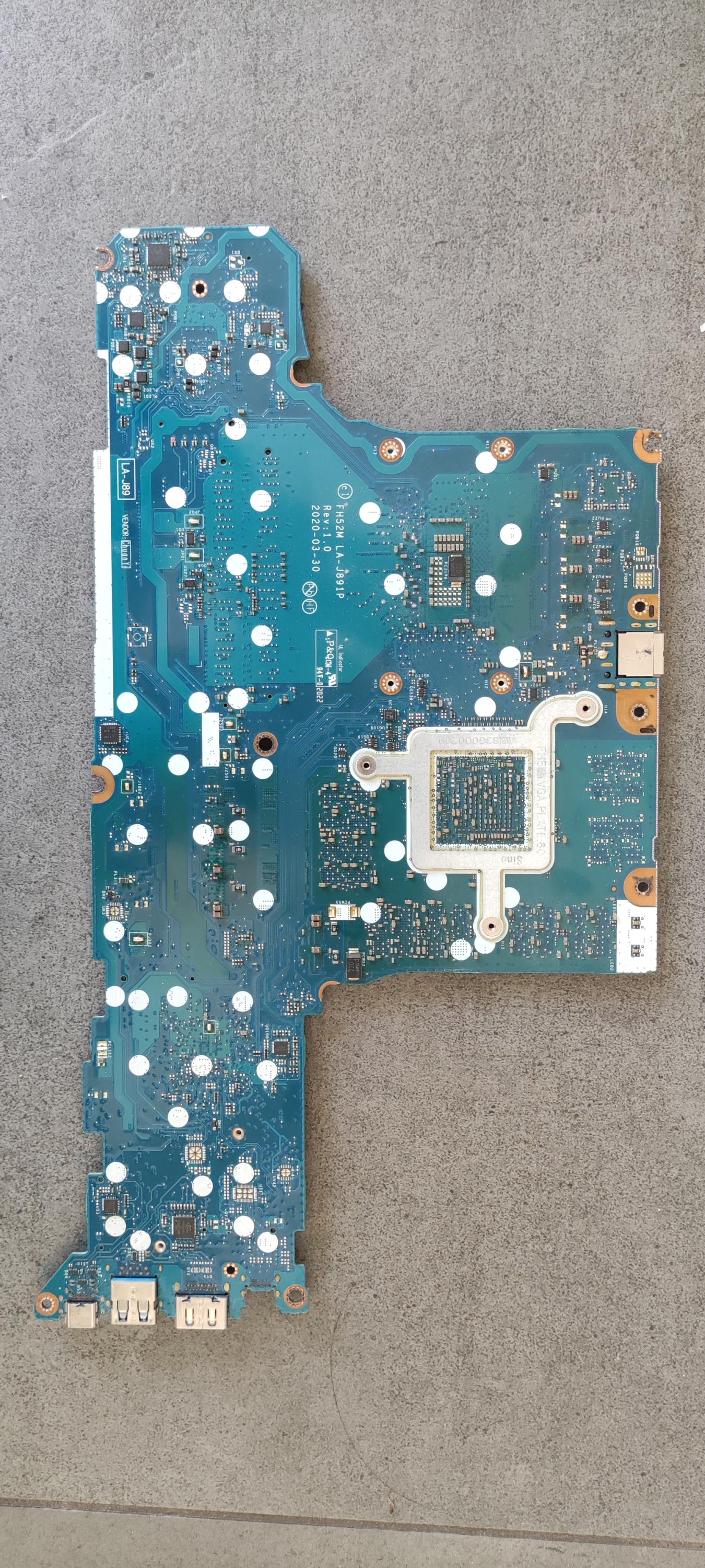

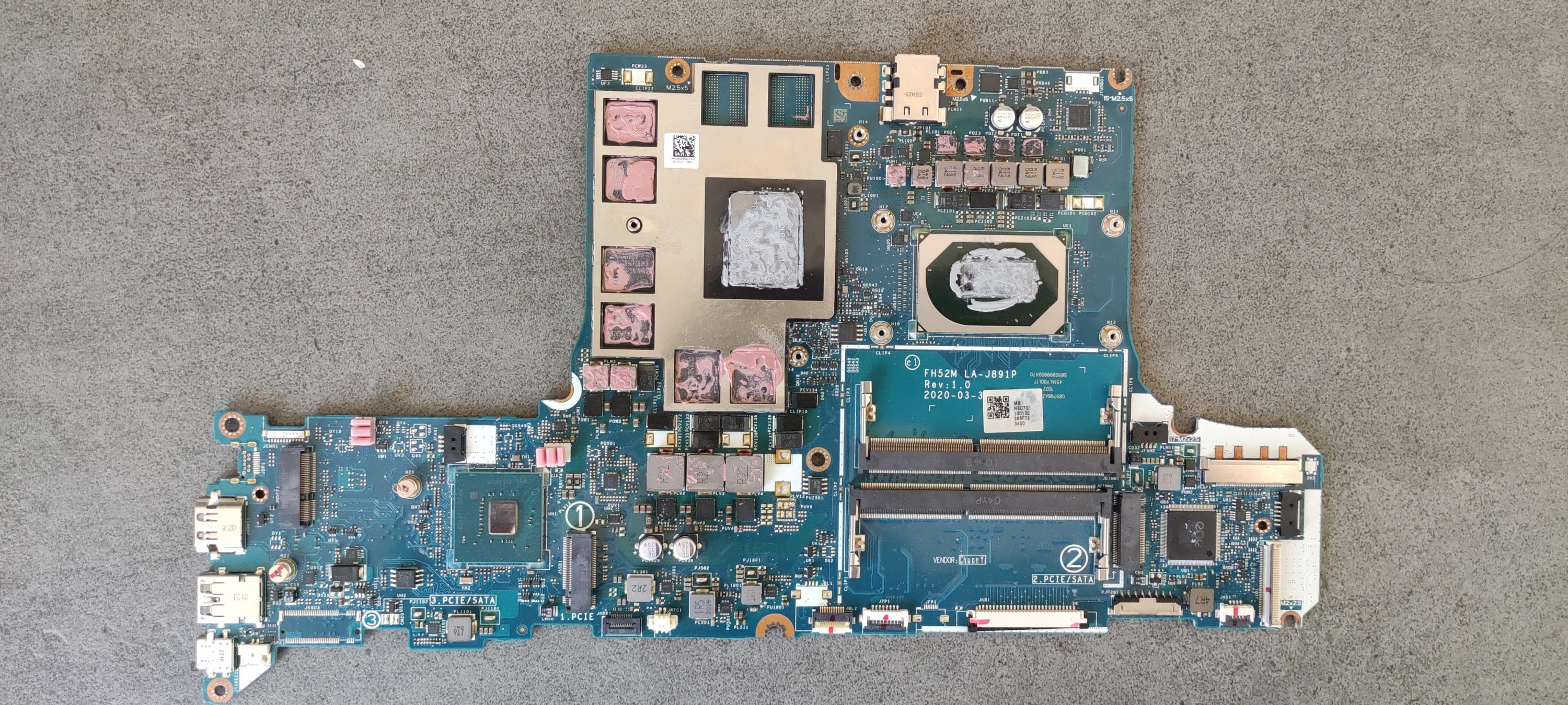

    I'm trying to fix this Acer laptop, main board is FH52M LA-J891P
    The laptop suddenly turned off during normal use and this is the situation:
    -the power supply is working correctly, 19 volts output. But when I connect it to the laptop , no voltage on the charging connector. If I disconnect the charger, no more 19 volts output until I disconnect and reconnect again the the wall plug
    -the positive and the negative of the charging connector are not shorted
    I have a power supply, a multimeter and maybe a short finder, but still no thermal camera(I'm thinking about purchasing one).
    Any suggestion?
    Thanks in advance.

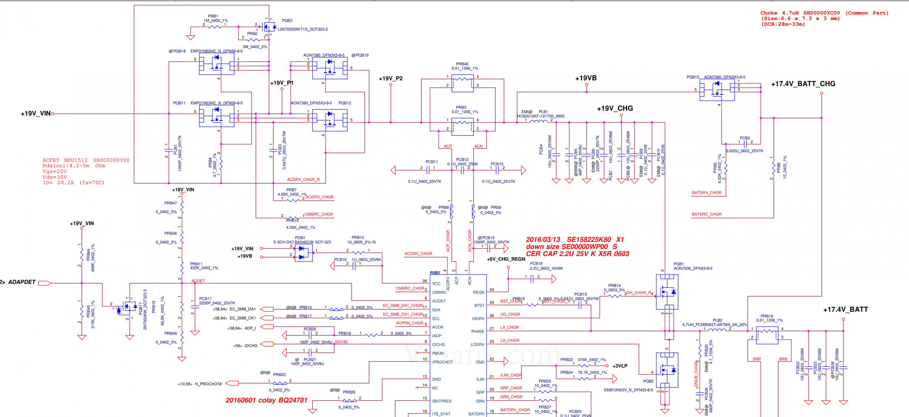

                    Re: Asus Nitro 5 N20C1 dead
                    See attached.
                    Measure the voltage to ground of the DCin mosfets.
                    Source (1-2-3)
                    Gate (4)
                    Drain (5-6-7-8)
                    Only if GATE voltage is ~25 volts will these N-channel mosfets enable.

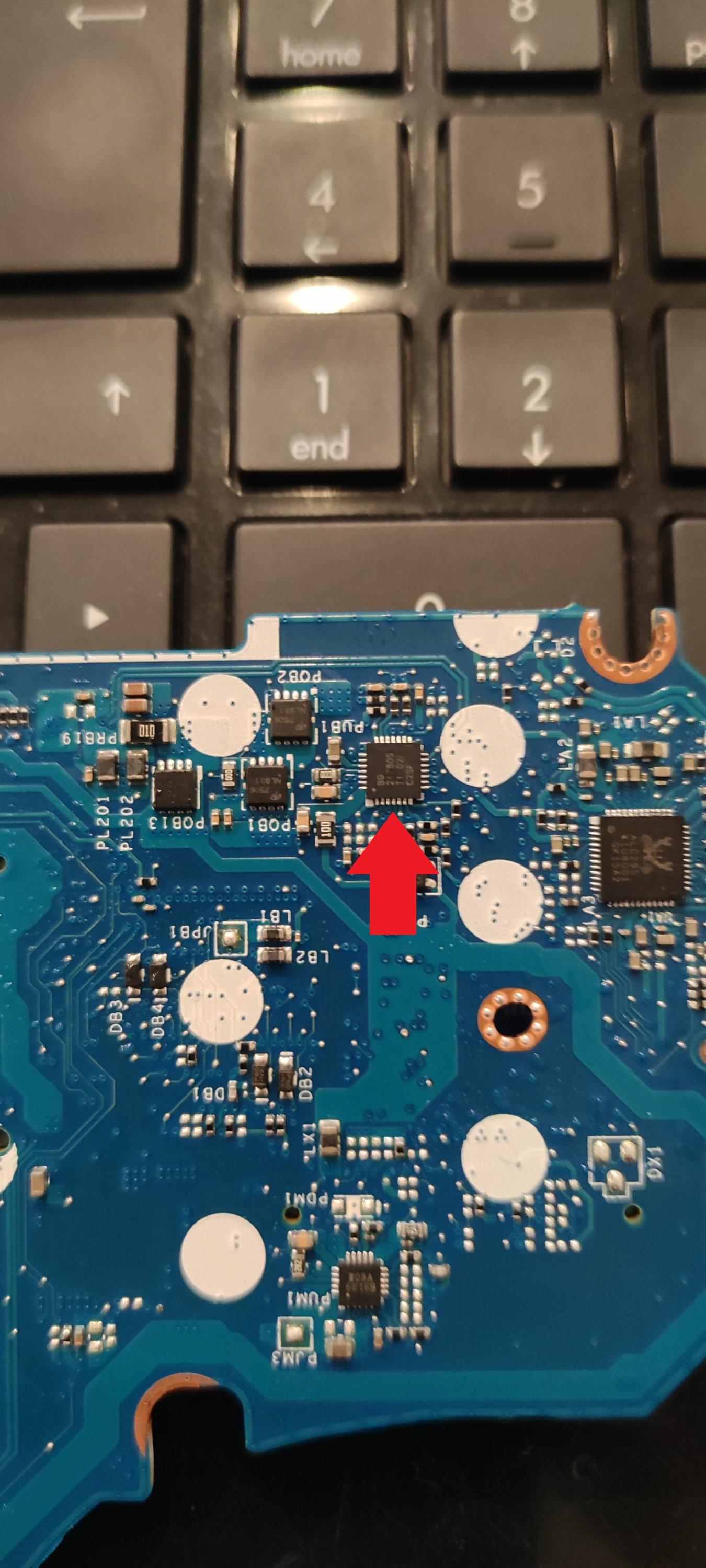

                      during the measurements, I noticed a component becoming very hot: it's the PUB1, BQ 24780S is the name on it.Google search says "SMBus 1-4 cell Buck battery charge controller to support hybrid power boost mode"
                      do you think it is possible that the problem?

                        with charger inserted:
                        PQB11 has 19v on Source, Gate and Drain. Same with PQB12
                        PQB18 and PQB19 are not present in this board (factory empty)
                        PQB1 has 0.14v on source and gate. 0v on drain
                        PQB2 has 0v on source and gate. 0.14 on drain
                        PQB13 has 0.14 on source, 0.07 on gate and 0v on drain.
                        I think I tested all mosfets in the diagram
