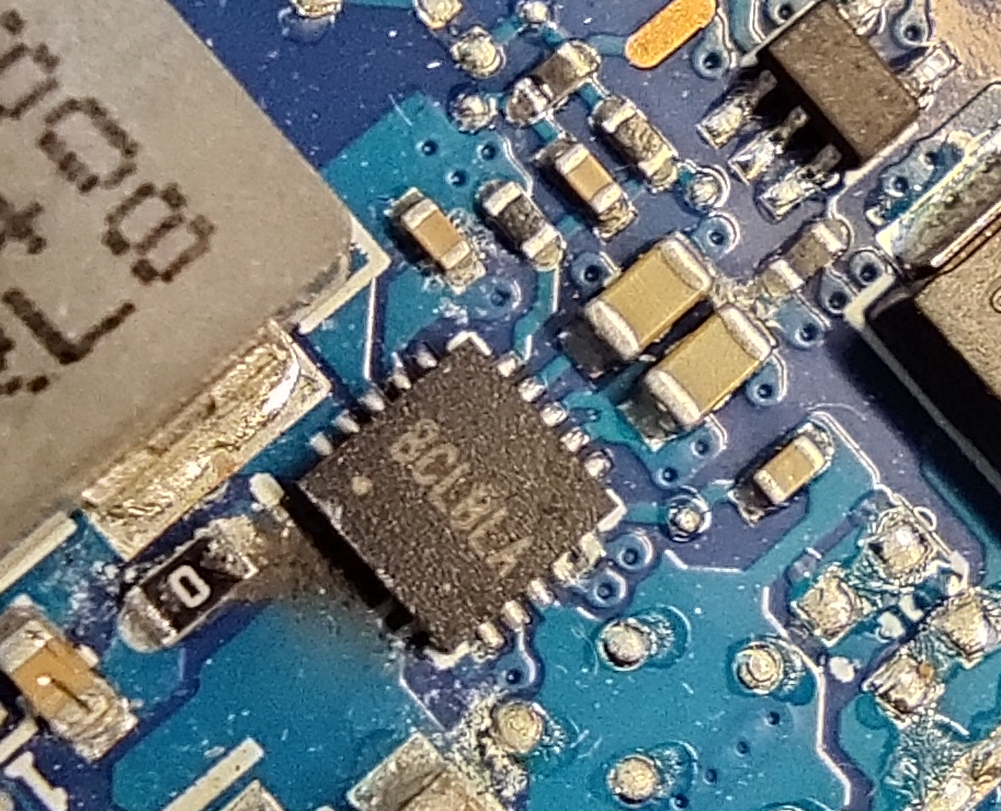

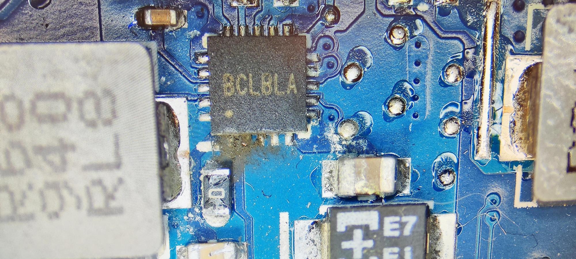

Can someone help me find this Chip for a Asus UX334FL
    Can someone help me find this Chip its for a Asuz mother UX334FL

    Likely a SY8310RAC

        My friend poured water on the computer

          Remove all power (assuming you have done so already).
          Use IPA (alcohol) from your pharmacy to clean up the contacts using a cotton swab (Q-tip).

            Thanks R_J!! I can't find that particular model called BCLBLA do you know where I can get it?

              Thanks but it's already burnt! This happened several months ago, Do you think i can clean it?!

                You can only try. Apply some of your elbow grease with the IPA. Use an old toothbrush.

                  Can run it in the ultrasonic cleaner too
                  but it would be nice to get a wiring diagram/board view for UX334FL MAIN BOARD 2.0 so I can measure a bit as well before I remove all traces of what could be bad?!
                    Or is there a similar one?
                    I've searched like hell but can't find any info on this particular model

                      Only the BCL prefix is important.
                      So BCL*** will work:
                      US $4.64 20%OFF | 1pcs SY8310RAC SY8310 (BCLBPA BCLCLC BCL...) QFN-20
                      https://a.aliexpress.com/_mMQaTRk

                        Ok nice thanks!! So why are they called differently?
                        Just curious so I'll learn for the next time I come across something similar

                          Often, the other markings are manufacturing date codes.
                          That is, the year and the week of the year the part was manufactured.

                            Yes. Just like for Richtek only the first two letters and the following symbol matter. The other two letters are the date code.
