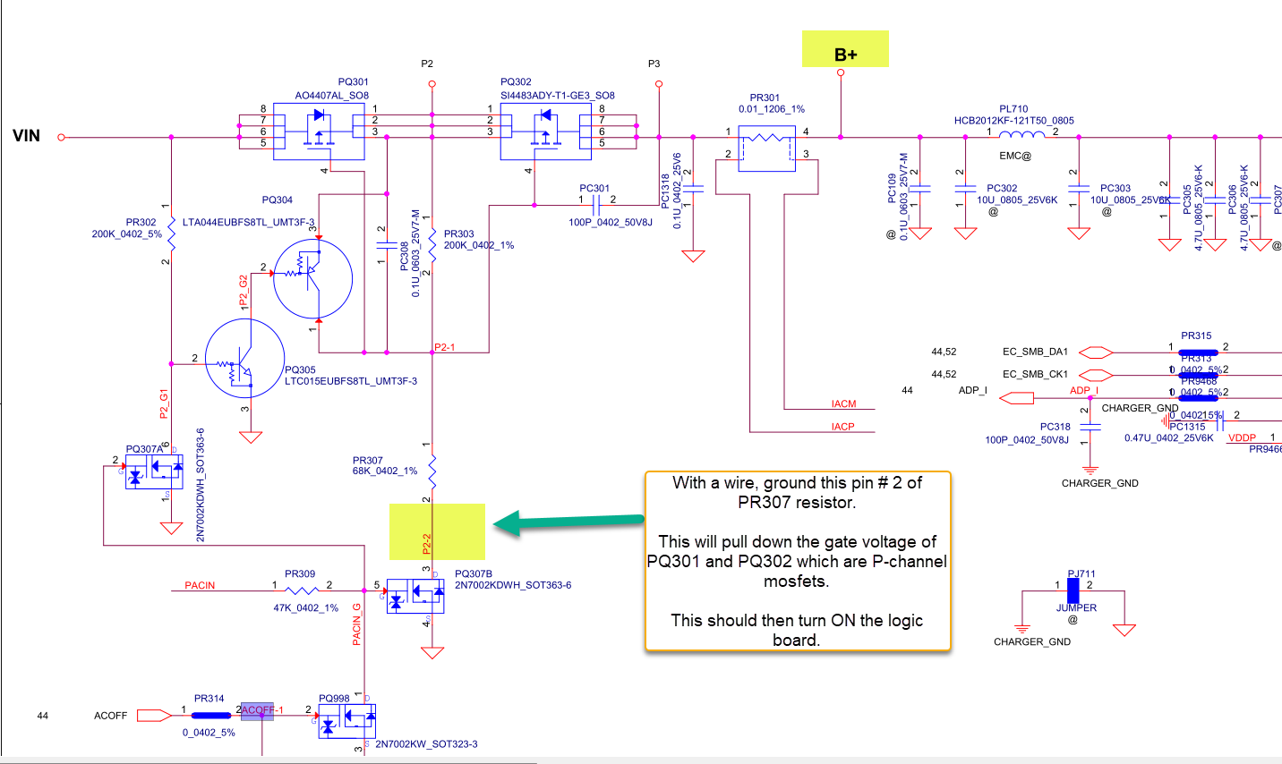

                  Do not worry about PQ39 / PL9 area. Place them back like before. Your CPU does not appear to be shorted.
                  If you are having the logic board being powered on using the adapter, then review the DCin mosfets that power this logic board.
                  See attached. When you apply power -> what is the voltage to ground of B+ ?
                  When the logic board shuts OFF, what is the voltage to ground of B+ ?
                  Then attempt the wire jump to enable the same 2 x DCin mosfets (P-channel).
                  Connect a wire to pin # 2 of PR307 to ground to enable the gate pins of each.

                    Re: Lenovo CG410/CG510 NM-A681 REV 1.0
                    Ifound pq309 6pin but i cannot found PR307 , but i check the first dc in mosfet PQ301 And PQ302 both mosfet source have 20v but gate have 5v only even if turns on and shuts off still stead on 5v

                      Ok. Remove all power. meter in resistance mode.
                      Check if the DCin mosfets are defective by checking their resistance as follows:
                      source (1-2-3) & drain (5-6-7-8) ; one meter probe on source & other probe on drain - any pin inside the brackets is ok - they are shorted together for higher current support
                      source (1-2-3) & gate (4)
                      gate (4) & drain (5-6-7-8)
                      Post each measurement and the meter scale used for the measurement.
                      If any of the measurements shows a low resistance value then the mosfet is defective and must be replaced.
                          PQ301/302 are fine. gate voltage is correct at 5V. They are P channel mosfets,so gate voltage will be lower then source.
