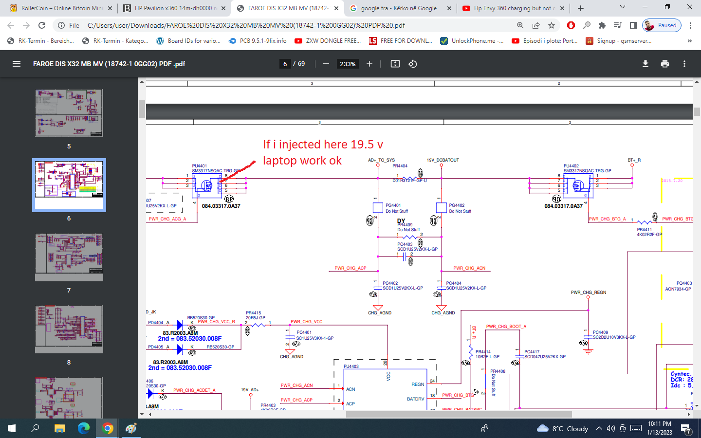

    if i inject in this point laptop turn on

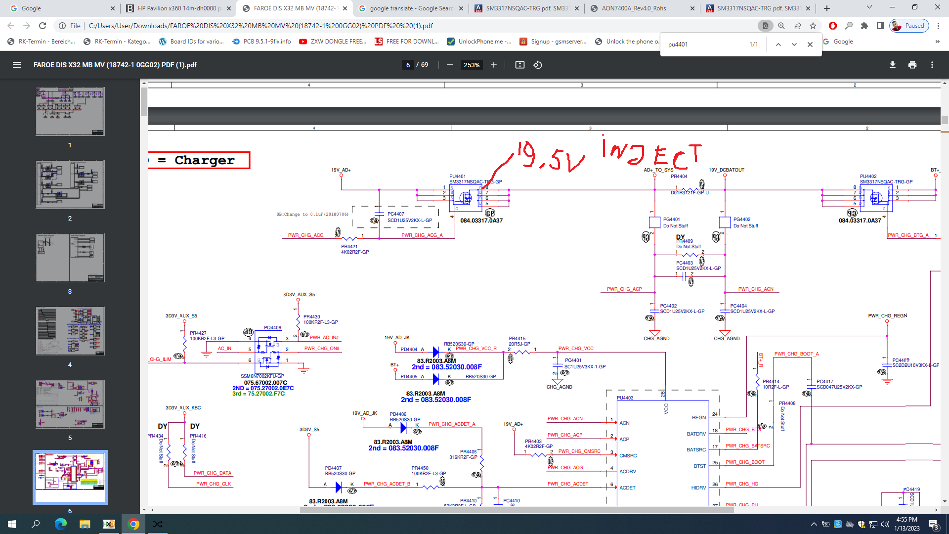

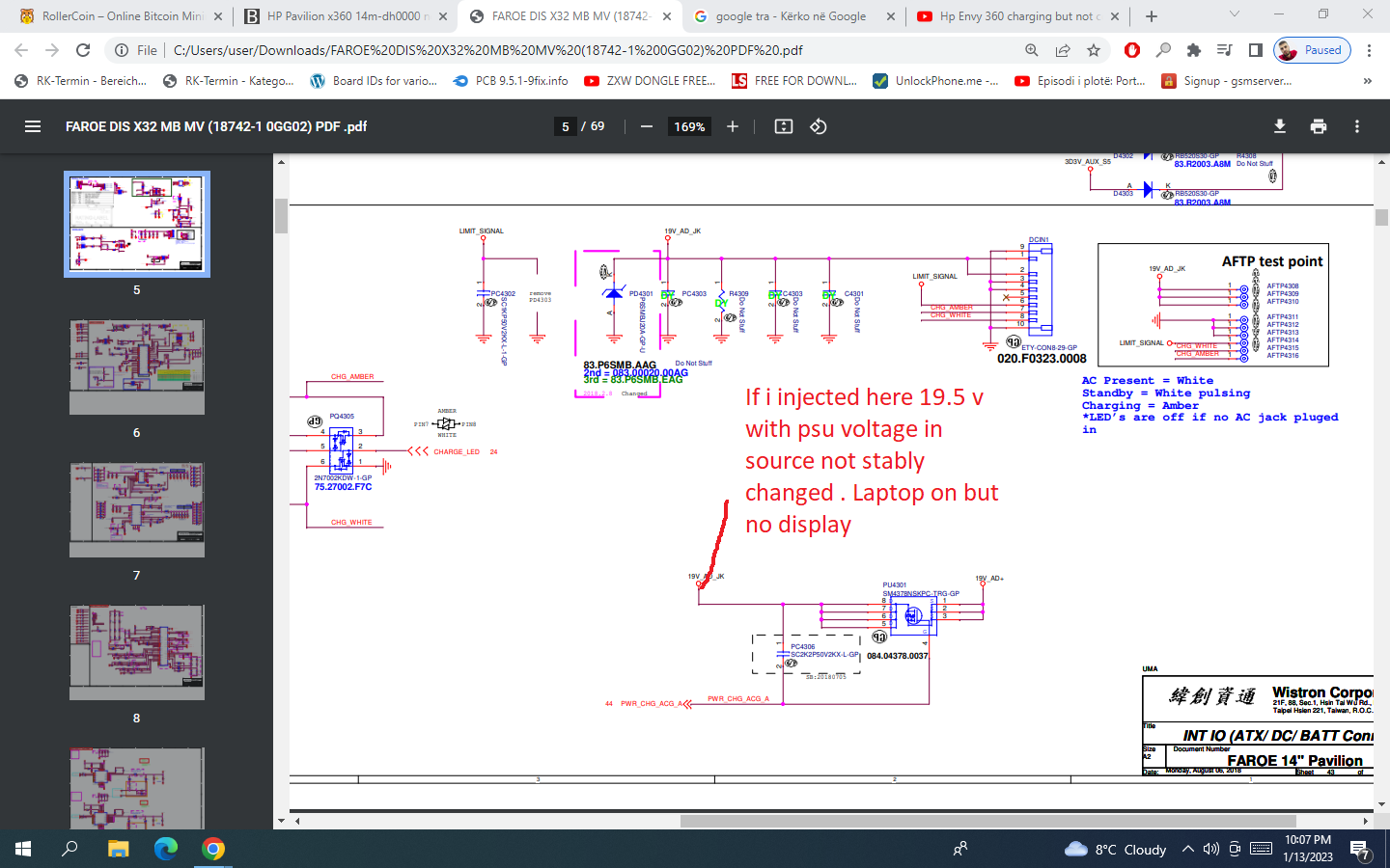

        The laptop turns on and with the charger the LED blinking orange but it does not give a picture and the CPU does not start working. if
        I injected 19.5v in drain pu4401, the laptop turns on, charger light blinking white and the current is 0.2ah or more, the laptop is on open display and no heat anything. I don't understand who lowered my voltage to 19v. I tried changing pu4401 and pu4301 but still no change. even if with charger i jumped voltage not changed No i try 3 charger original hp with 4.7ah

            ok, I will try it tomorrow, I will connect it to the power supply as in the article you sent. But I have tried it with another charger but there is no difference, I have also tried if I inject 19.5 volts with power supply in dc in laptop change voltage and not work. Do you understand what I'm saying?
