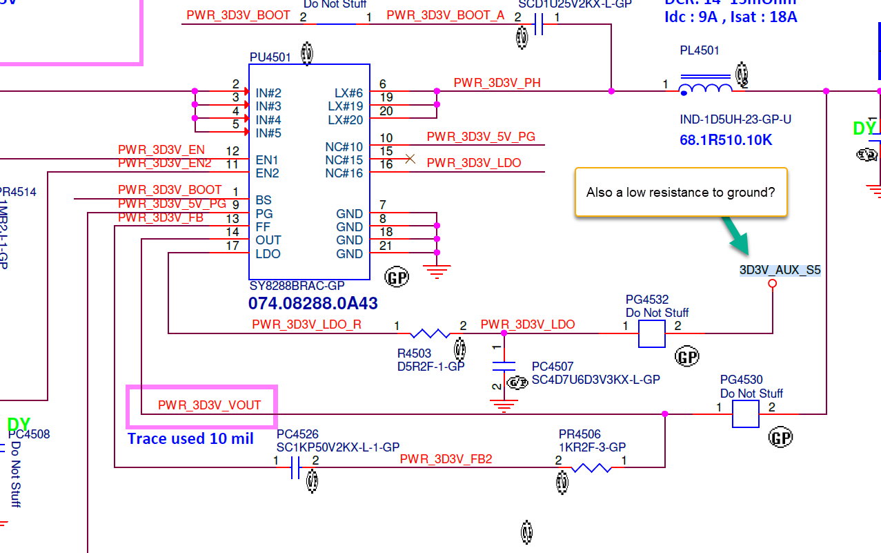

    hello, how are you, I hope you are well. I have a laptop HP Pavilion x360 14m-dh0000 ( FAROE_DIS_X32_MB_MV 18742-1 )
    The laptop does not turn on and the dc jack has no light
    The 19v voltages at the input are fine, there are no shorts.. It shows that the 3.3v voltage is missing. I am also posting the thread if anyone can help me, thank you very much
    This is shcematic [MOD EDIT] LINK to schematic --> https://www.badcaps.net/forum/troubl..._mb_mv-18742-1

    PU4501 in pin2345 i have 19v , pin 1 is 0v
    pin11 0v
    pin12 ov

      Resistance and voltage on pin17 of PU4501?? If you dont have dc jack light,very likely 3V LDO is absent and may be shorted.

        Resistance is 340 ohm . voltage is ov

          Re: HP Pavilion x360 14m-dh0000 no power
          That is considered to be a low resistance for a power rail.
          Remove the resistor at R4503 and then check the resistance to ground again of pin #17 of PU4501.
          Do you have an adjustable power supply? For 1 volt use.

            resistance change after remove resistor R4503 now is 1,1mohm
            yes is have how can i do
                      Remove all power. Configure your adjustable power supply to 1 volt (NOT higher) and 2A-5A current.
                      Apply the red probe of your power supply onto the side with the low resistance; black power supply lead to ground.
                      Search for any part that may be heating up. You are effectively hunting for the shorted part with heat patterns. You can pour IPA (alcohol) and watch which part evaporates / mists up quickly. That part will be shorted and needs to be removed. Hope that the part is a cap which is very common.
                      Once you find this part, remove it and check the resistance to ground again. Is the resistance higher now with the shorted part removed ?
                      Then test again if the 3v3 LDO rail returns to normal operation.

                            No - for safety, we do not want to use a higher voltage. This is in case, there is a leaky mosfet downstream and that higher voltage from your power supply will kill your CPU.
                            Best to invest into a quality adjustable power supply for this servicing. Aliexpress has many but the Chinese New Year holiday just started so most are on vacation till the end of the month.
                            Do you have Amazon service in your region? They may have such power supplies.
                            See attached. Can you confirm if there is a low resistance to ground at 3DV3_AUX_S5 ?
                            The concern is to locate the shorted part that travel across many parts of your logic board. The part with the lowest resistance should heat up under this injection test.
                            This LDO rail appears to be powering the KBC controller.
                              yes is 0.8 k ohm
                              i find shorts . Shorts is ED4302 . Now light pulsed orange not stay stably

                                  i find shorts . Shorts is ED4302 . i remove tis and now light pulsed orange not stay stably
                                  pin 17 is 18,5 k ohm

                                    Very good. What is the voltage to ground on pin #17 LDO pin ?
                                    You injected voltage and this part was heating up?

                                      voltage in pin 17 is 3,2 volt but change going 2,5 and not stably .. yes first in board heat D4301 i remove in pin diode i inject 2 volt and i find Ed 4302 is to hot

                                        Check if the removed diode @ D4301 is defective.
                                        Meter in diode mode, check if the diode conducts in one direction with your meter and should block in the other direction. Need to understand why the diode was heating up.
                                        Also, where is 'Ed 4302'? Is if 'PD4302' ?
