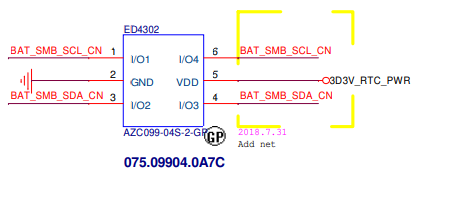

    Originally posted by mon2
    Check if the removed diode @ D4301 is defective.
    Meter in diode mode, check if the diode conducts in one direction with your meter and should block in the other direction. Need to understand why the diode was heating up.
    Also, where is 'Ed 4302'? Is if 'PD4302' ?
    diode is ok i measure not shorts and in multimeter is ok . Now after i removet ED 4302 diode not heat
    this is ED4302 is near battery

      Got it - thanks. That is an ESD diode array.
      To confirm, if D4301 is REMOVED, then ED4302 is not heating up?
      But diode D4301 measure to be ok on your work table?
      In diode mode, it should conduct in one direction with readings like 0.4 to 0.6 but OL in the opposite direction. Can you confirm it?
