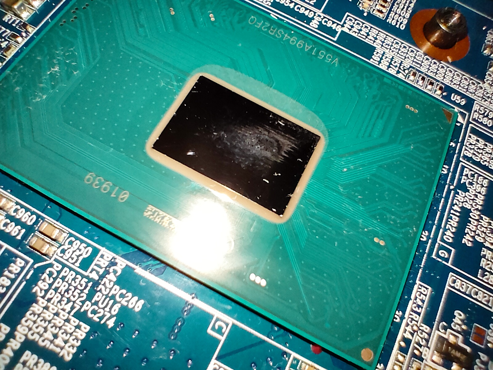

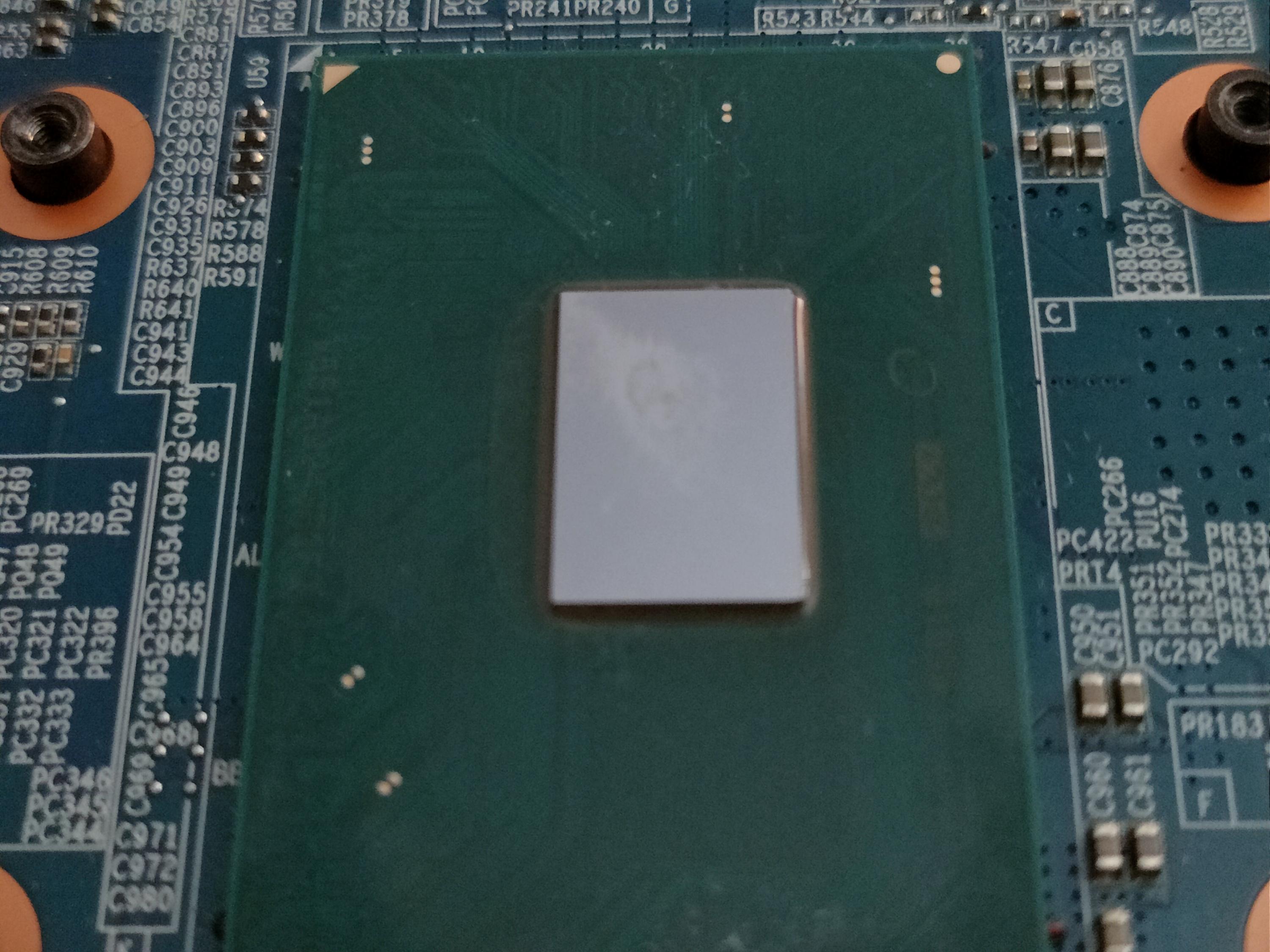

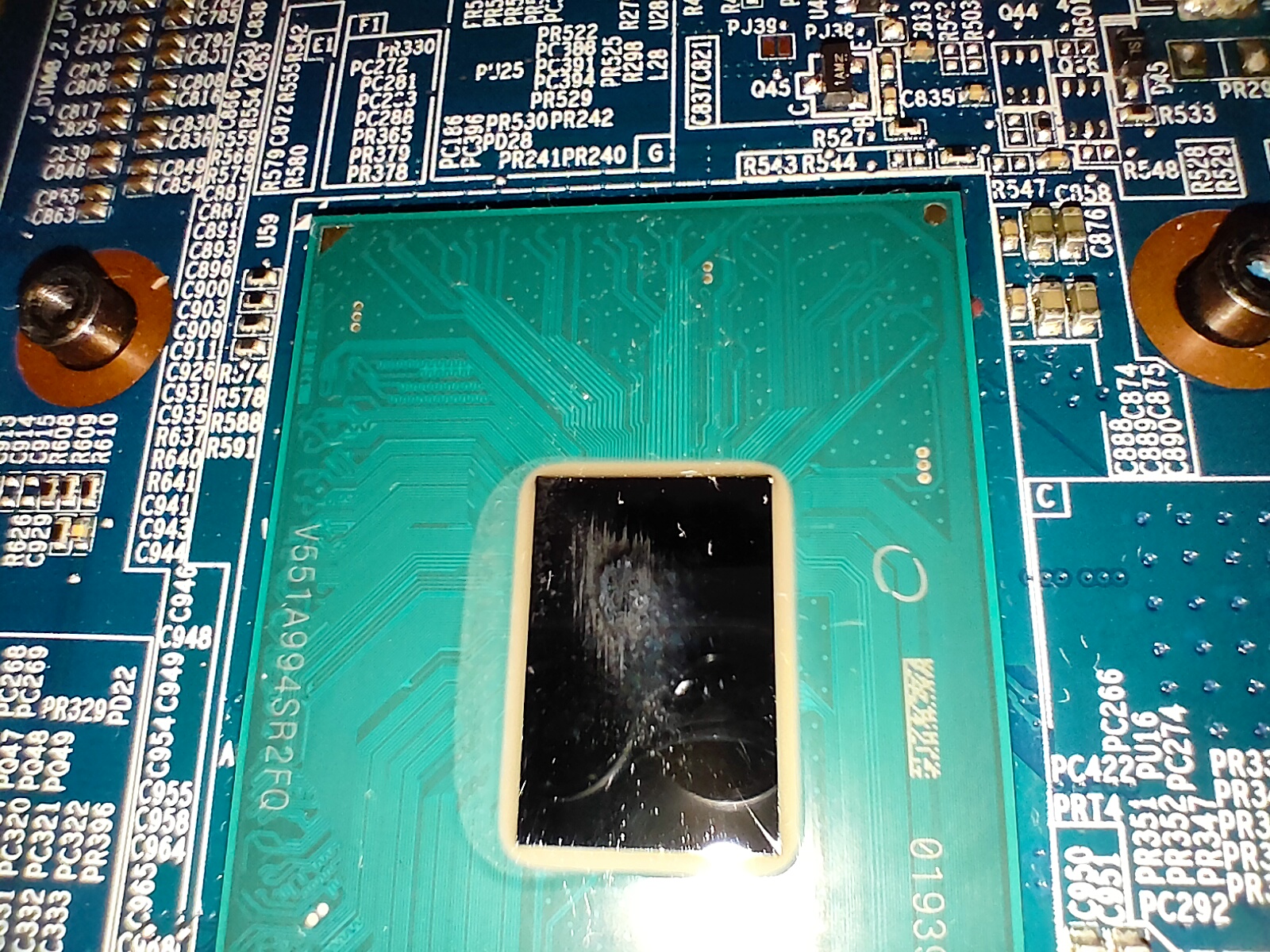

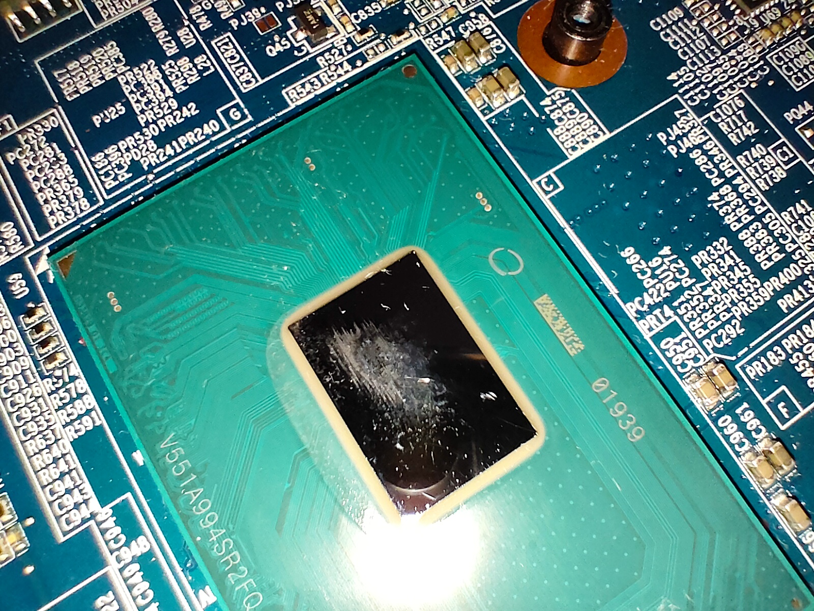

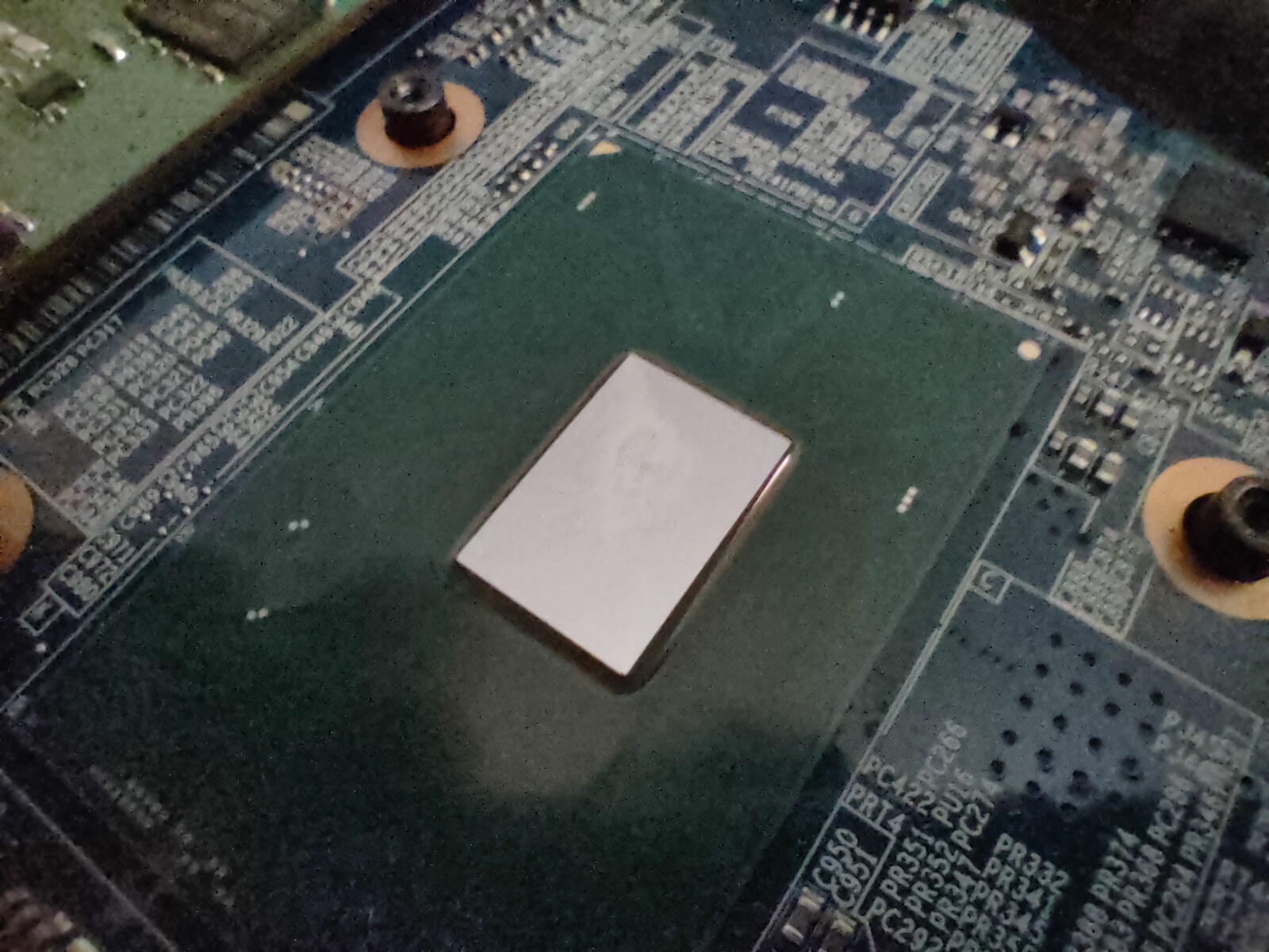

    I have this Clevo laptop which is not booting when two RAM modules are inserted in dual-channel configuration.
    I think that channel B is defective.
    Can this be caused by the CPU? I ask this because there is a very visible discoloration in the CPU die. I can even spot with the naked eye, what looks to be straight lines, like tiny cracks in this spot. I notice this when replacing the thermal paste.
    The laptop works fine with the ram configuration as single.
    I don't have any experience with ram detection defects. Any hints on what to check?
    Thank you.

    I have many suggestions and questions :
    1 - Are all the SO-DIMM memory modules installed in the system identical (the same size and brand) in order to prevent unexpected system behavior. ?
    2- Did you try a single configuration on Channel B only ?
    3 - Did you update the Bios rom to the Latest version ?
    4 - What is the operating system installed ?
    If you're using a windows 10 32 Bit , it won't see more than 4GB . Although some older laptops can boot with such real memory difference , it won't be the same in systems capable of 64GB , like yours .Similar problems can occur with other operating systems .
    5 - Can you put a high resolution clear picture of the cracked die ?
    6 - It may not be the die as well , since if the coolers fixating managed to crack it , it could have cracked some lines . If so , well ......
    7 - Since it's not mentioned in the manual , Check in the Bios Settings , if there's "Memory advanced settings" . If there is , choose the right configuration .
      It's not "cracked" but I do see discoloration. I'll disassemble it again later and show you.
      A: I don't think its cracked by pressure or a drop. I think it was due to high temperature.
      7 - Since it's not mentioned in the manual , Check in the Bios Settings , if there's "Memory advanced settings" . If there is , choose the right configuration.
      A: there are some memory customization parameters like timers but none that could affect this behavior. The laptop is booting fine with slots 0 and 2 filled with 8GB memory sticks.

        Q : It's not "cracked" but I do see discoloration. I'll disassemble it again later and show you.
        It's now critical to see the die ..
