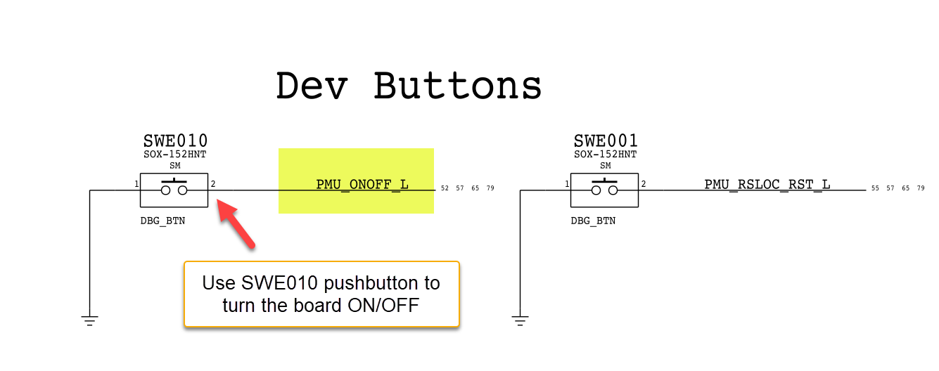

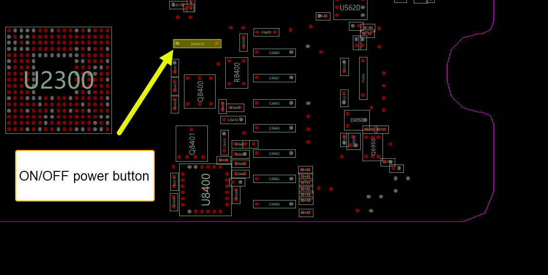

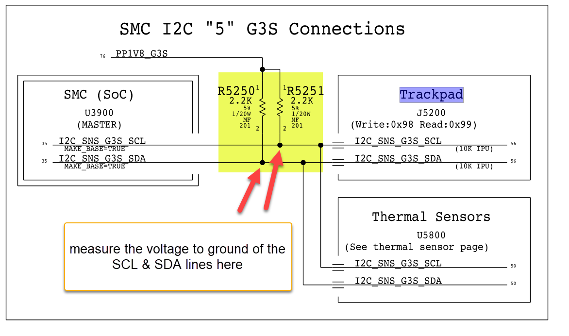

                    Disconnect the trackpad and keyboard. Use the power button @ SWE010 on the logic board to turn the board ON / OFF.
                    Test again without the trackpad / keyboard. Perhaps the I2C / SMBUS interface lines are being strapped down and causing this recyling of the power.

                      Re: MBA 820-01521 - keeps restarting
                      Voltage is 1.8V on both resistors but voltage drops to 0V like PP5V_G3S.
                      I have tried to turn on/off with SWE010. Current to the MBA was higher up to 0.45A. Stable current from adapter is about 0.2A. Firstly the second spin was longer about 2sec and fan went to very high speed and then it turned off.

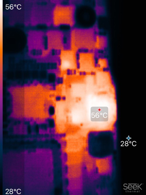

                          I have tried to use thermal cam with battery connected and there is one hot area at its L7030. Its about 53C immediately.
                            There is the photo. It is only when battery is pluged in. This place was water damaged. It does not looks so nice but all caps around this is good.
                            With battery it drains up to 1.5A.
                            btw: PPBUS_G3H drops same like PP5V_G3S for few seconds.
