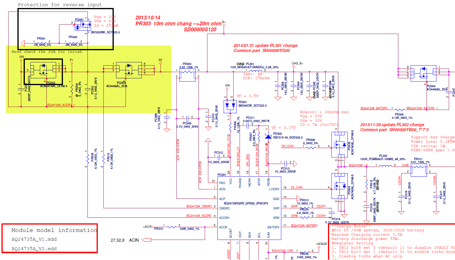

    hi everyone
    laptop acer aspire e1 572
    motherboard Z6WAH LA-C671P REV1.0
    cercuit charge BQ24735RGRR
    VCC IS OK 19V
    REGN IS 6V
    ACDRV 0V
    ACOK 0V
    ACDET 2.5V

          Re: acer aspire e1 572 no power
          Remove the 4k resistor PR309 on ACDRV and power up again. Test the voltage of ACDRV to see if it is now ~25v.
          Often the 2nd DCin mosfet gets damaged.
          Post your updates.
            Post your updates.
            remove pr309 but 0 volt ACDRV
              where is Where is the problem? I tried to put a wire between drain and source. Voltages 3 and 5 appeared, but the computer did not work.
                Do not bypass such voltages till more research is performed on the logic board. If there is a leaking mosfet downstream from this main B+ rail, then the CPU can / maybe killed.
                You need to have ACDRV working properly on its own to move forward.
                See attached. Remove the jumper you have applied. With the adapter connected, what are the voltage readings on the first DCin mosfet?
                Source / Gate / Drain. Still leave the 4k resistor on ACDRV OFF the logic board.
                  Thank you. I made a mistake in the measurement. I don't know. It happened until I found the 3.3 volt coil. It gives a resistance of 55 ohms. Before, it used to give a decrease in kilo ohms. When injecting, I removed the coil and injected it with 3.3 volts. It turned out that I found heat in the processor.
                  Thank you for the help I benefited from your expertise
