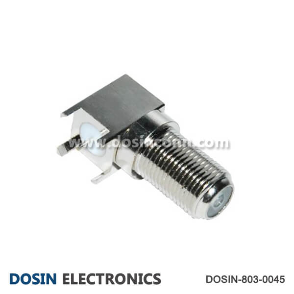

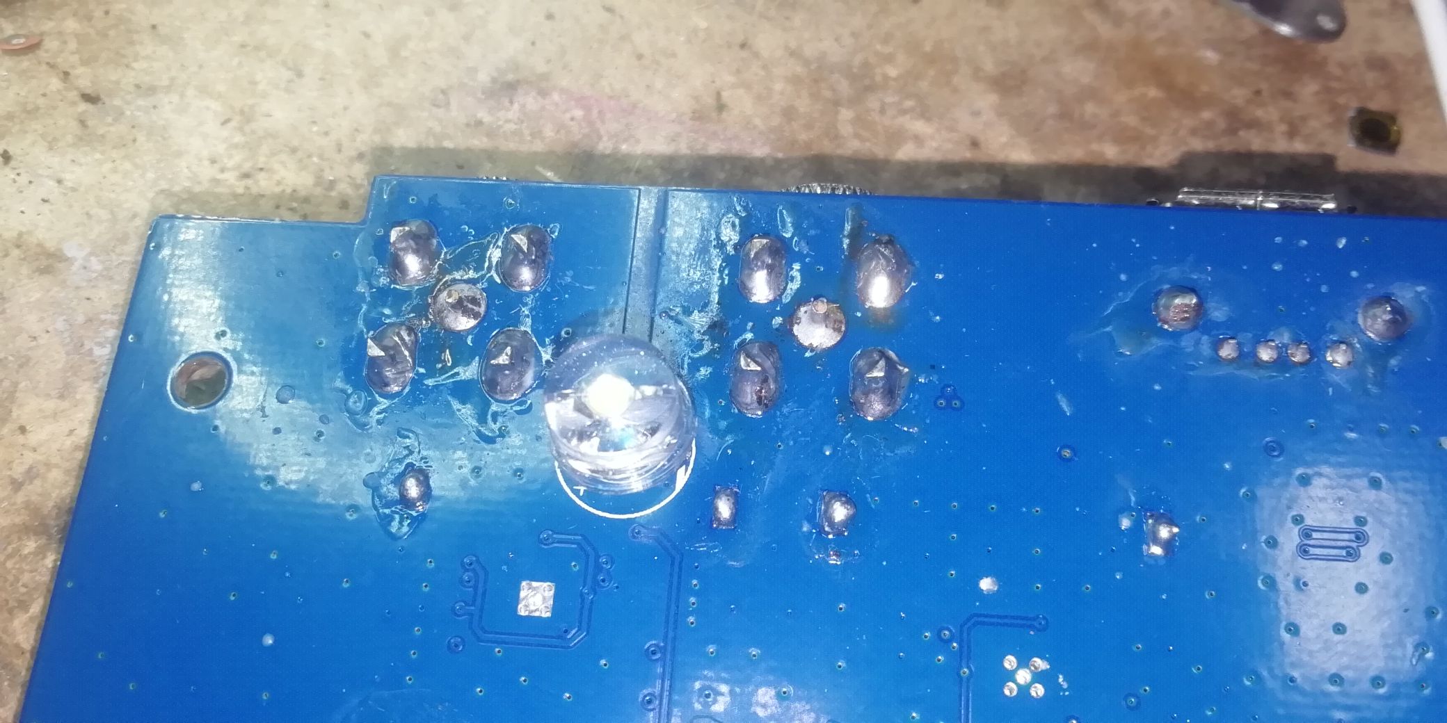

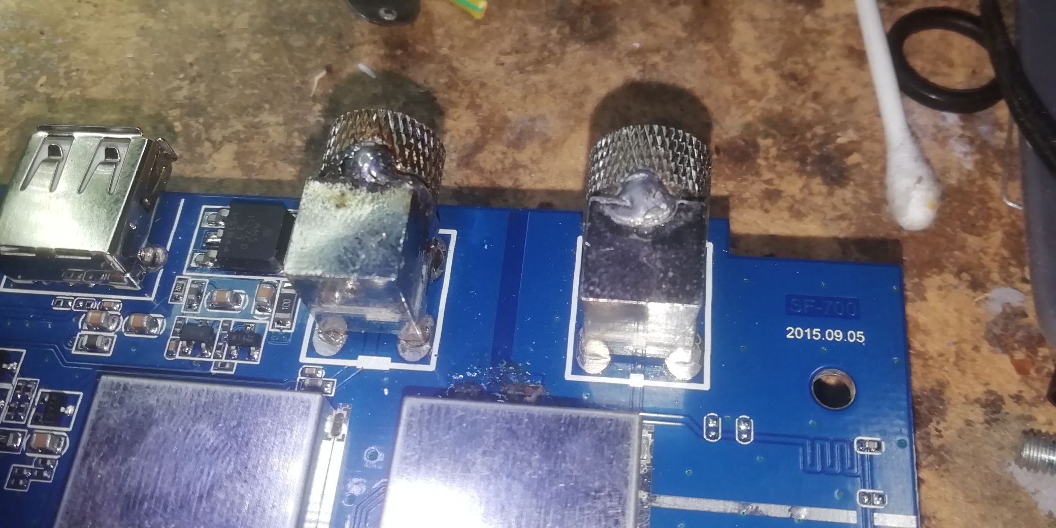

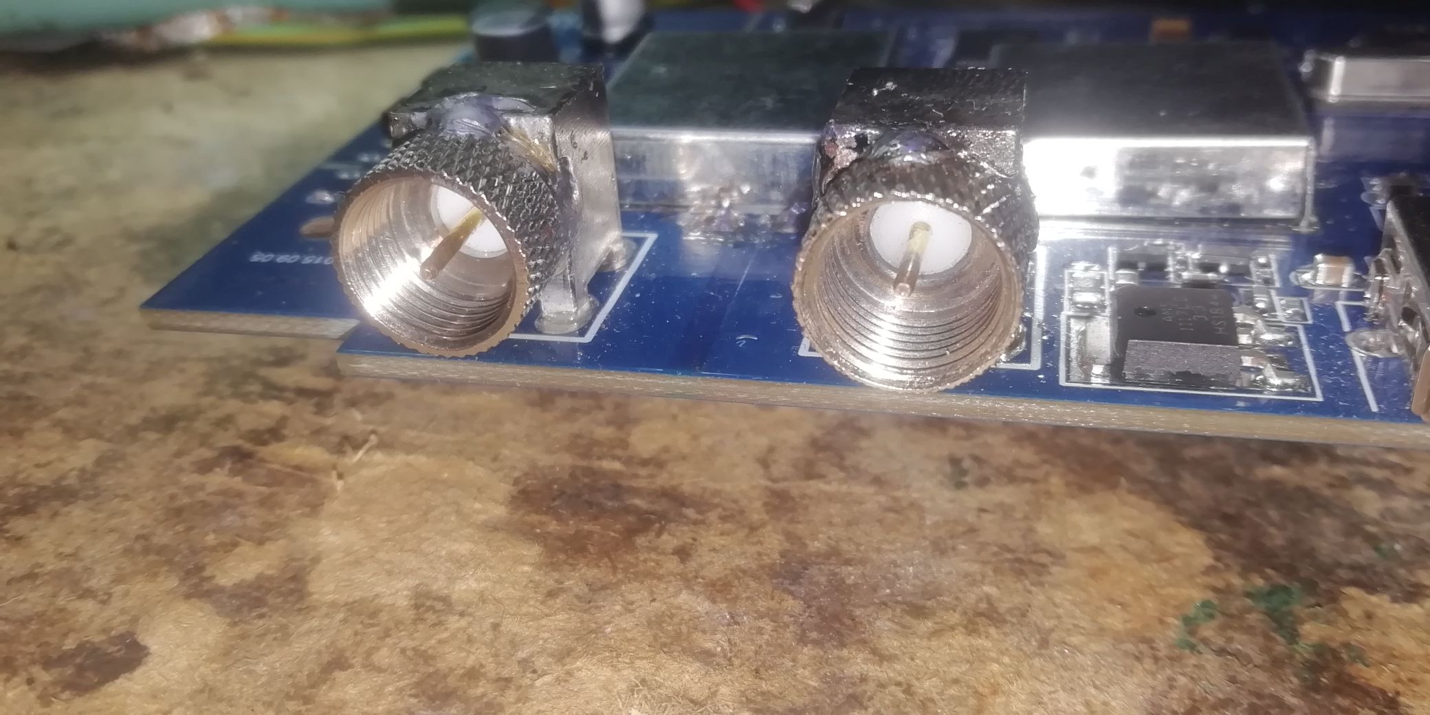

What type of connector is this ? Satellite meter.
  • diif
    • Feb 2014
    • 6978
    • England
    I've not worked on any type of stuff that uses these connectors before so I'm unsure what they are. A type of RF but they seem to have ohm values attached to some.
    The outer threaded piece has been soldered on before but I'd like to replace the connector.
    • 31296
    Re: What type of connector is this ? Satellite meter.
    it's an "F" connector
    never seen a pcb mounted plug before though
    • R_J
      • Jun 2012
      • 9627
      It likely had two of these type f connectors before
      • diif
        • Feb 2014
        • 6978
        • England
        Thank you stj, I've been able to locate what I need on Ali.
        It's on some test gear for measuring signal strength and quality.
