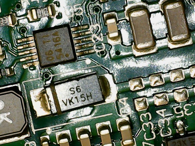

    Honeywell Home RCHT8610WF2006 Thermostat - No Power
    Can anyone help me identify this diode? S6 VK15H is all that's on the package.
    I couldn't find any good results in my searching.

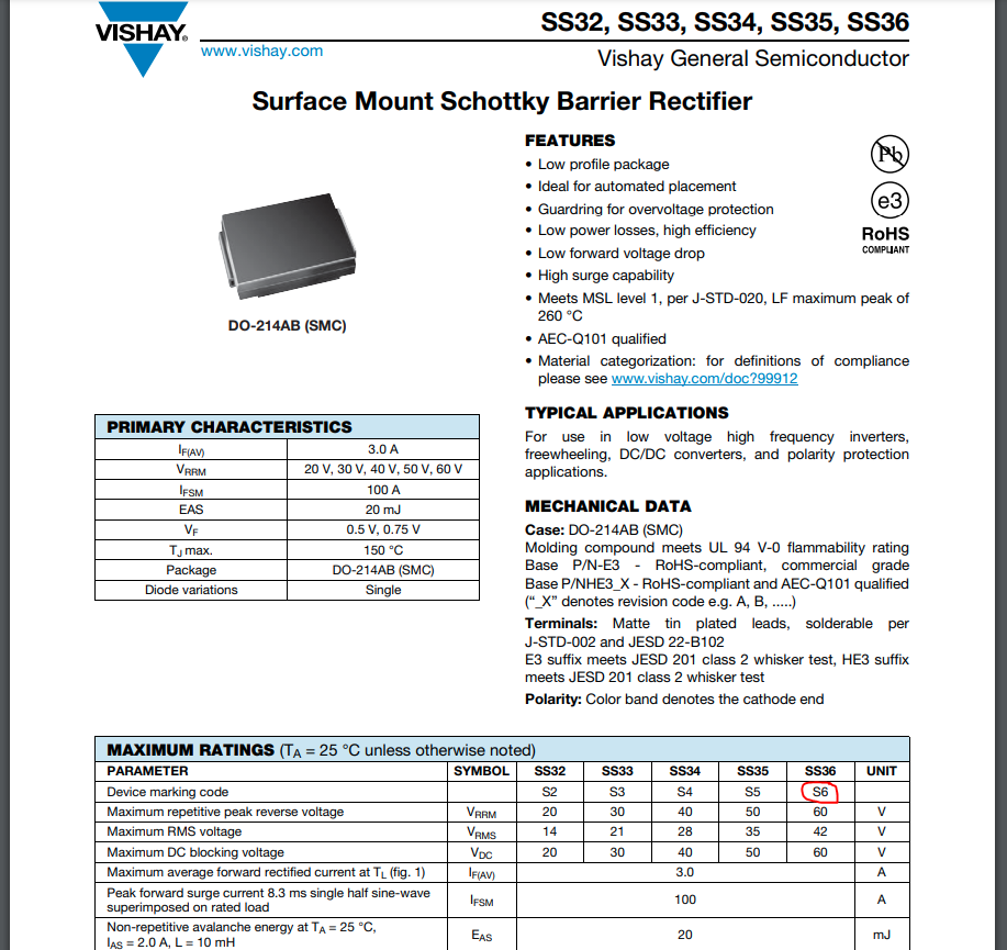

    Re: Honeywell Home RCHT8610WF2006 Thermostat - No Power
    S6 - SS36 (Surface Mount Schottky Barrier Rectifier) 60V 3A.
      Awesome! Thanks for the identification! I replaced the component and my furnace is back in business.
