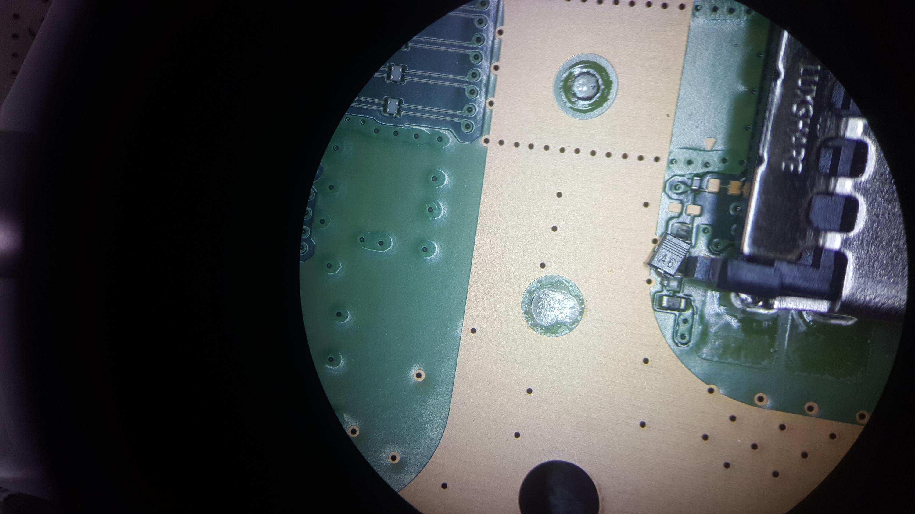

    Playstation 5 Diode Component ID
    Do anyone have any idea of the value and type of Diode this is? Its from a PS5. If the port pushes out of the back it rips these off the board.
  • CapLeaker
    Leaking Member
    • Dec 2014
    • 8352
    Re: Playstation 5 Diode Component ID
    BAS216 in a SOD110 package? bend the legs straight and put her back on.
