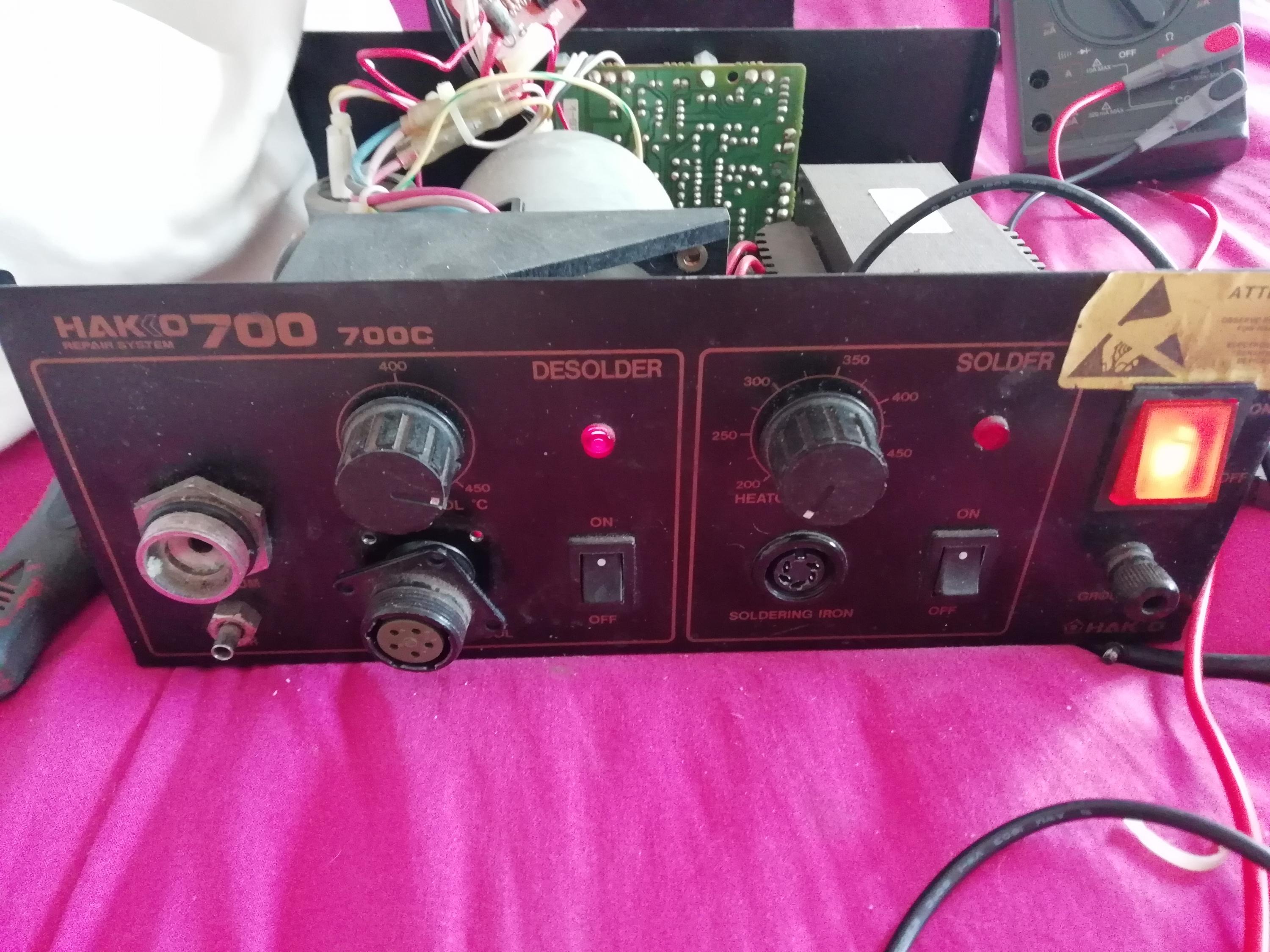

    Hi all new here great forum !
    Ok so my issue is slightly different to the norm probably .
    I have a Hakko 900c soldering station with a iron and a desoldering gun , the gun is completely destroyed which is a shame , however someone gave me a gun from a duratool ZD-915 and ZD-917 machine which is very similar looking , not as durable I dont think as the old Hakko but my question is , would it work and how should I go about wiring it ? I no longer have the Hakko one for a reference which I`m kicking myself about so thats a pain . The Cheapo one has 6 pins and the hakko has 5 so I`m thinking thats a non starter there but I thought I would ask the experts in here how to go about trying to make it work . I would LOVE to have it running again , when it was working (about 10 years ago) it was fantastic. They are both 24v I believe (the iron and the new gun are , I havent checked the v`s yet)
    TIA

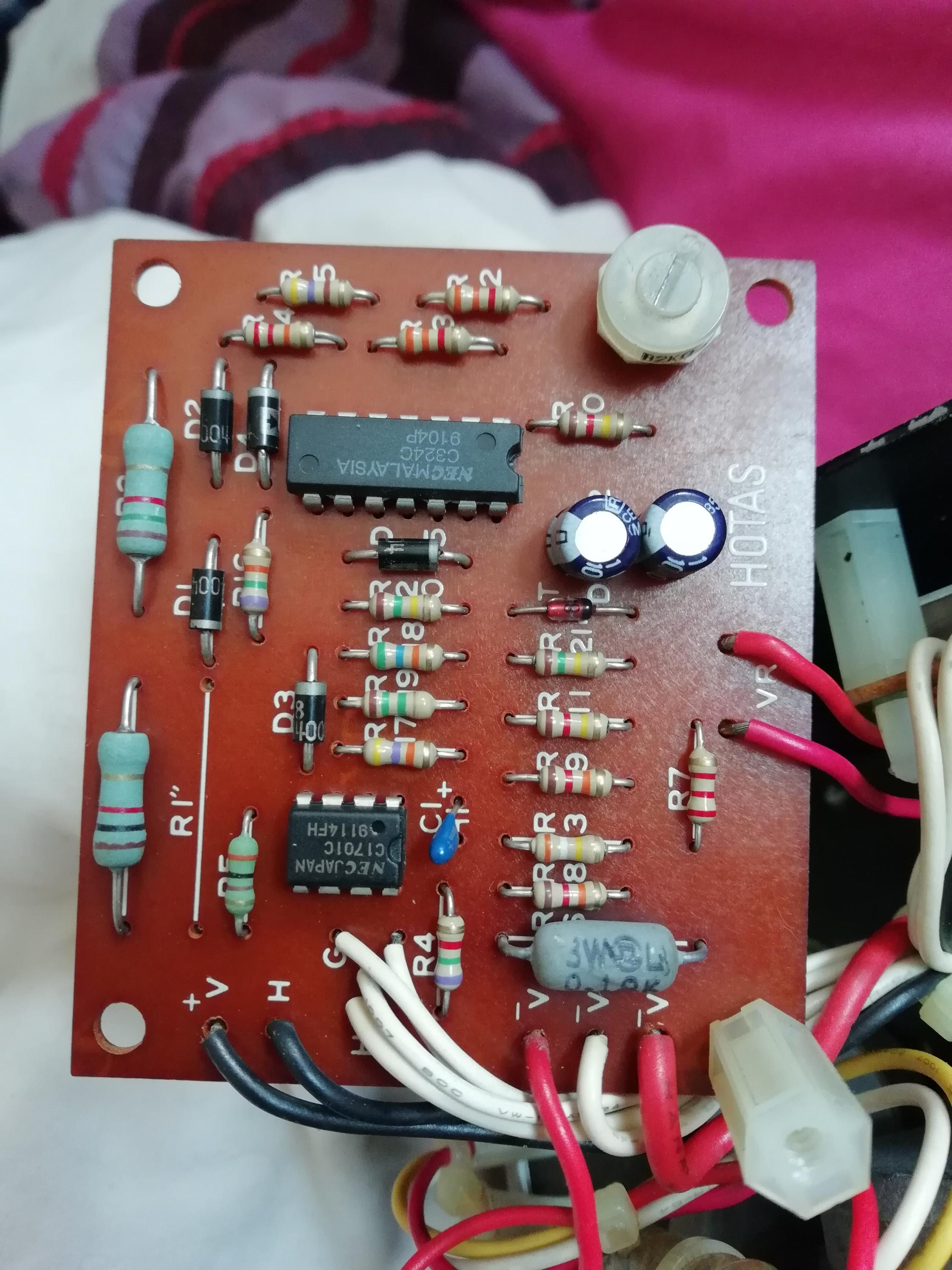

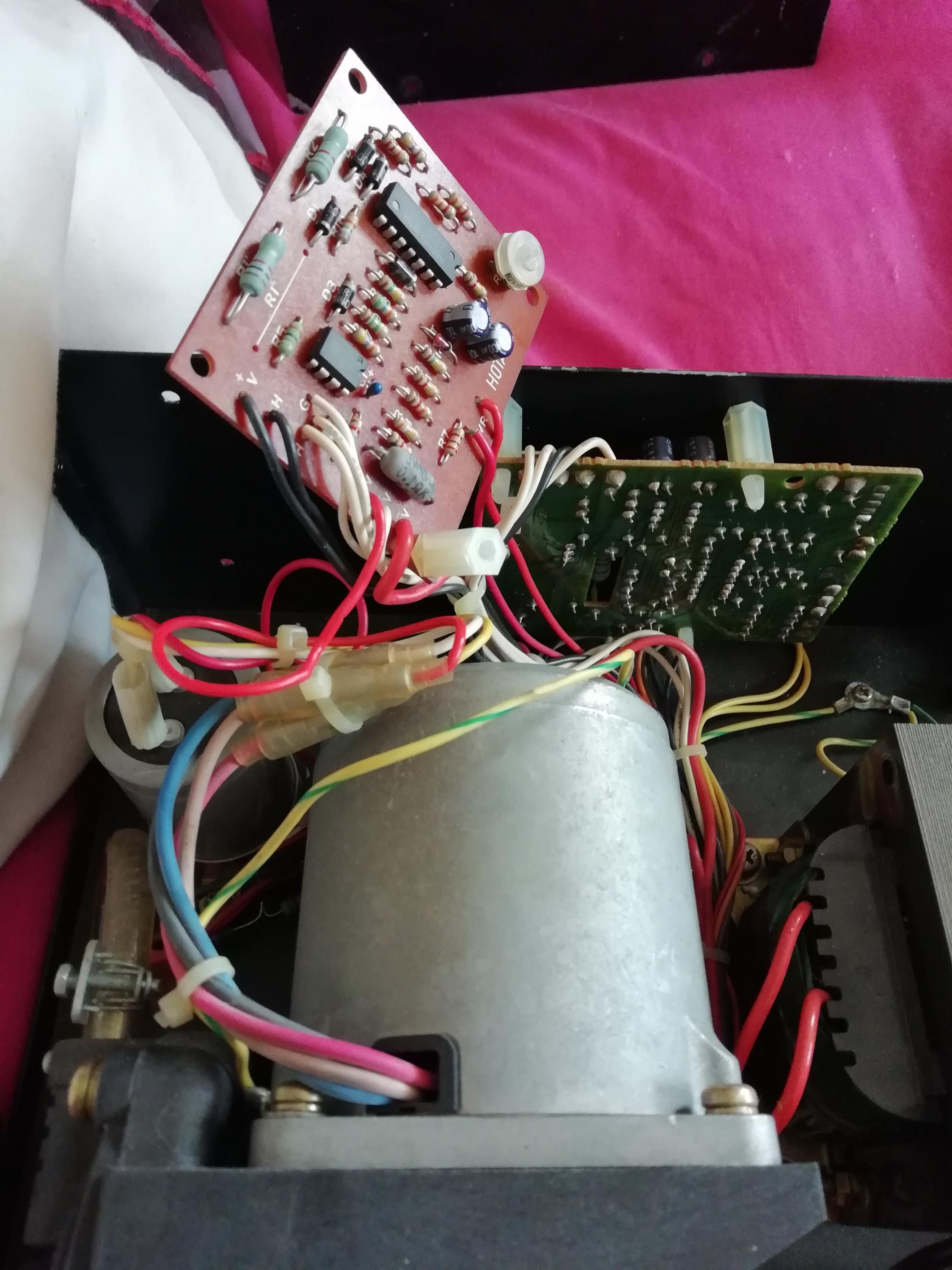

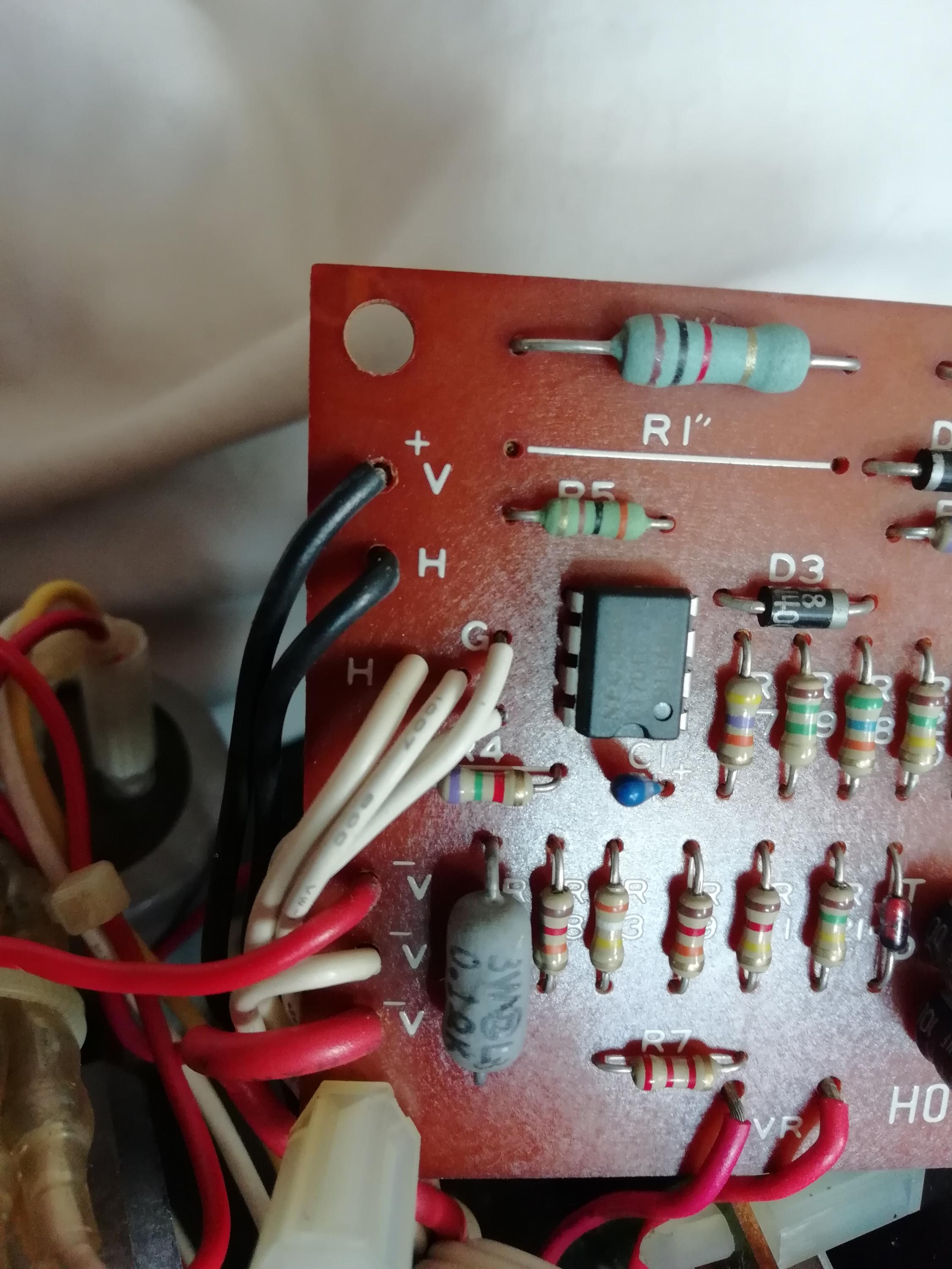

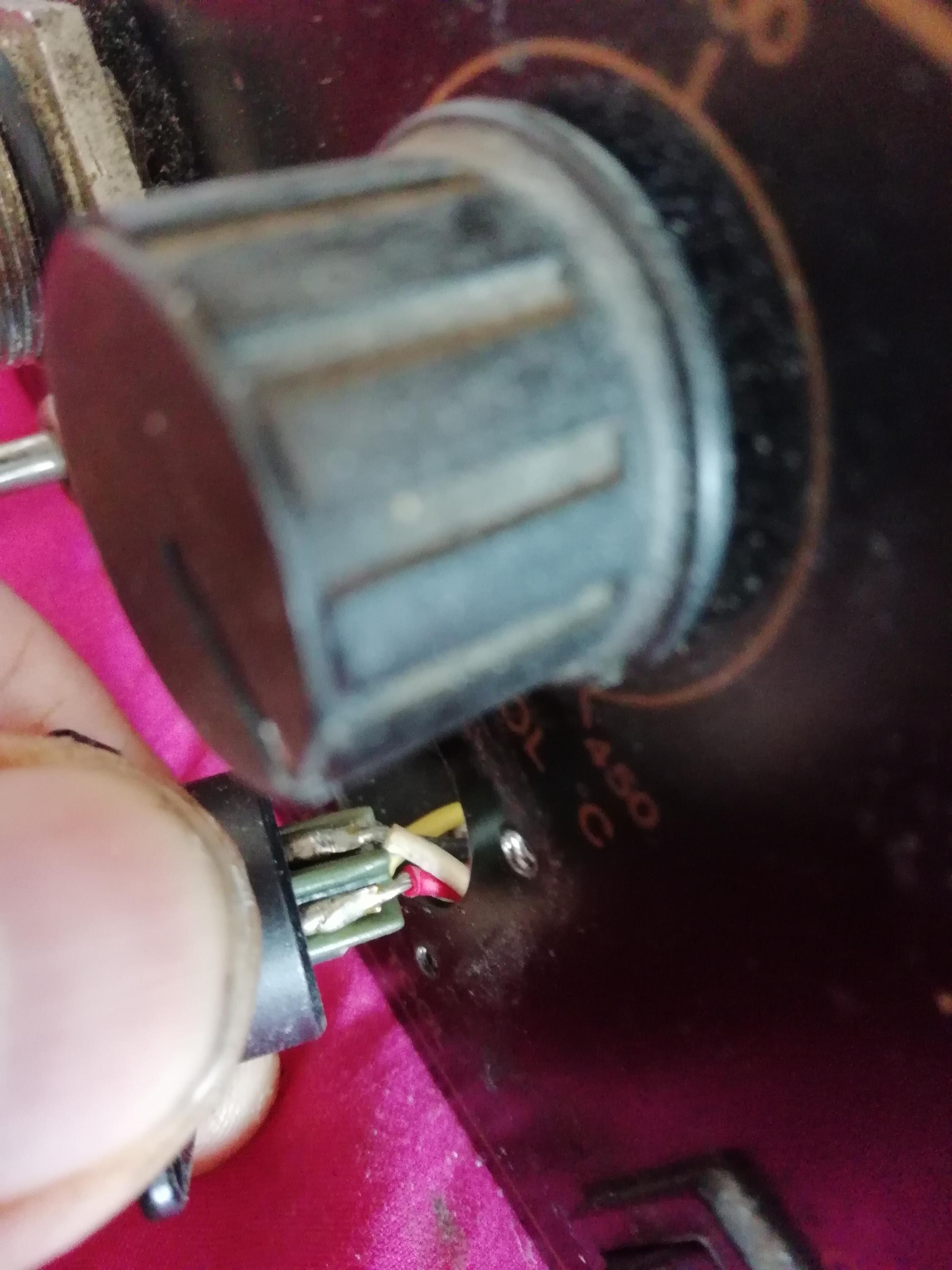

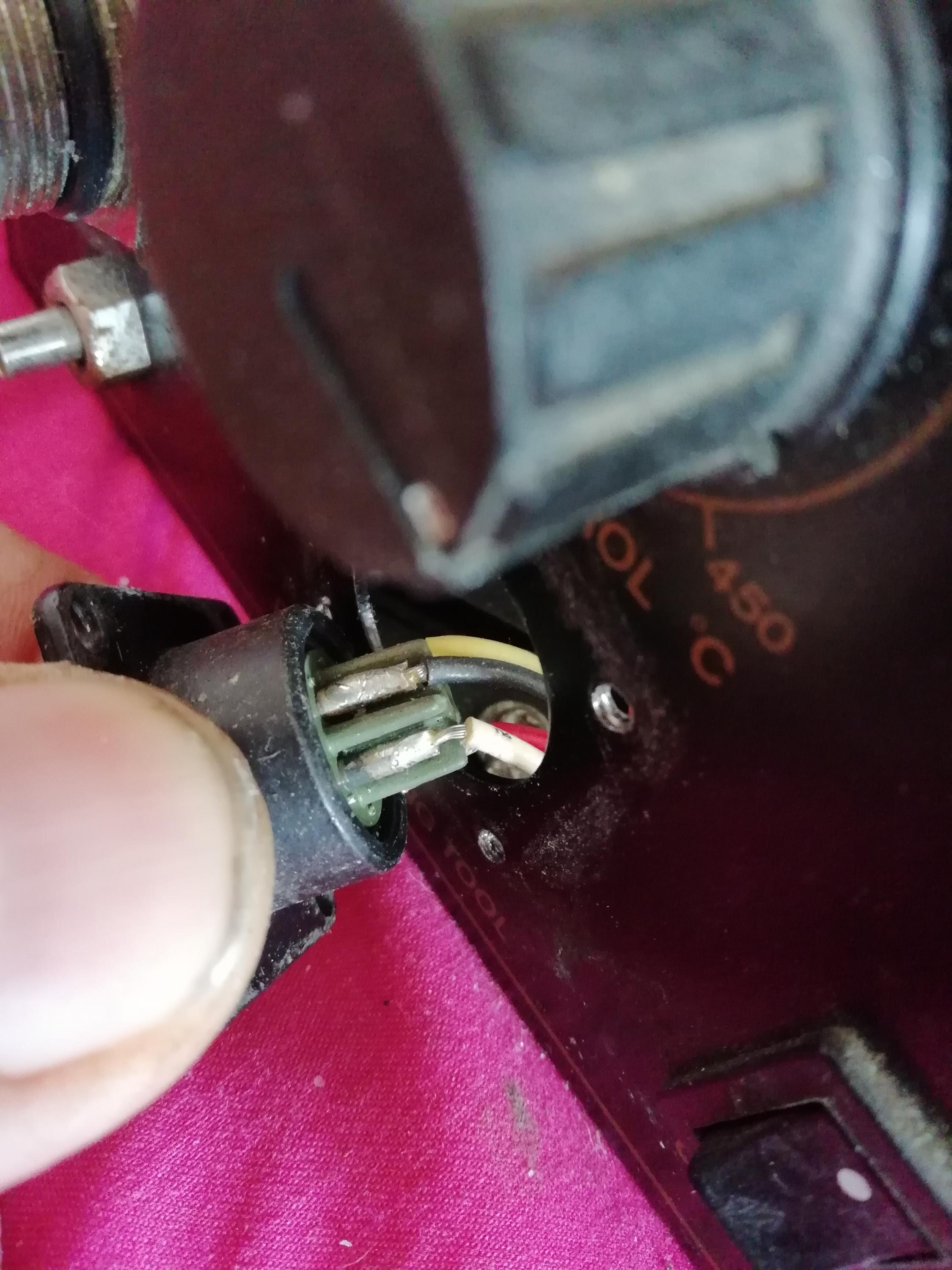

                          • RepairNewbie47
                            • Jun 2018
                            • 18
                            • United Kingdom
                            Re: Hakko desoldering gun help
                            OK so , here`s what we have , (see images)
                            There are 3 active wires + earth at the plug do I ASSUME that there is heater + heater - and a pump - which connects to the - side of the heater when you pull the trigger . Does that sound plausable to you guys ?
                            The wires are - black - +v/H on the board
                            - Red - -v on the board (believed to be pump -)
                            - White - H On the board
                            Dave
                              • 31296
                              so 4 wires,
                              and you need at a minimum,
                              0v
                              element +
                              sensor +
                              switch return
                              do you have the broken original handpiece?

                                • RepairNewbie47
                                  • Jun 2018
                                  • 18
                                  • United Kingdom
                                  No i dont have an old gun , That went a long time ago . I`ve had this unit getting on 25 years . So i wired the new gun to H and H on the board it heats up ok , problem is it doesnt stop heating up . to the point it glows , at which point a "oh shit" popped out and I shut it down . So its no sensing the temp for sure .

                                      • 31296
                                      solved.
                                      wiring diagram is in here:
                                      to be blunt, i would be looking to replace the controller.
                                      also, try not to use both irons together.
                                      the original desoldering head was 60w and the zong-di is about 80w
                                      i dont know how much extra the transformer can output.
