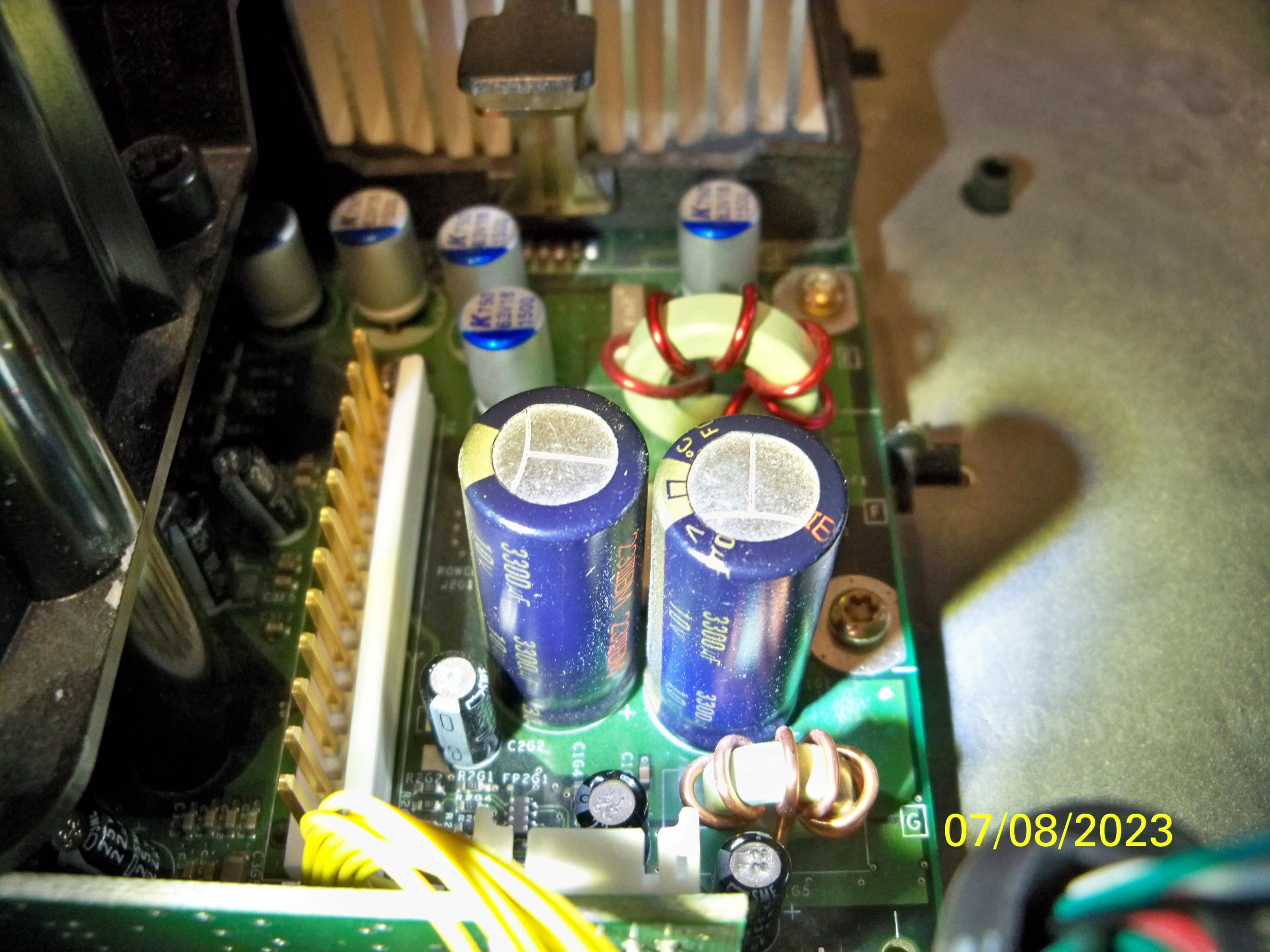

                  I'm still trying to get my 1.0 xbox working, but it's not there yet.
                  Things I've changed so far:
                  I've removed the clock cap and cleaned around it.
                  Replaced the 5 1500uf CPU caps that were leaking on their tops.
                  Tried a different power supply; no change.
                  The next thing I'd like to replace are the 2 power supply caps near the power connector.
                  The thing is they are 3300uf 10v caps (C1G1, C2F3) on my board.
                  NeMesiS34's reference guide lists them as 2200uf- 10v, and in his pictures only used 2200uf- 6.3v.
                  Shouldn't I at least use 2200uf 10v polymers or try to find 3300uf?
                  Sorry I'm not that familiar with capacitor ratings.
                  Michael F.
                    Re: Original Xbox Replacement Caps
                    what exactly is happening?
                    and why does the picture look like you bent the legs outward on those polymer caps?
                    did you order the wrong diameter ones? xbox needs 10mm caps
                      I ordered these that jayjr1105 suggested in a previous post:
                      https://www.digikey.com/en/products/...AAE014/6196333
                      Yes the leads didn't match up the holes, that's why their hovering over the MB
                      The xbox still has the original problem of FRAG, but sometimes will boot-up and work for a few minutes before freezing up.
                      The 2 3300uf capacitors don't look bad, no leaks/Bulge. Can they be bad without any visual signs?
                      Thank-you,
                      Mike
                        what caps are on the psu?
                        is it delta or foxlink?
                            probably not the 3300uf caps,
                            this is where test gear is usefull - it may be a smaller cap or one related to the ram or nvidia chip.
                            if the fox psu has any 1200uf caps on it - they may be suspect.
                            that said, i'v not seen a u.s. one so it may be different from the 230v ones
