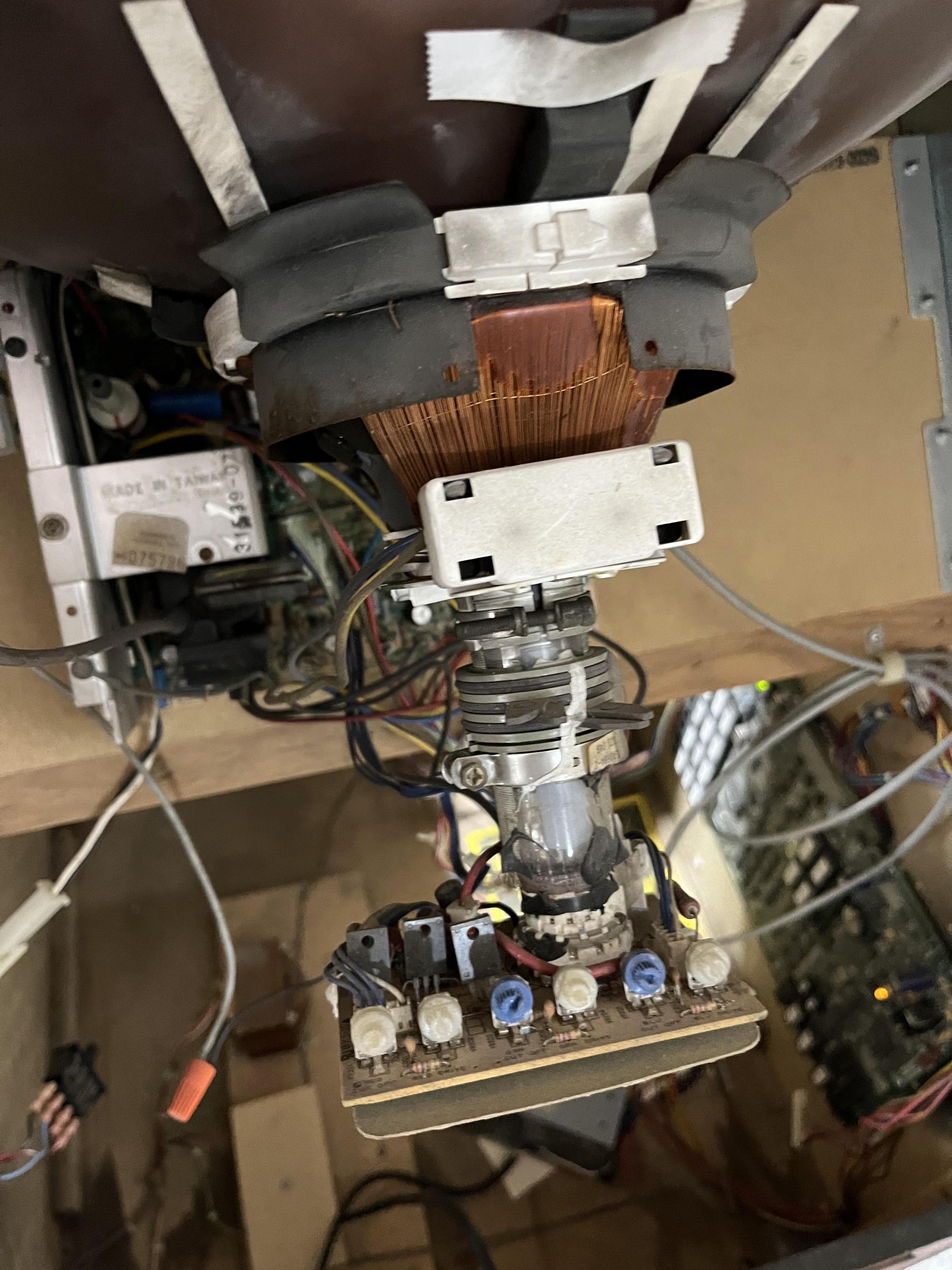

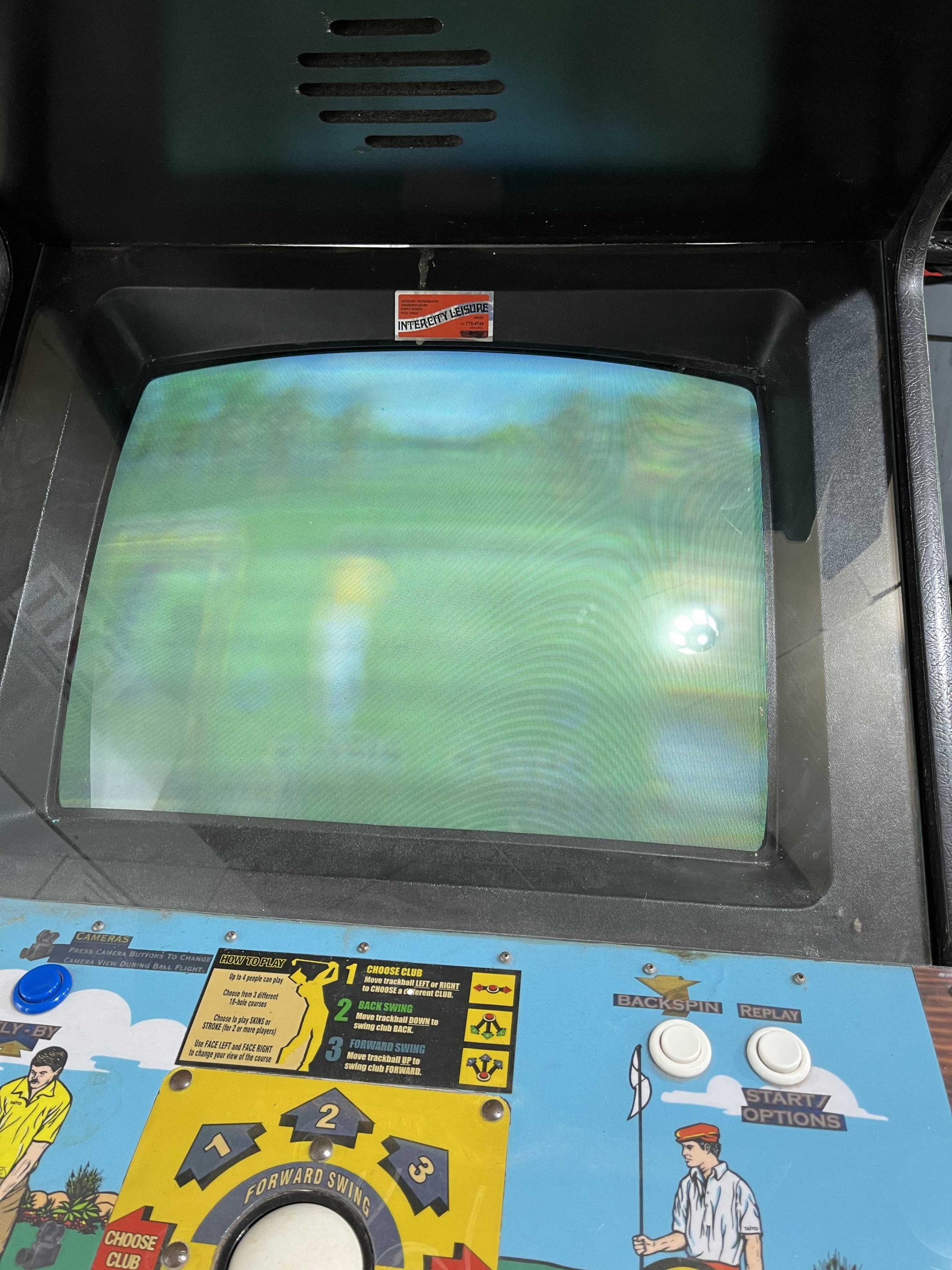

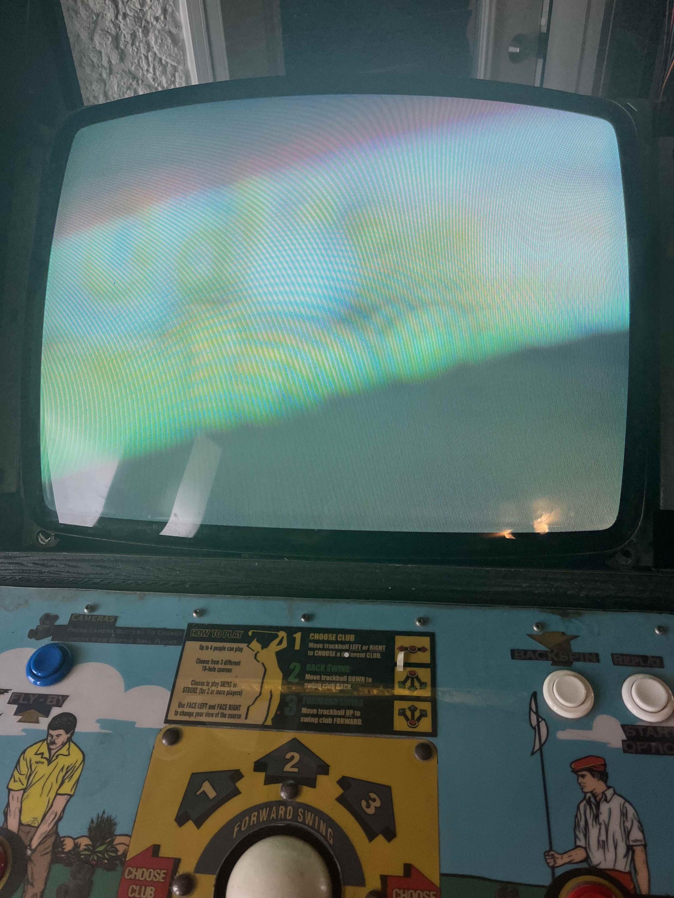

    I acquired this Golden Tee 98 and the screen isn't working. Before I throw money at this thing. By the pics would you think it's the video board or the crt?
    • 31290
    Re: Golden Tee 98 Display
    it's the monitor - focus is out
    try ajusting the focus control on the high voltage transformer.
        there is no power board,
        the chassis board handles the power and deflexion,
        the small board on the tube neck does the colours

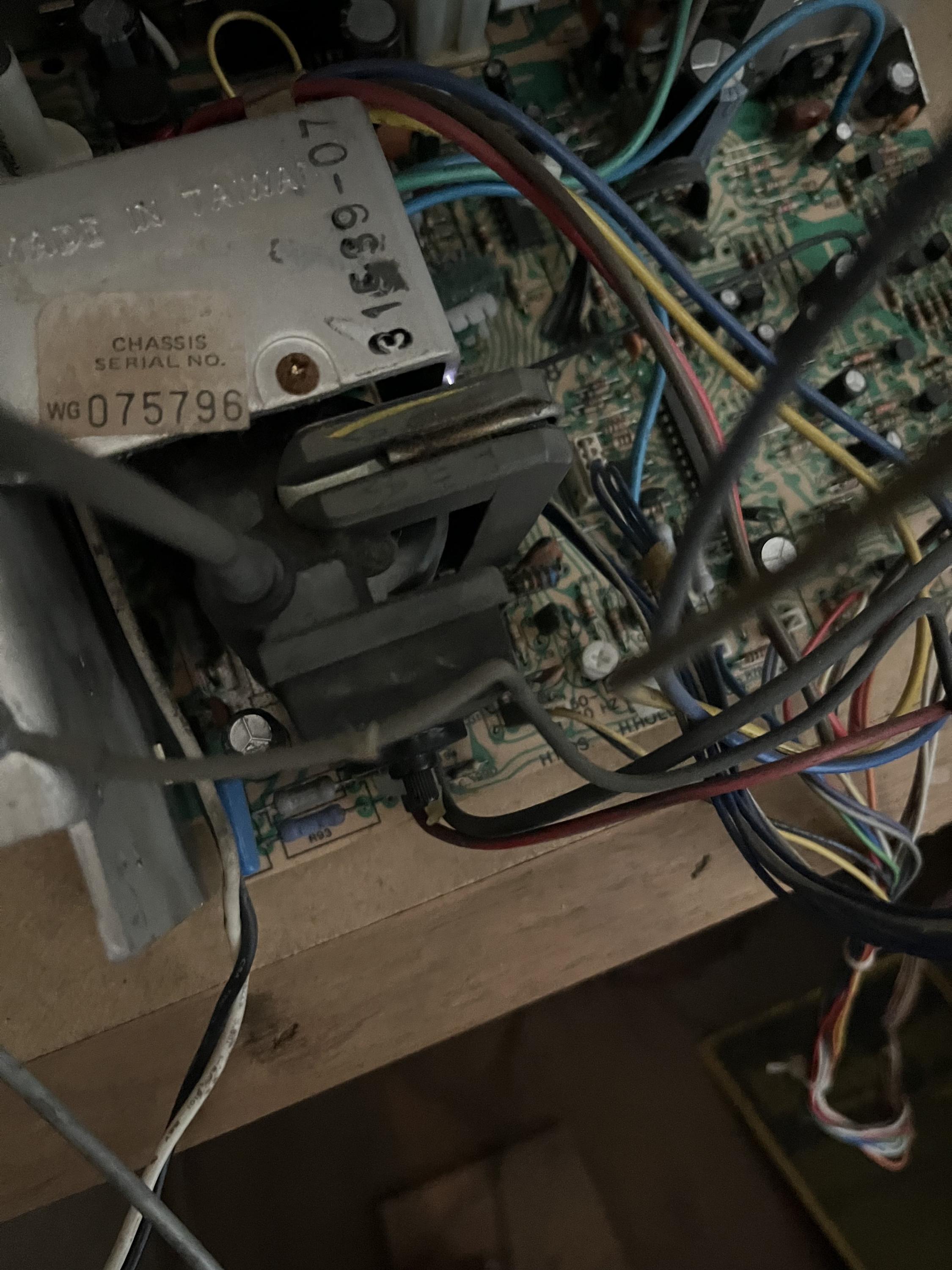

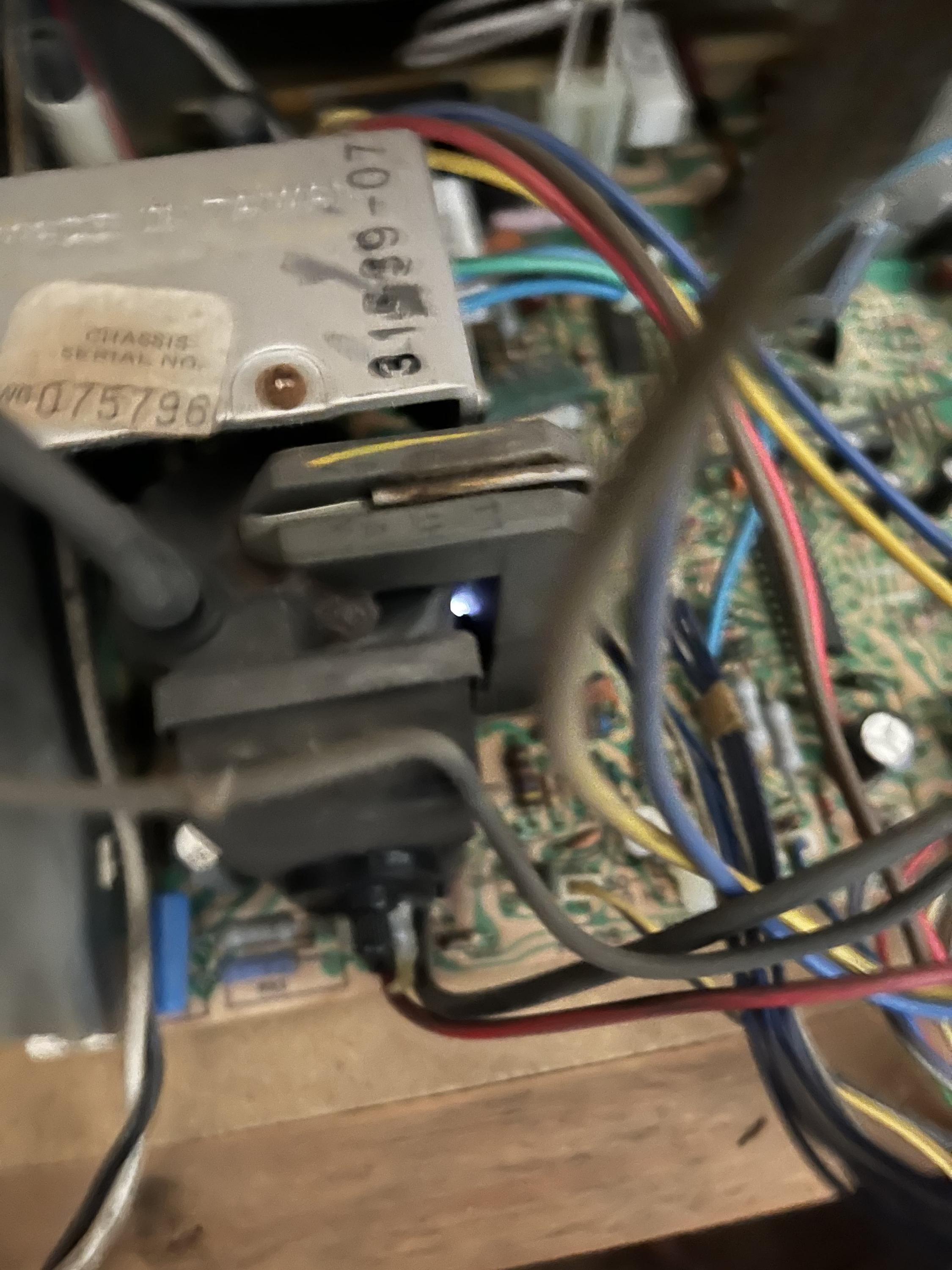

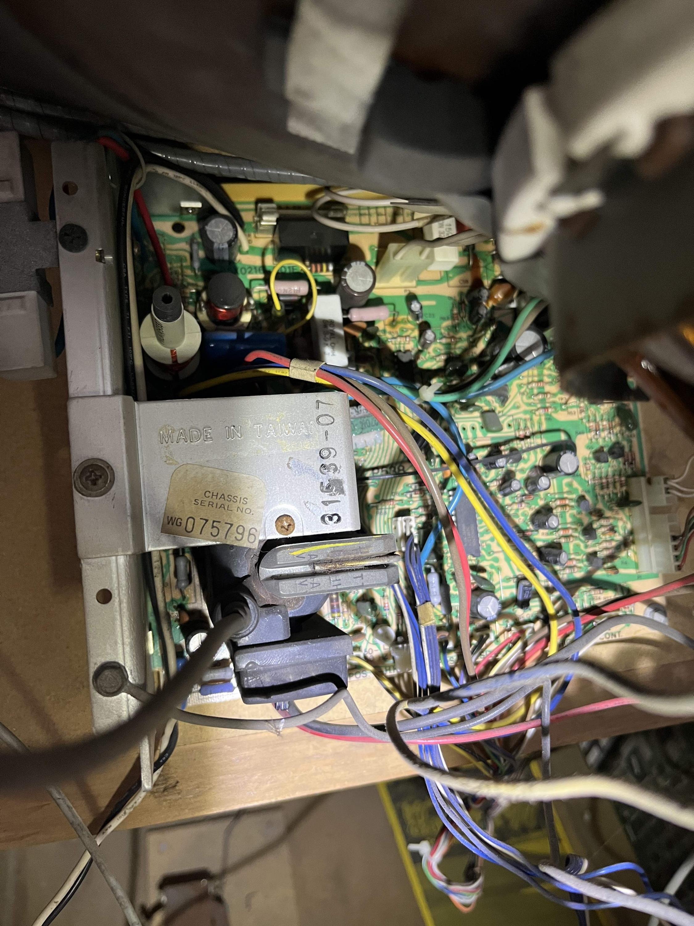

          I added some pics. Notice the arcing. I wonder if I can get the video board. I can't much for part numbers on it besides whats in the pics.
            • 31290
            it looks like a wells gardner chassis - not sure the model but it should be a "U2000" from the manual

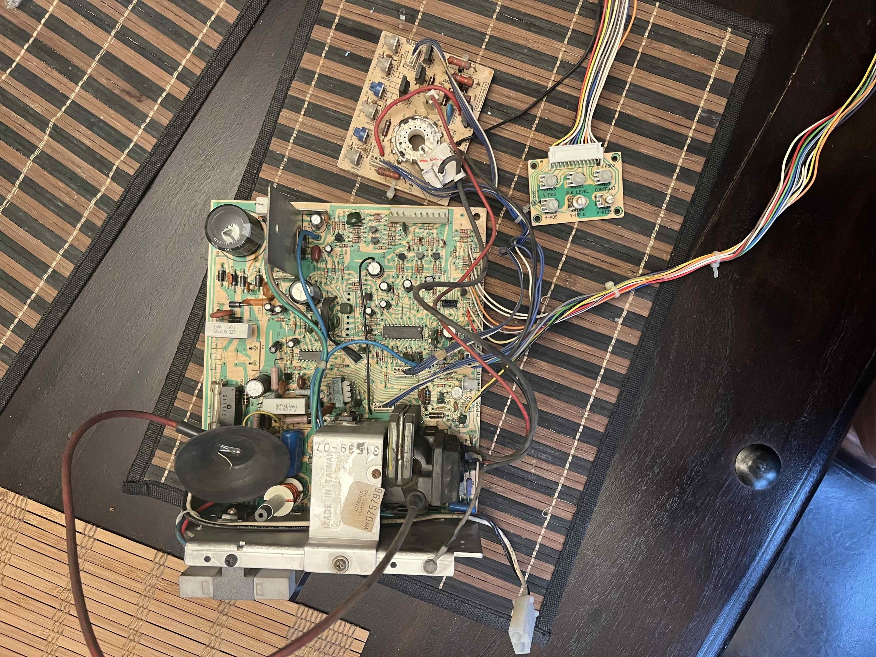

                I added pics. I watched a youtube video and my board doesn't look like the 2000 or 7400 or 7500. Would be stamped somewhere if I pull it out of the unit?

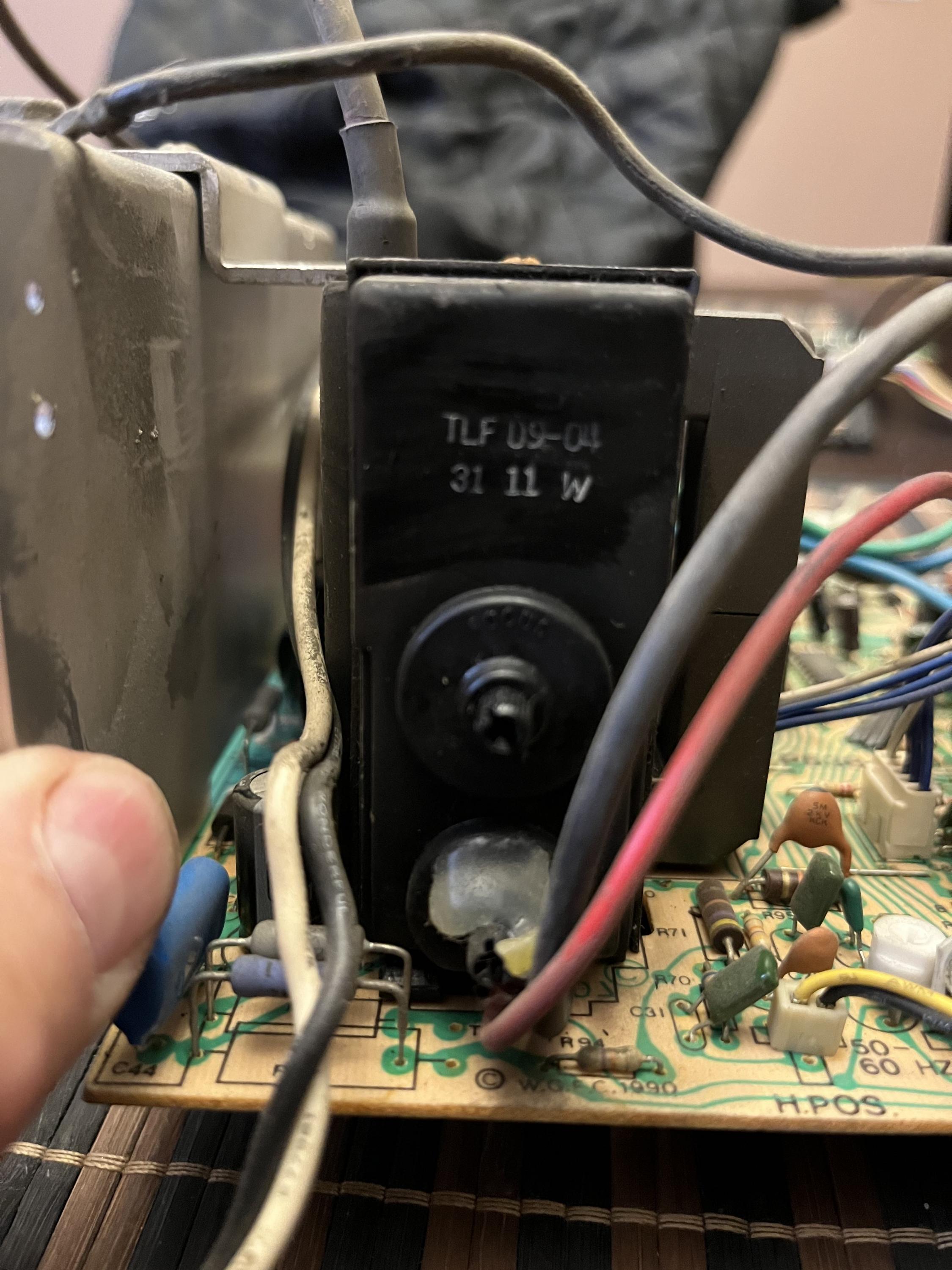

                  It's a k7000. So would it be safe to replace the flyback and recap it? I think the part number is BSC25-0146
                    • 31290
                    if the transformer is arcing then replace it - check the number stamped on it.
                    it doesnt look like a k7000

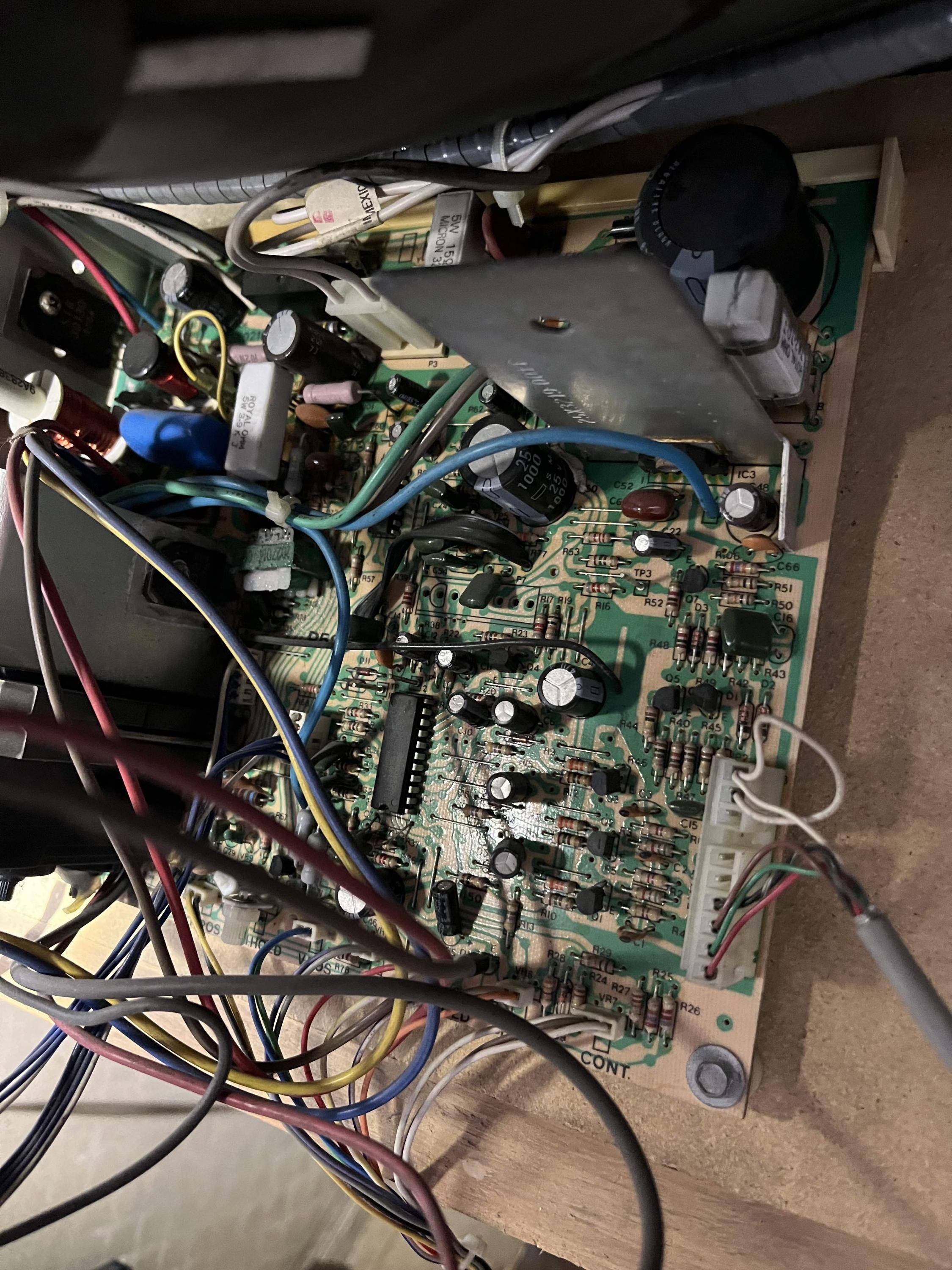

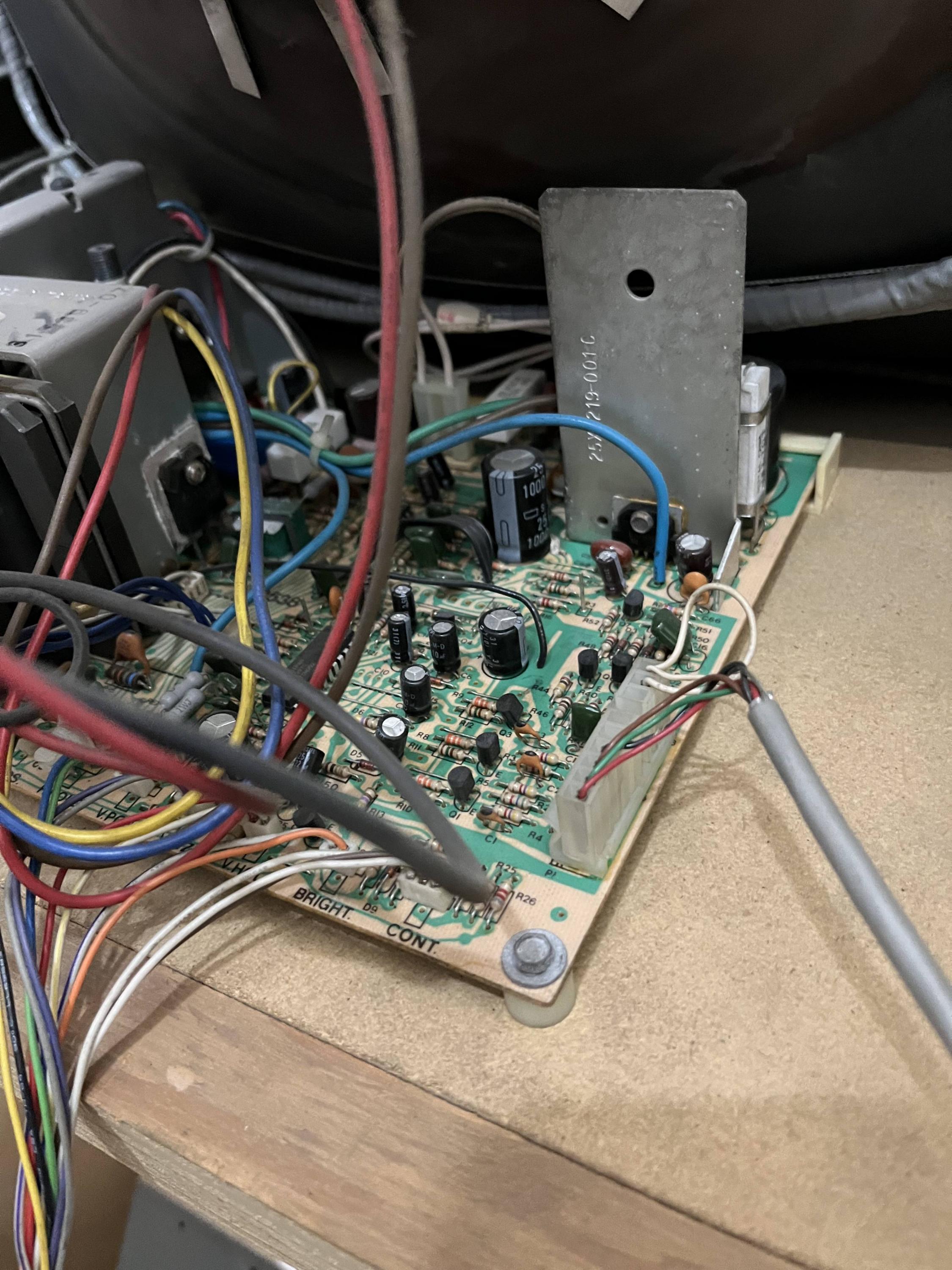

                      more pics

                        I ended up buying a converter and am putting a lcd in the machine. Another question please. Would the flyback cause this on the screen. Don't mind the black, that's my phone I think. I siliconed the flyback temporary to see if it would get better and it didn't. Oh the number on the flyback is TLF09-04
                          • 31290
                          the flyback in wells-gardner and hantarex monitors is known to fail,
                          it's not the hole thats the problem, it's the shorted windings inside - the hole is just a side-efect of the heat from arcing.
                          a new transformer will 99% fix it - a few caps will complete the repair.

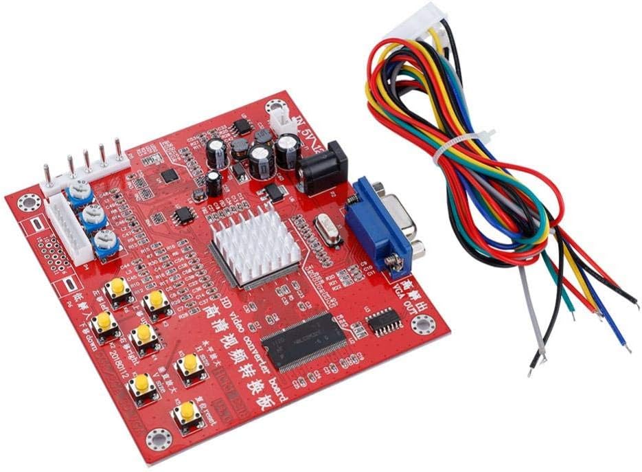

                          what converter did you get? a GBS8200/8220?

                            I just bought an Amazon one and installed it today. I put in a 26" lcd tv in the cabinet and it works great. So would I need a new flyback and recap?

                              repl;ace the transformer and any caps rated 100v or higher
