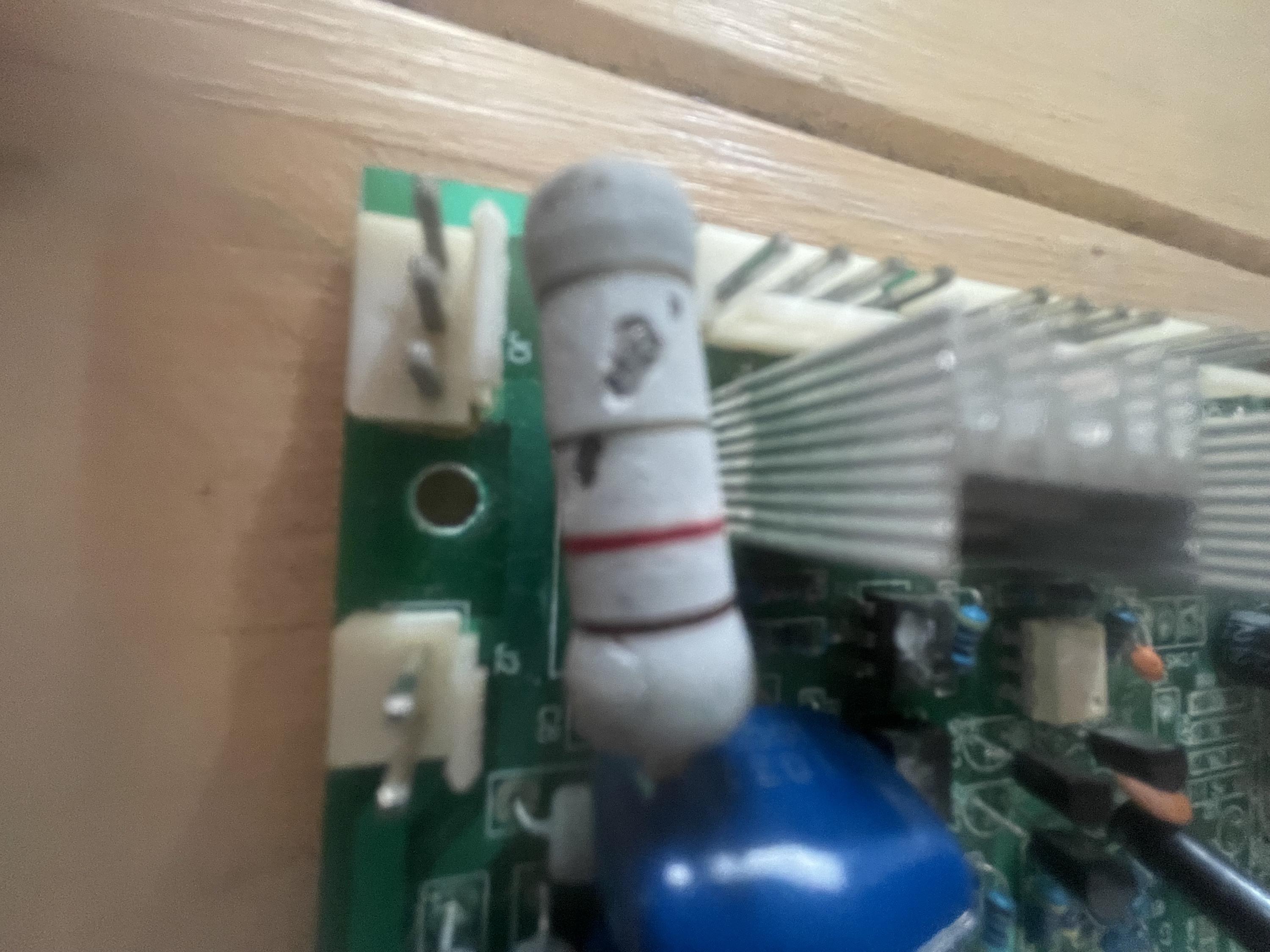

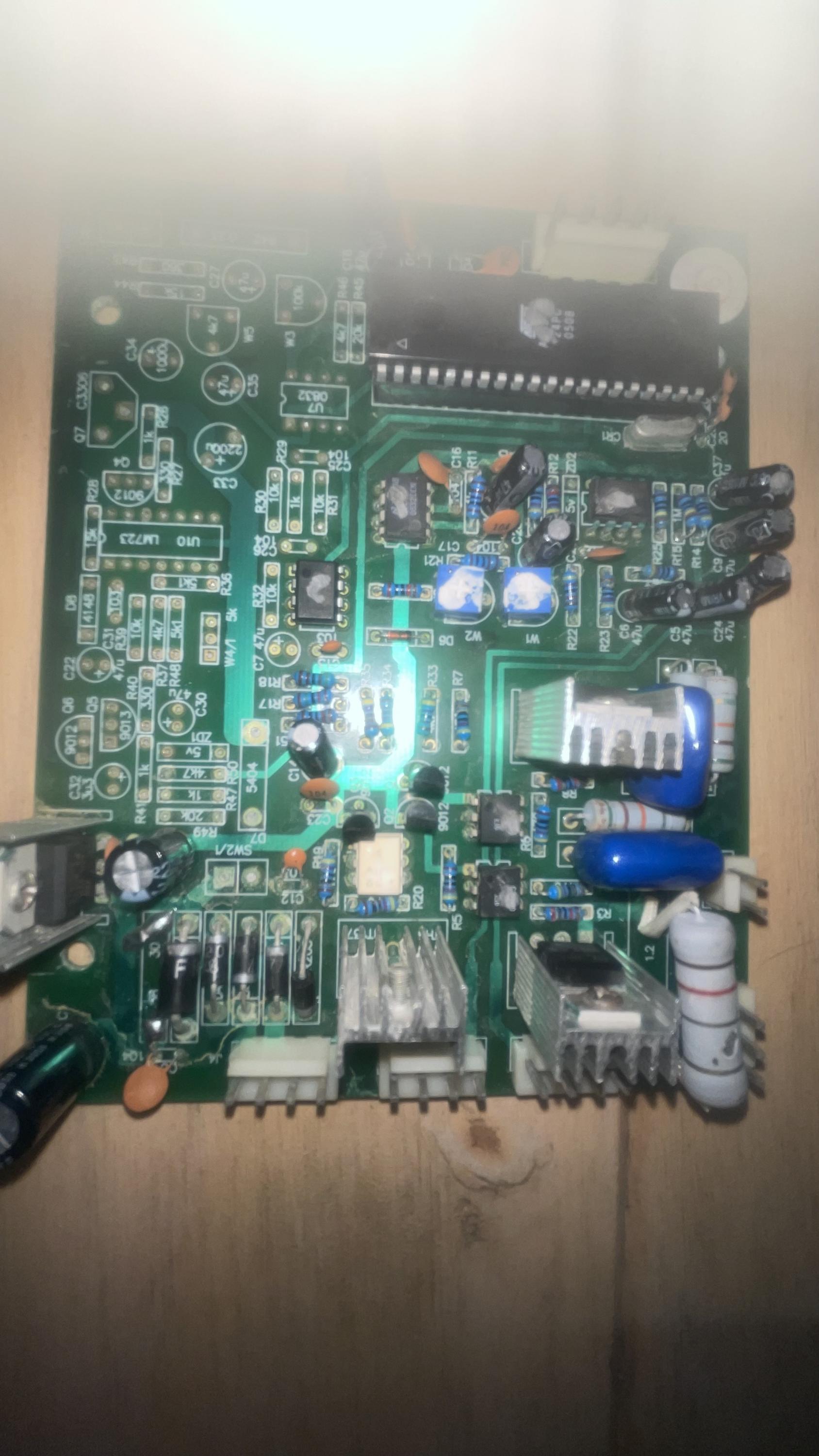

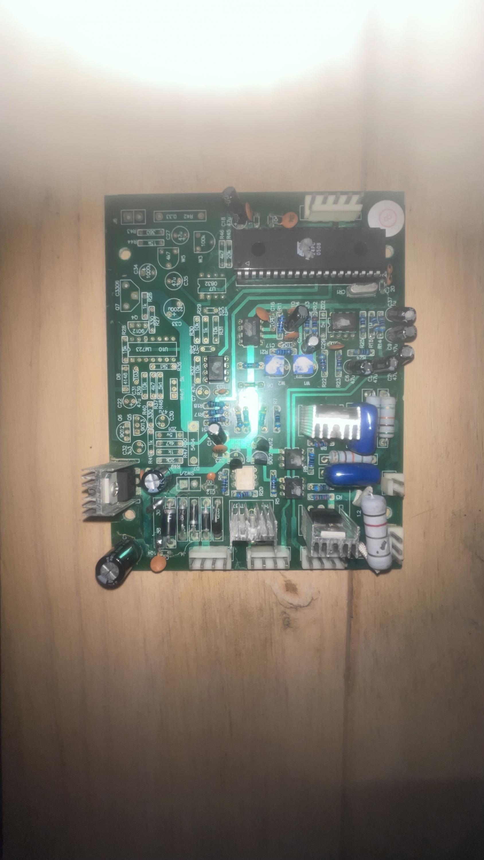

Hi all
Hope sumone can help.
the heating element failed, so i bought a new one researched how to replace it.
I wasn't looking forward to it much but was gonna do it anyway.
i powered it up just to make absolutely sure i needed to. (This was my first big mistake)i knew it needed changing.
so got all tools together, i started taking out screws and consentrating on instructions from the laptop.I grabbed the old element with a pair of pliers to pull nit out of the handle and bang little puff of smoke it was still plugged in.
so 20 years later can anyone help me diagnose and repair the power board just to see if i can get it up and running again.
Thanks in advance
Phil
Aoyue 738 4 in 1 solder station power board
Vizio e601i-A3 - Has Sound and Display, But No Backlight - Bad Power Supply Board or Bad LED Bulbs ?by Tynan DillI was given this TV from my great uncle. He said it just wouldn't turn on one day out of nowhere, replaced the TV, and gave it to me to possibly fix and use for myself.
Assuming...7 Photos -
by howardc64All left and right refers to looking from rear of TV (or looking from front with TV upside down)
- TV came with vertical bars and no image. Found faulty TVS on left buffer board. Also replaced T-Con (may have damaged the original while hot air removing components, board has slight warp) and have full image but few horizontal lines on the screen. Some of the lines appears to be 2 pixel tall while others are 1 pixel tall.
- Disconnecting left and right buffer board potentially reveals problems on both sides with different signals (unless this T-Con require jumper like Samsung FB_TRDY1&3) Fault
by defdjamelHi everyone,
I’m trying to remove a component from a 2021 MacBook logic board, but I’m having trouble.
https://www.electronicsdatasheets.co...s/tlv70733pdqn
I’m using hot air at 480 °C with full airflow and good flux, but the solder paste is not melting.
I know there’s a lot of thermal dissipation from the board, and I suspect the copper planes are absorbing most of the heat.
Do you have any tips for this kind of board? Would a preheater help?
Thanks in advance!
by howardc64Problem
This is an LG edge LED lit LCD Display. The LEDs are on the bottom edge of the display. There are 2 bars (left and right) Each bar has many LEDs and a 6 pin connector. Each pin drive several LEDs thus is the highest current flow / heat junction. The weak lead free solder gradually fails with thermal expansion/contraction cycling and increases resistance. PSU will compensate up to a point, then when the current is too high, PSU just shut down the backlight causing a dark display. I have even seen one which the connector just fell off as solder points became completely detached....-
Channel: Troubleshooting Computer Displays
by acedogblastThis is a guide that I am writing for helping others to replace their MEC1503 EC chip if it breaks (or to get around an inconvenient prompt to the BIOS). This forum has been extremely helpful to me so I would like to contribute to help others. I will tell you right now that this task is very difficult to do. You MUST have experience and tools to do precision micro-soldering, BGA reballing, trace repair, and general laptop repair skills.
There are some specialty tools needed to do this task. The replacement MEC1503 chips can be acquired from Aliexpress. Do not buy the bare chips as... - Loading...
- No more items.
