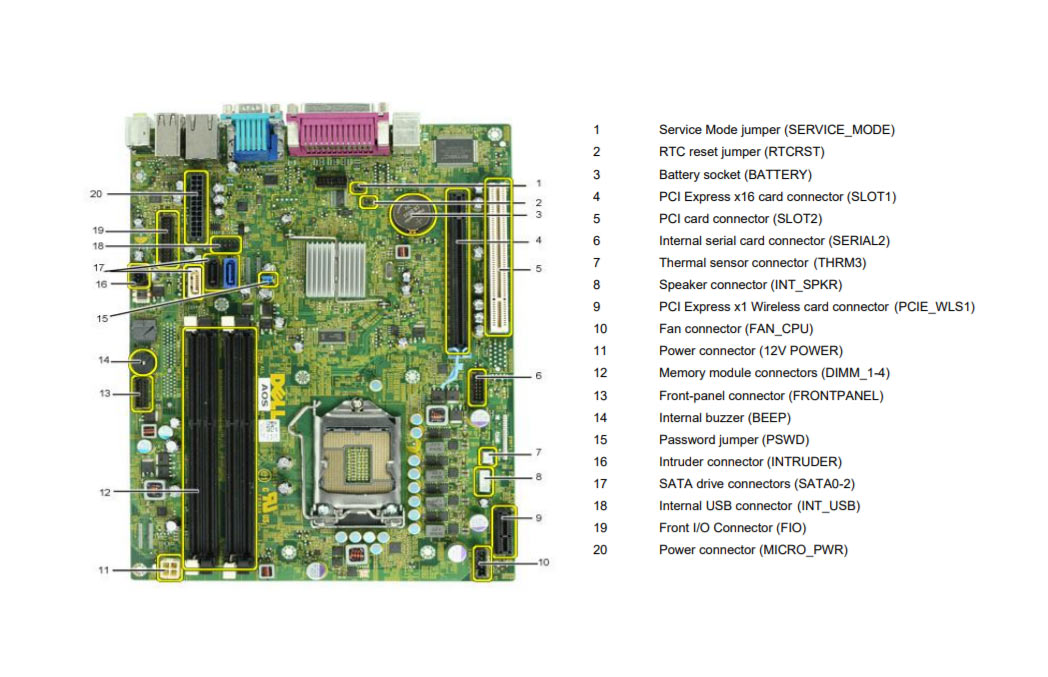

Dell optiplex 980 system password removal
  • eenee
    • Aug 2022
    • 48
    • Mongolia
    service tag 56HV72S
  • volinakis
    • Jan 2021
    • 2728
    • N/A
    Re: Dell optiplex 980 system password removal
    Originally posted by eenee
    service tag 56HV72S
    you have a password jumper - pos.15 After removing jumper, take off CMOS battery for few minutes.
    • eenee
      • Aug 2022
      • 48
      • Mongolia
      The password jumper is not working. The password still persists.
      • volinakis
        • Jan 2021
        • 2728
        • N/A
        Also take CMOS battery off. Start without jumper.
