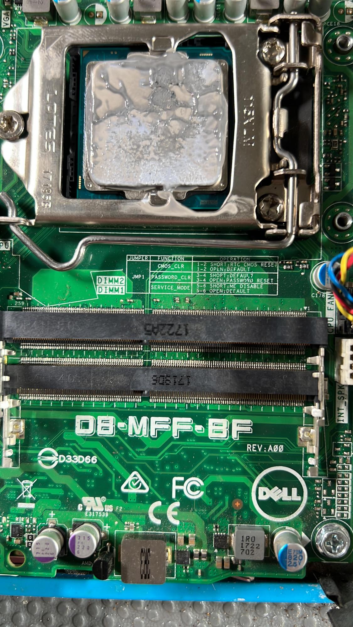

      this dell optiplex 3050 micro can turn on but shows error:
      Boot Guard verified failed
      system will shutdown
      press any key
      in the attachment is the bios i backup from this machine and also attach the service tags and mainboard number
      thanks man.

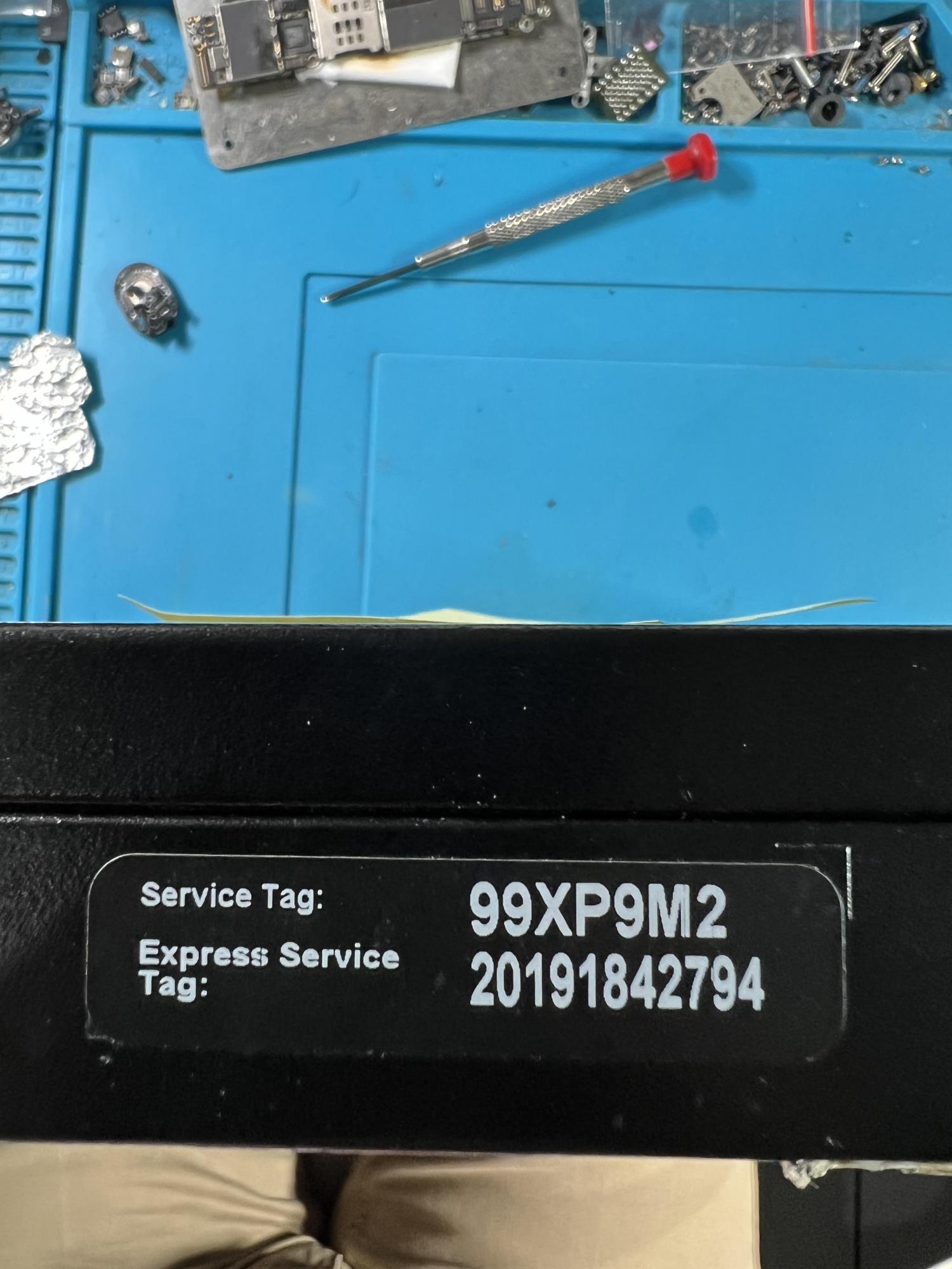

        Re: Bios Dell Optiplex 3050 Micro
        Dell OptiPlex 3050
        Service Tag: 99XP9M2

                  Hello
                  I need help !
                  I have a Dell 3050 Micro that won't start... It displays 2 led flashes (orange) then 5 led flashes (white)
                  It's probably a corrupted BIOS problem.
                  Can you help me find the right file to reprogram my Bios chip?
                  The EZP2019 programmer does not come to anything and does not recognize Winbond 25Q128CSIG chip - It tells me that it is an Eeprom93!
                  When I set manually on the Winbond 25Q128 and I start the process, the writing starts then an error appears after checking the writing. The Bios chip does not keep any data and remains empty!
                  I have the impression that this programmer is not very reliable! Do you have a reliable programmer to advise me?
                  Serial Number: 2B551M2 / Express Service Code: 5027326058
                  Thank you in advance for your contribution !

                      Hello;
                      Thanks for your quick response and advice...
                      I have already tried the 2 files in #4 - But nothing works - With EZP2019 + croco clip (even at low speed) it ends in failure (flash check error address 0h)
                      In reading, the original chip seems empty! So difficult to recover an .OLD file
                      I will wait for a possible other solution while waiting to receive a new programmer to try again!

                        Correction !
                        Back to my original post!
                        The BIOS chip is not a WINBOND - It is actually a GigaDevice 25B128CSIG
                        After buying the CH341A programmer - I managed to rewrite the BIOS - My various attempts brought me different LED diagnostic codes, but the PC does not start...
                        I managed to recover the Bios 3050.old and I reinstalled it as at the beginning - I am now waiting for your help...
