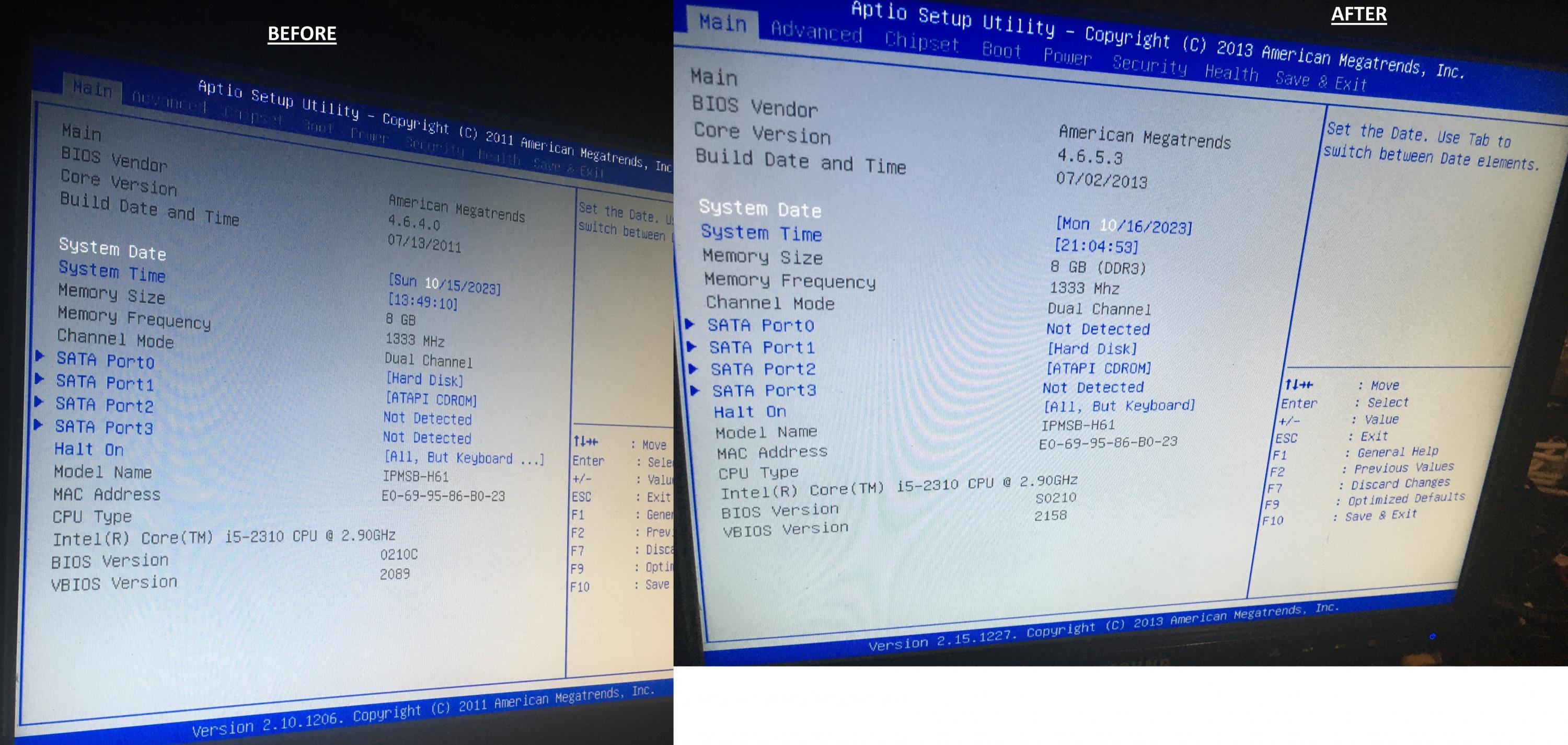

          Re: Pegatron ipmsb-h61 bios
          Originally posted by peste
          you need a SPI programmer...video for example..
          https://www.youtube.com/watch?v=DWWigscuQDY
          hello.
          Thank you for replying.
          First I tried to flash with the AFUDOS app and it crashed my motherboard. it wouldn't turn on.
          then i remembered that i had a programmer that i bought some years ago. and with it i could update the bios, but i could not with the bios chip that came by default with the motherboard as it was 4mb. fortunately i had some old motherboards and in one of them there was an 8mb chip from the same manufacturer. happily it worked.
          i haven't tried an ivi bridge cpu yet because i don't have one yet. but i will buy one in the next month. i think it will work. if i get it to work i will try to remember to post it here.
          thanks for everything. you saved me a motherboard from going to my pile of dead motherboards.
