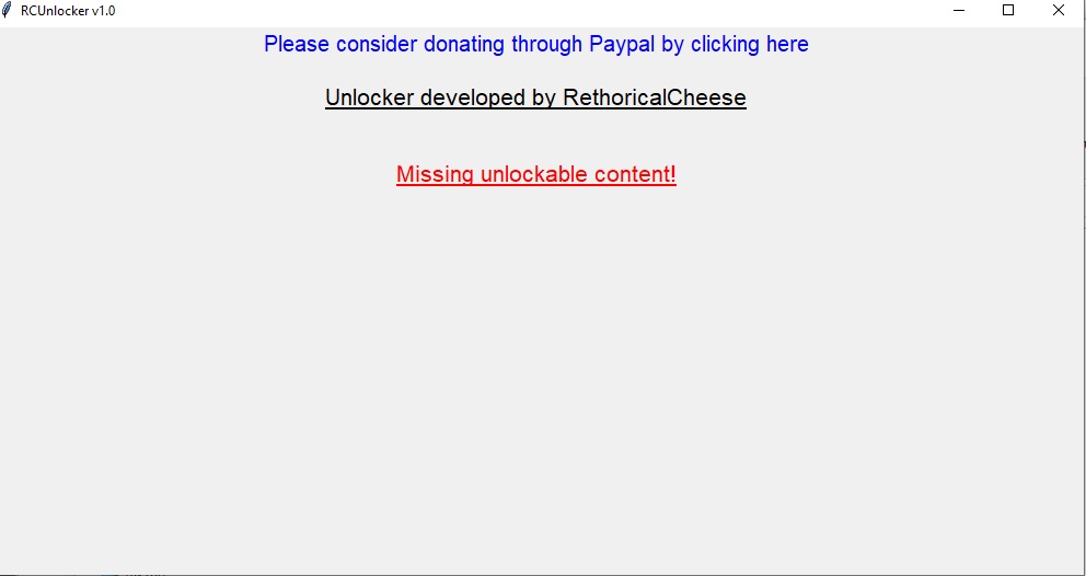

            Did you try RCUnlocker

                Re: Hp elitedesk 800 g1 locked bios
                I tried the HPUnlocker not the RC one!
                • Christakos19
                  • Dec 2021
                  • 28
                  • Greece
                  Is that normal pop up?

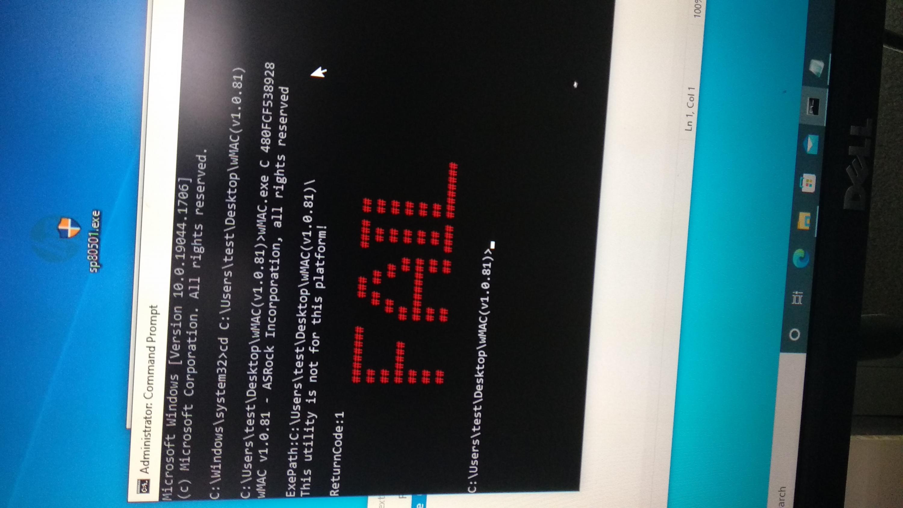

                      I programmed the bios you sended and entered DMI info but it doesnt get mac address and i cant input it.
                      Any help on that?
                      P.S. Other than that it seems to working fine.
                        • 20884
                        Any help on that?
                        Try ASRock MAC address tools
                        https://www.badcaps.net/forum/showpo...10&postcount=4
                        • Christakos19
                          • Dec 2021
                          • 28
                          • Greece
                          Tried but got the following fail message.(see foto1)
                          Also i have installed the ethernet driver but its still like this.(see foto2)
