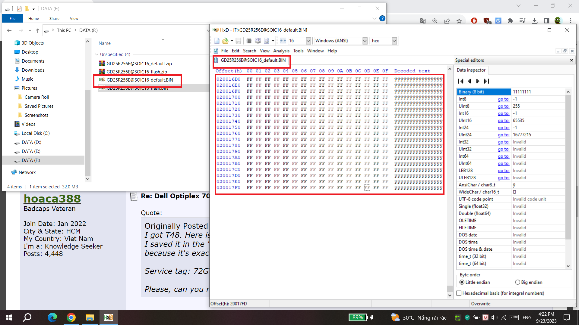

            I got T48. Here is BIOS dump.
            I saved it in the "default" buffer and flash. I'm not sure which one is correct, but I would assume flash because it's exactly 32MB.
            Service tag: 72GTSH3-8FC8
            Please, can you reset password?

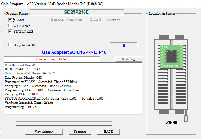

                Thank you! I fleshed patched firmware, but got "status reg error" on verification step (see attached screenshot). I skipped status reg verification and started PC just to check.
                I entered manufacturing mode and set up the same service tag. After reboot, I disabled manufacturing mode using ALT + F.
                After that, everything ran OK, with no errors in BIOS log, and no problems with BIOS settings. (Haven't tested the VMT yet)
                But I also checked diffs between original and patched flashes - the end of the patched file is FF FF...
                Could this affect anything in the future? Should I replace this with data from original firmware and flash it again?

                  What you mean is this ? That doesn't affect anything.

                                      The problem is STATUS REG ERROR at: 0001 Buffer Value :0x02 --- IC Value : 0x03 When I burn flash from badcaps or even dump from GD25B256EFIR . And after flash process, motherboard shows error 3-5 (memory problem). But everything was OK except admin password. What I did wrong ?
