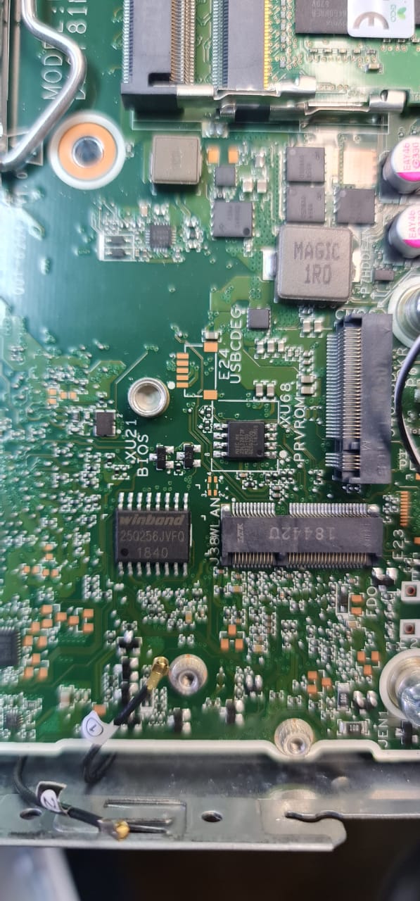

    Hp prodesk 600 g4 DM PC
    this pc turns on with no display,,,,,i found two bios chips on mobo so confused which one should flas ...any advice on which bios chip should flash...one is 16mb and other one is 32mb pic is attached
  • peste
    • Dec 2016
    • 12768
    • ROMANIA
    Re: Hp prodesk 600 g4 DM PC
    post the content on both bios chips.

        Hp ProDesk 600 G4 Mini Bios Problem.
        Pc was getting powered on giving 3 long & 2 short beeps without ram. I tried to repair its main bios (25Q256) but something went wrong and it damaged 16Mb (25Q128) bios too. Now even with original bios, Pc gives 6 long & 3 short beeps and doesn't power on. Please help to fix these bios or if someone has working bios (16Mb & 32Mb), kindly share. Thanks.
              Can someone please extract the BIOS RGN file from the bin file in the Hp bios update?
              • ASB
                • Dec 2020
                • 133
                • Pakistan
                  • 20844
                  Open Q22_022300.bin with a hex editor,delete 0 - 21F (length 220) ,next select block 0 - FFFFFF (length 1000000) ,copy and paste into a new file and save.
