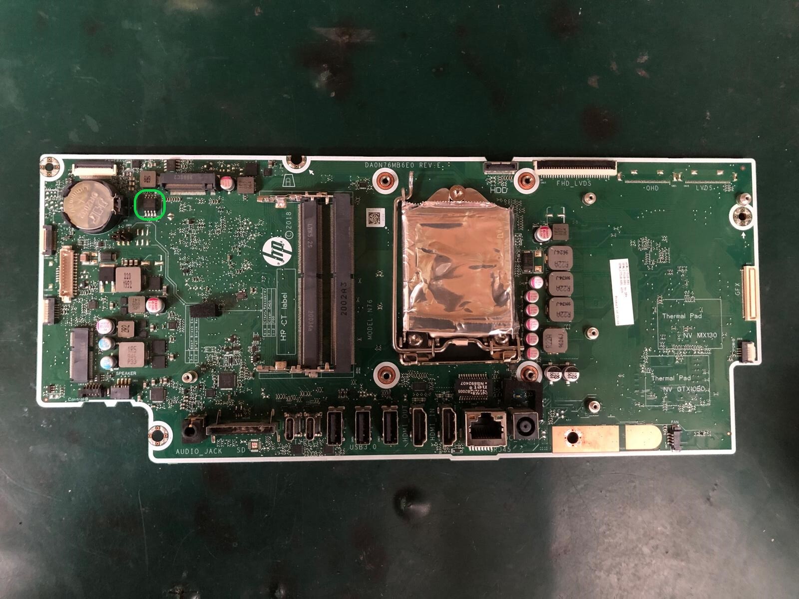

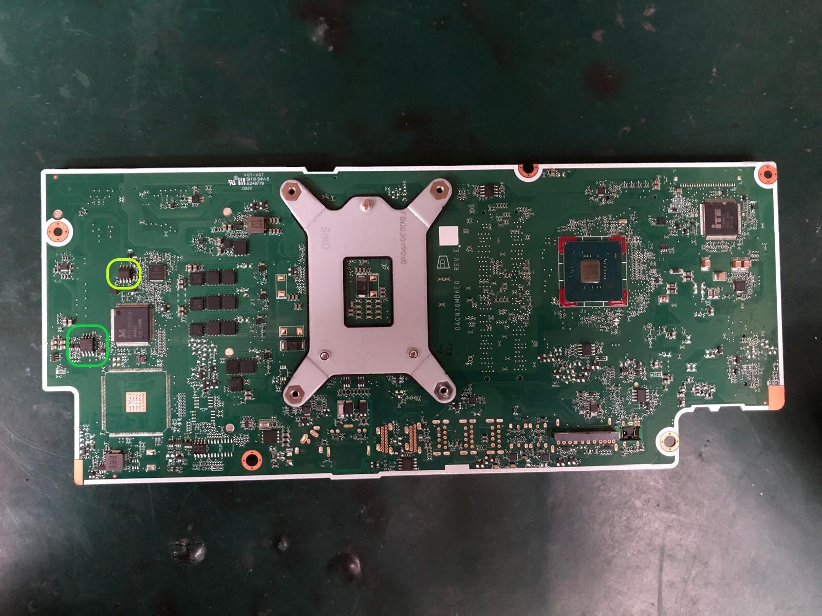

    Hi.
    As requested I dumped all EEPROMs.
    X2 @ 200
    X1 @ 150
    The 200s are WinBond & GigaDevice.
    The 150 is an ST Chip, unknown to most programmers,
    I'm using an RT809H, used a standard setting for 24C Chips at 1.8v.
    I did three dumps of that and verified, a very small BIN for the Realtek RTD2525A, as it's right next to it opposite the 200 SOP GigaDevice IC.
    I hope this helps the forum.

      Good afternoon all,
      I have the exact same computer HP 24-xa0024 DA0N76MB6E0 Rev E product ID# 4NM47AA#ABA and have tried flashing the bins from the HP site using neo programmer but its always the same result the damn 3+4 beeps, currently flashing the one that Comps&Cons provided to see if it works. I have tried so many BIOS bins to see if I can find the correct one, when I had the original one it kept saying BOS corrupt but when it tried to fix it would fail and I would get the 3+4 beeps again

        Post the PC serial number and your original backups
        • rxc777
          • Oct 2025
          • 2
          Greetings,
          The serial number is: 8CC9412V2S I was able to dump the bios next to the bin but cant get the reader to read the one on the other side of the board.
