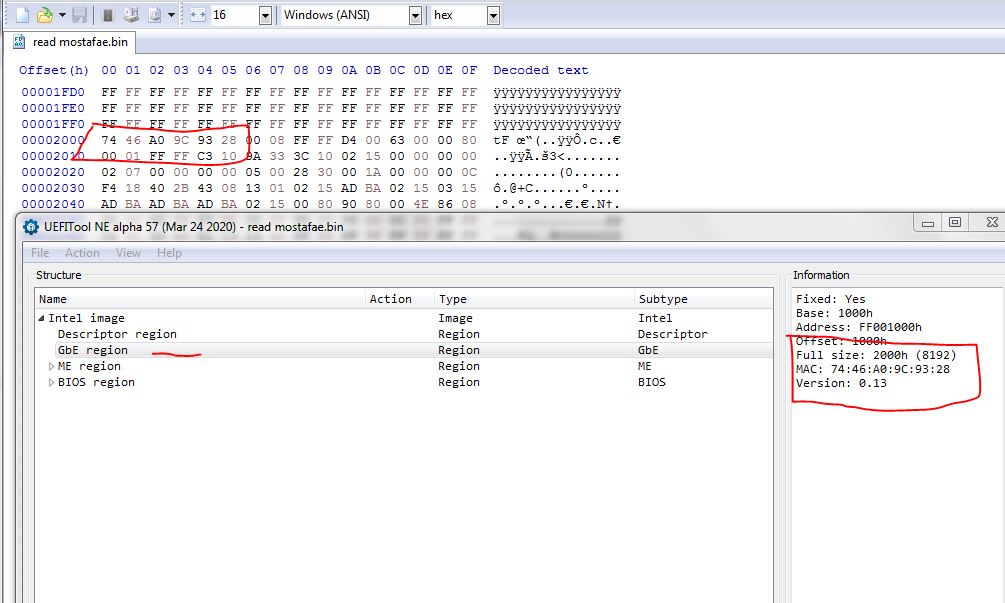

        how to find mac address with hex editor
        hi , i have find mac address in hp 8300 bios and copy in new bios . how to find it ? thank you

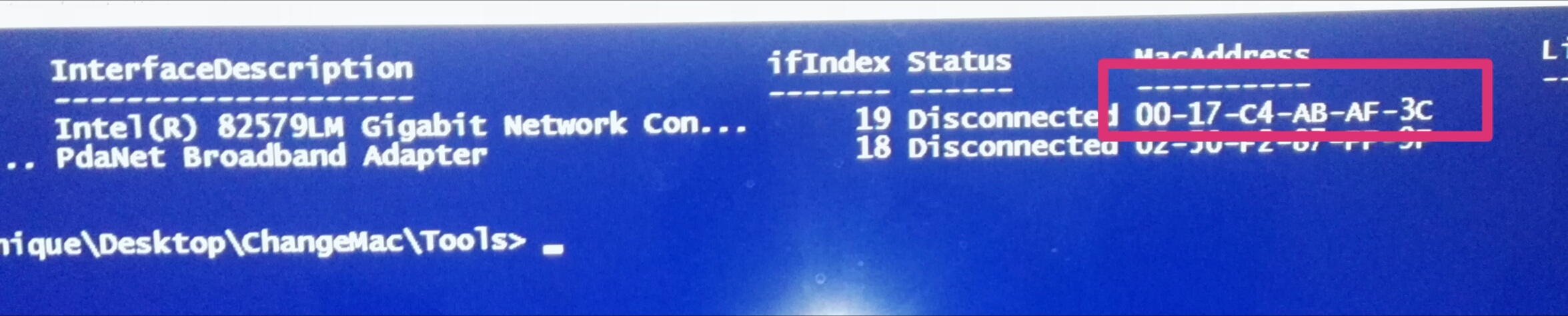

          Did you edit your mac into cmac.bat in the ChangeMac tool ?
            • 21841
            Re: how to find mac address with hex editor
            With a hex editor and UEFITool

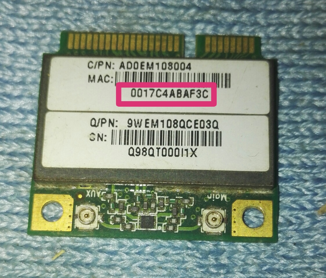

                Re: lost mac address in hp 8300
                Hi friends, for my part, I couldn't find my mac address, so I used that of an old Wi-Fi card. for this I therefore used UefiTool to locate the mac address (FF FF FF FF FF FF ) in the new downloaded bios, then I wrote
                the mac address of the old wifi card manually In the New BIOS instead of ( FF FF FF FF FF FF ), after finishing writing I save everything under a new name ( ex: Moded.bin ).
                I unsolder the BIOS memory chip from the motherboard, I make a backup of the chip (using ch341a programmer) with the same programmer I flash the chip with the new BIOS (Moded.bin), then I reassemble the everything and it works
