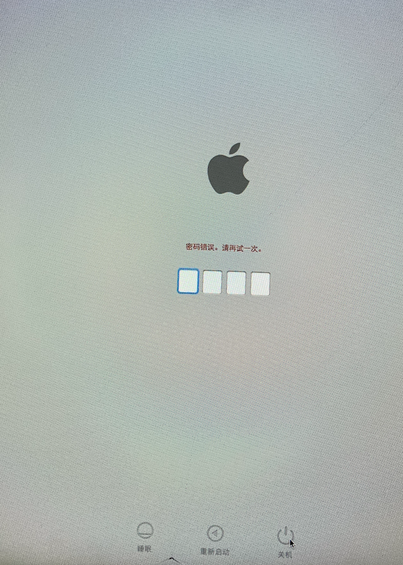

                    • focus2k
                      • Jan 2020
                      • 28
                      Re: Need iMac clean EFI A1418 820-4668-A
                      windows stick don't even recognized... :-(
                      in recovery, this happens:

                        Ok, im really sorry. Maybe I made a mistake.
                        My Board is 820-4668 , but I don't find a efi with this number...
                          • 21841
                          try this one .Also do a PRAM reset and reinstall the OS.
                          • focus2k
                            • Jan 2020
                            • 28
                            Perfect ��
                            Workings
                            Thx@all
