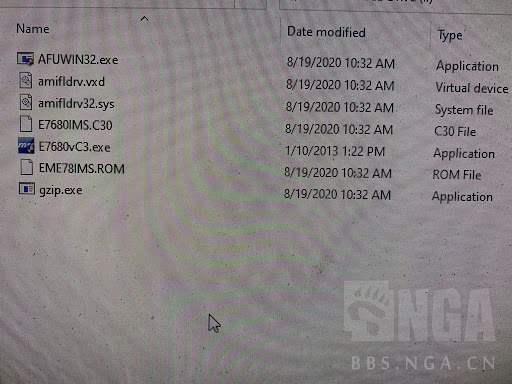

Msi h61m e23 b3 bios update 12.3 bin file urgently needed.
  • Grimly
    • Nov 2020
    • 14
    • south africa
    I was trying to update a friend's mobo to the latest bios so he could installed a better cpu and I messed up a little since it was so late at night and I wasn't thinking clearly.
    Short story even shorter, I really need the file that the exe creates on a USB to continue and finish the update otherwise the pc will display a red message for all eternity.

    Re: Msi h61m e23 b3 bios update 12.3 bin file urgently needed.
    @Grimly - Here you go - http://s000.tinyupload.com/index.php...61073606666458
    This exe contains two BIOS, one is ME7 FW update, I assume it flashes this first, then the ME8 final update after that. You should be able to use ME8 directly if you want, but I am not 100% sure.
    You may need to program in ME7 one, then via M-Flash update to the ME8 one. If you try that first and it fails, directly program in the ME8 one
    Or, maybe it's possible, that during normal USB Update, it asks you if you want to update to ME8 version or stay on ME7?
    I see several versions on the site mention you can't go back to ME7, so I assume all those have both ME 7 and ME 8 version BIOS inside them. If you have flash programmer, you can always go back to ME7, if you wanted
    This is similar to the other thread you posted in, with ME7/ME8 BIOS in post #2, but I am not sure what version those files are - https://www.badcaps.net/forum/showthread.php?t=76619
    I extracted these I'm linking from the exe version you mentioned (v12.3 aka 7680vC3 - latest on MSI Site as of 11/20/2020)
        You're welcome! I assumed you were using flash programmer, like CH341A, to recover a bricked board.
        Is the board running? If yes, then you can use M-Flash to flash either ME7 or ME8 one, but you can only flash whichever one matches what ME FW version you have in there now.
        Put BIOS on USB Stick, enter BIOS, go to M-Flash, and then browse to the file. Best if USB is FAT32 and BIOS is in root of USB, not in a folder.
        You may need to rename each one to the appropriate name.extension, sometimes M-Flash requires this.
        For >>
        ME7 file >> EME78IMS.ROM
        ME8 File >> E7680IMS.C30
        Also, if board is working, and you're currently on ME7, but want to go to ME8, then flash in ME7 one first, then reboot and M-Flash the ME8 one
                      Show me image. Did you put the files on USB Stick, not in folders, on FAT32 formatted USB?
                      If yes, did you rename them to what I mentioned? I would put two copies of each, one with both having .bin extension, and another having extensions as noted out above in post #4
                      You have have to get flash programmer, like CH341A or other + SOIC8 / SOP8 Test clip with cable.
                      Try this way of formatting the USB, shown at beginning (mainly make USB Label MSI before doing above)
                      https://www.youtube.com/watch?v=pZ1u9xnSR38
                              @BIOSG3tta3 I found images to show you which files I need for the BIOS update.
                              • Grimly
                                • Nov 2020
                                • 14
                                • south africa
                                @BIOSG3tta3 OMG I figured it out, you were right about renaming the ME7 and ME8, 7 must be a Rom and 8 must be a C30 file but then you must add another ME8 file and rename it EIVB.bin and it works!!! I just followed the image to come to my conclusion.
