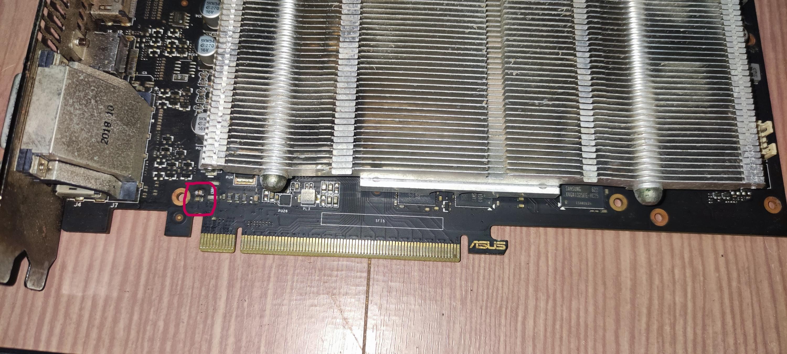

      hi all.
      I'm looking Asus dual gtx1060 3gb schematic.
      Some part is missing, I think that is capacitor but don't the value.
      If have boardview schematic, it is an advance.

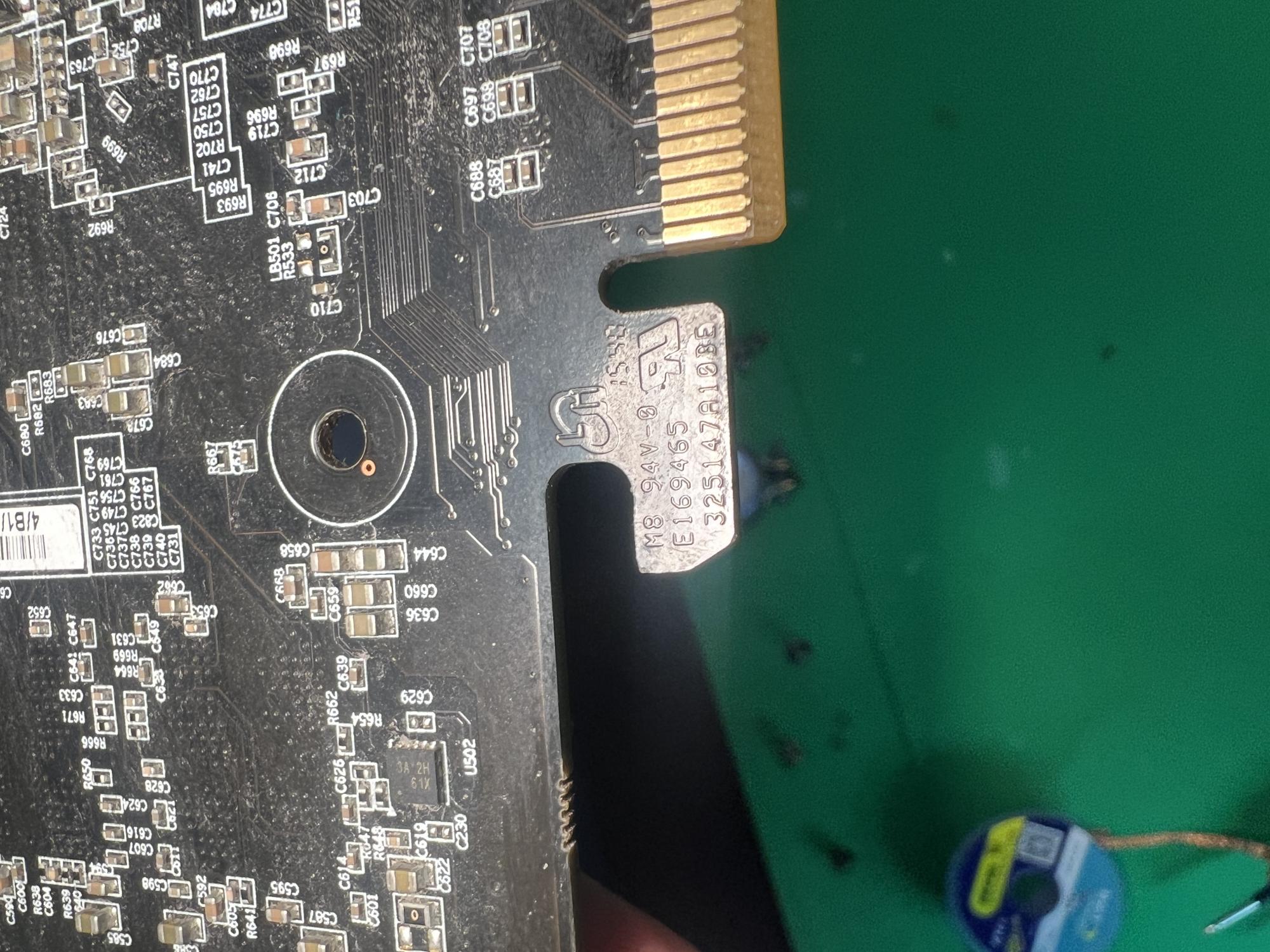

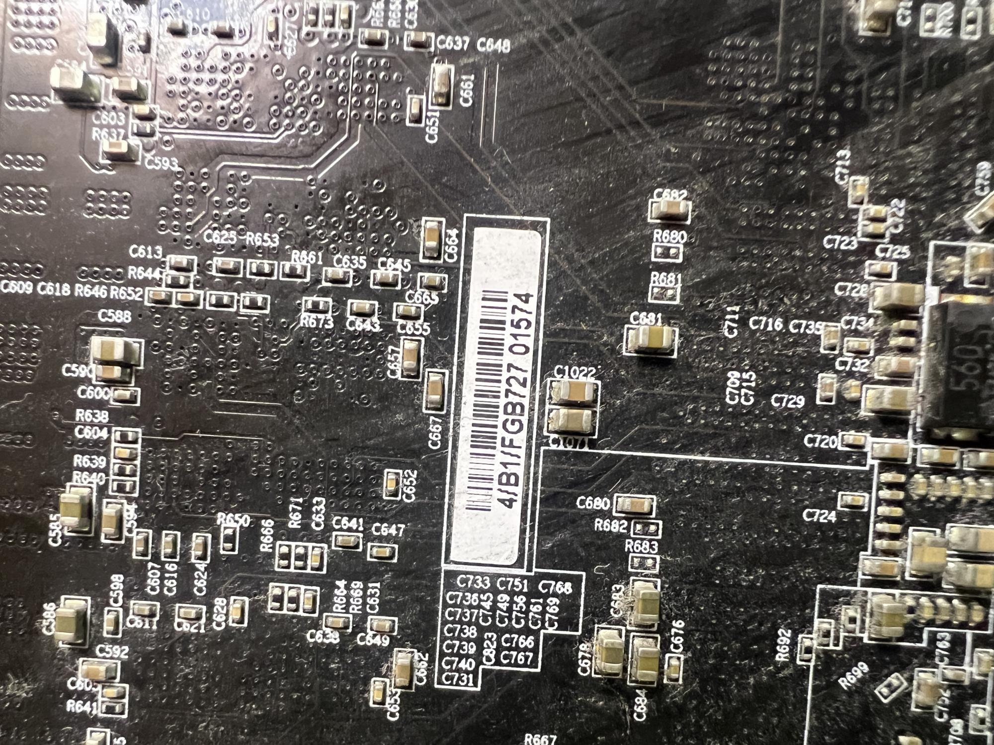

              Hi everyone,
              i have been looking through all the boardviews related to mine but i couldn't find the right one.
              this is everything that is written on the board.
              the 2phase mosfet I have identified based on the other one but there seem to be 2 resistors missing that i can't identify.
              thanks in advance

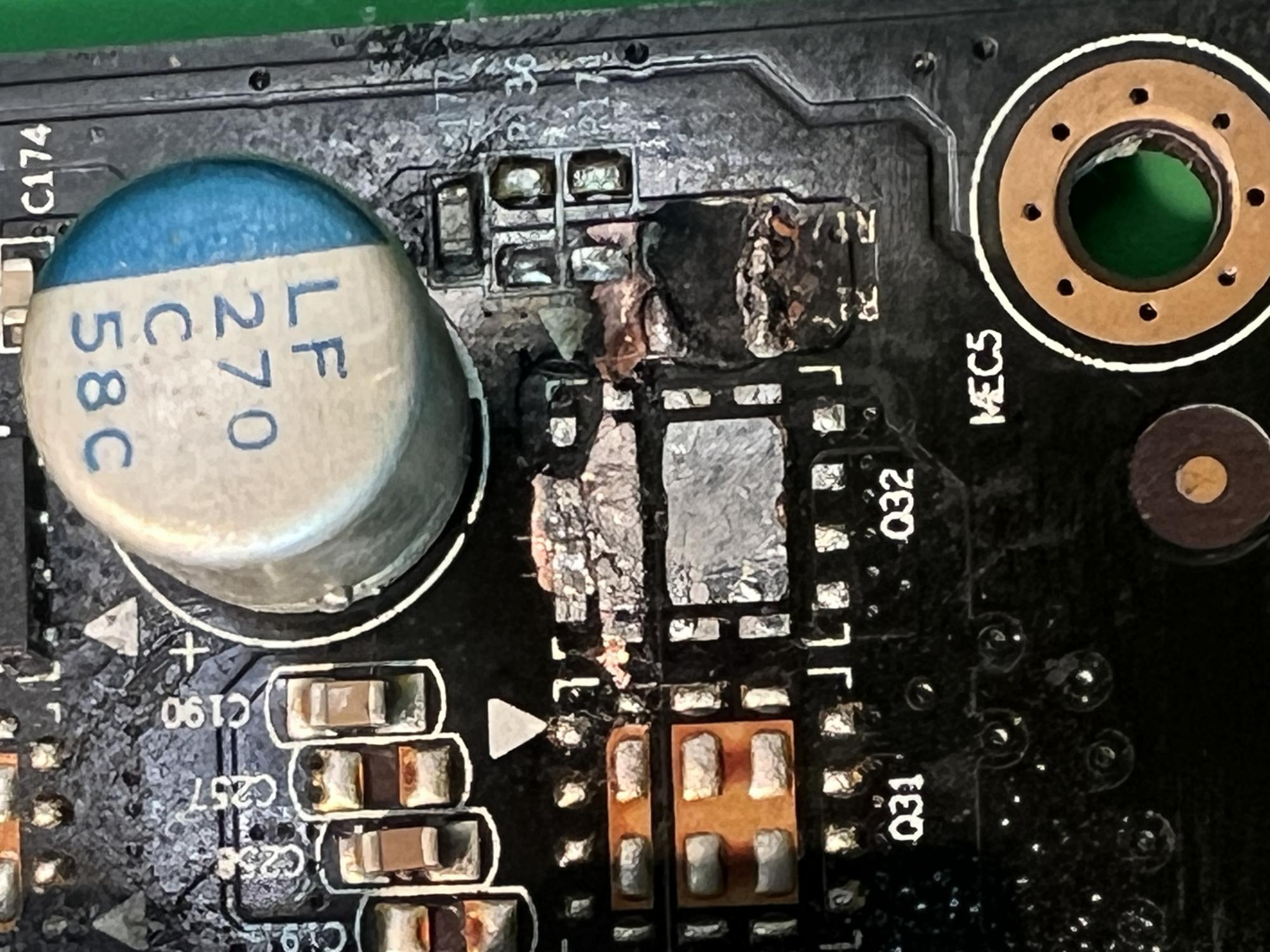

                                        #1359
                                        I am searching for the probable resistor value of the marked, ripped-off component on a defective Palit 2080 Ti Dual that I bought. If someone can measure it or provide me with schematics/layout, it would be much appreciated.
                                        • Black3R
                                          Black3R commented
                                          Editing a comment
                                          Hi man, I meassured it for you and it is exactly like from drawing. It is a BAD CAP, haha :-D From drawing C4382 0,1uF 16V 0402 X7R and fortunatelly not important.
                                      • Joe24
                                        • Jun 2021
                                        • 53
                                        • Eh?
                                        #1360
                                        @TrailandError:
                                        Appears to be the same or very similar board as MSI MS-V371. According to V371 boardview, which can probably be found somewhere in this thread, component is #C4382 (pin 1 = USBC_VBUS, pin 2 = GND), 0.1µF capacitor, 0402 size. Pin 1 is on the right in your picture, pin 2 is on the left.
                                        I doubt replacing this cap is going to solve anything though, unless the USB-C port was causing you trouble. Should function without it, although maybe a bit unstable.
                                        I'm looking at that chunk missing out of the board right next to your component of interest, and thinking that I wouldn't pick this fight. Probably multiple layers of circuitry missing / cut / damaged / shorted-together. Just my 2 cents.
                                        • TrailandError
                                          TrailandError commented
                                          Editing a comment
                                          Joe24 Hey Joe, thanks for the fast response. Actually, I have no clue what the issue with this card is. I bought it without a cooler, and a cooler arrived this week. Over the Christmas days, I'll be back home at my gaming setup and can test it.
                                          Regarding the board damage I saw before buying it. Only the first two layers are damaged. The second layer has only the insulation affected, and on the top one, I bridged the ripped-off track. There is no short between the layers and signals. the layers and repair were coated between each other. Repairing boards itself is something I love to do. If you want, I can provide you with some close-up shots under the microscope and update you on whether it works again or if it was money wasted.
                                        • Joe24
                                          Joe24 commented
                                          Editing a comment
                                          Hey if board repair is within your capabilities, then go for it. Any card that's had abuse on this level (chunks missing) is likely to have other issues, and I wouldn't take it on unless bored or well-remunerated - and I've never been bored.
                                          I'm just a bit surprised that someone experienced in repairing multi-layer circuit boards is unable to find commonly-available service data . . . and fires the parts cannon without determining the card's problem first. Personally, I prefer a more systematic and measured approach.
                                          Thanks for the offer of pictures, but I have no emotional investment in you or your card, and have thousands of my own pictures.
