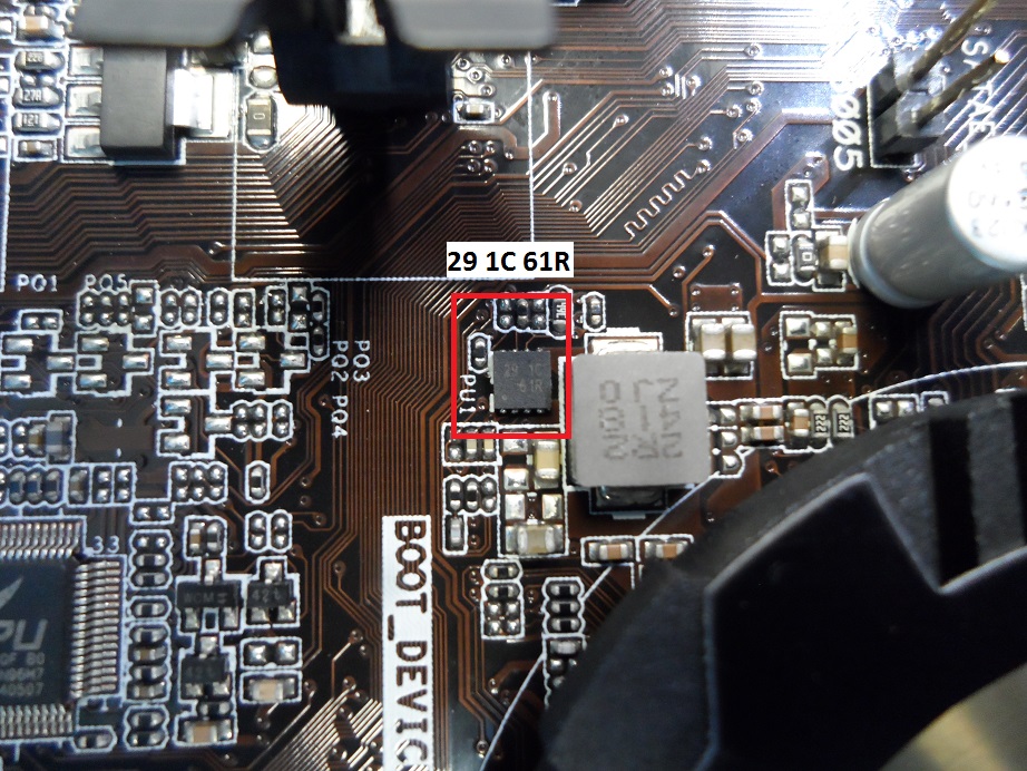

    Z97-a IC ID Schematic
    Hi all, would like to solicit your help in ID'ing the IC in the picture. It appears to be a driver. It's located next to the PCH. Appreciate any help you can offer. Thanks in advance!
    • 21841
    Re: Z97-a IC ID

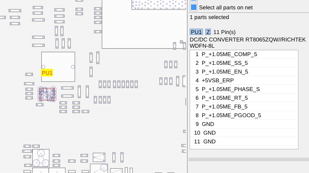

    Its a Richtek RT8065ZQW .The Z97-A boardview is attached if it helps .

      Re: Z97-a IC ID
      Datasheet:
      Hello and thank you, very helpful information! Appreciate your help.
