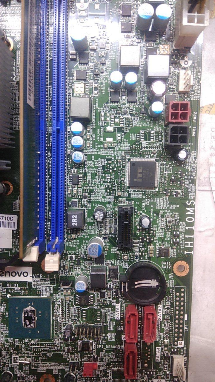

Lenovo ih110ms bios plz

    Re: Lenovo ih110ms bios plz
    plz hellp !!!

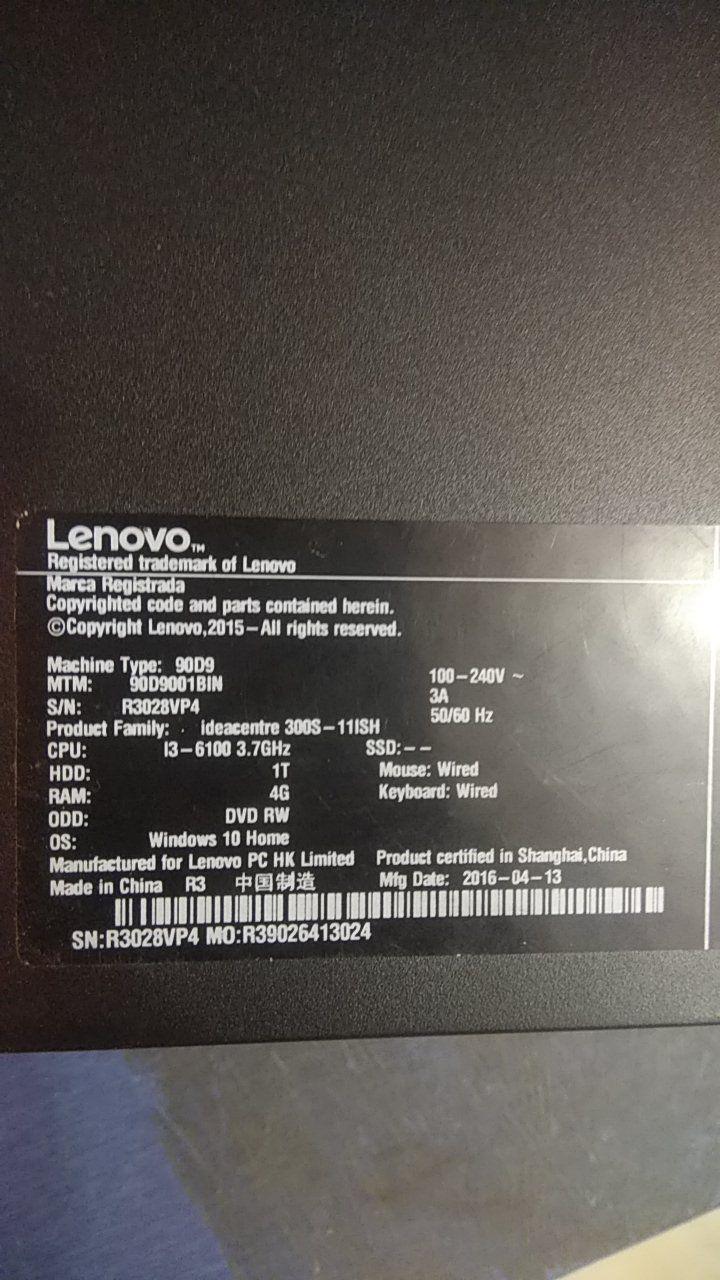

      Model number and machine type. ?
      • mahmoodjavan
        Banned
        • Mar 2018
        • 584
        • iran
        this
          • 22415
          You have the info you need with the serial number to find the bios on lenovo support. https://pcsupport.lenovo.com/gb/en/p...earch=R3028VP4
          The bios may not show in the list of downloads if you`re browsing the page using an OS that doesn`t support the bios.For example,i`m using win 7 ,the support page doesn`t show a bios download (the webpage detects the browser and OS version),so in the Operating Sytem list change to a different OS (win 10) and then the bios download will appear. Download the bios and extract it with 7-zip,winrar ,the full 8MB bios is there ,imageFY.bin
            Here is the working bios.
