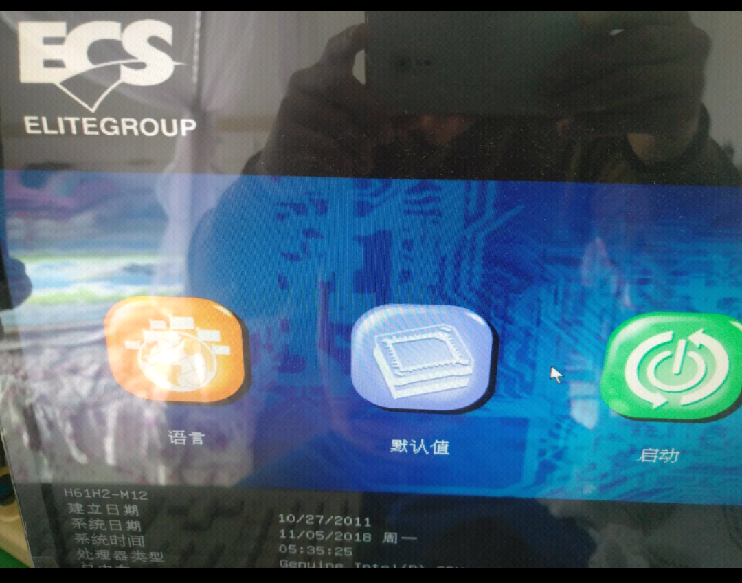

    Hello, may I ask who has ecs h61h2m12 v1.0 October 27, 2011 version bios (picture shown) can share, the picture is 2100tes cpu normal boot is a photo, after updating the new version of bios 2100tes black screen, if you can Good is the ch341 editor backup bios, thank you very much! !

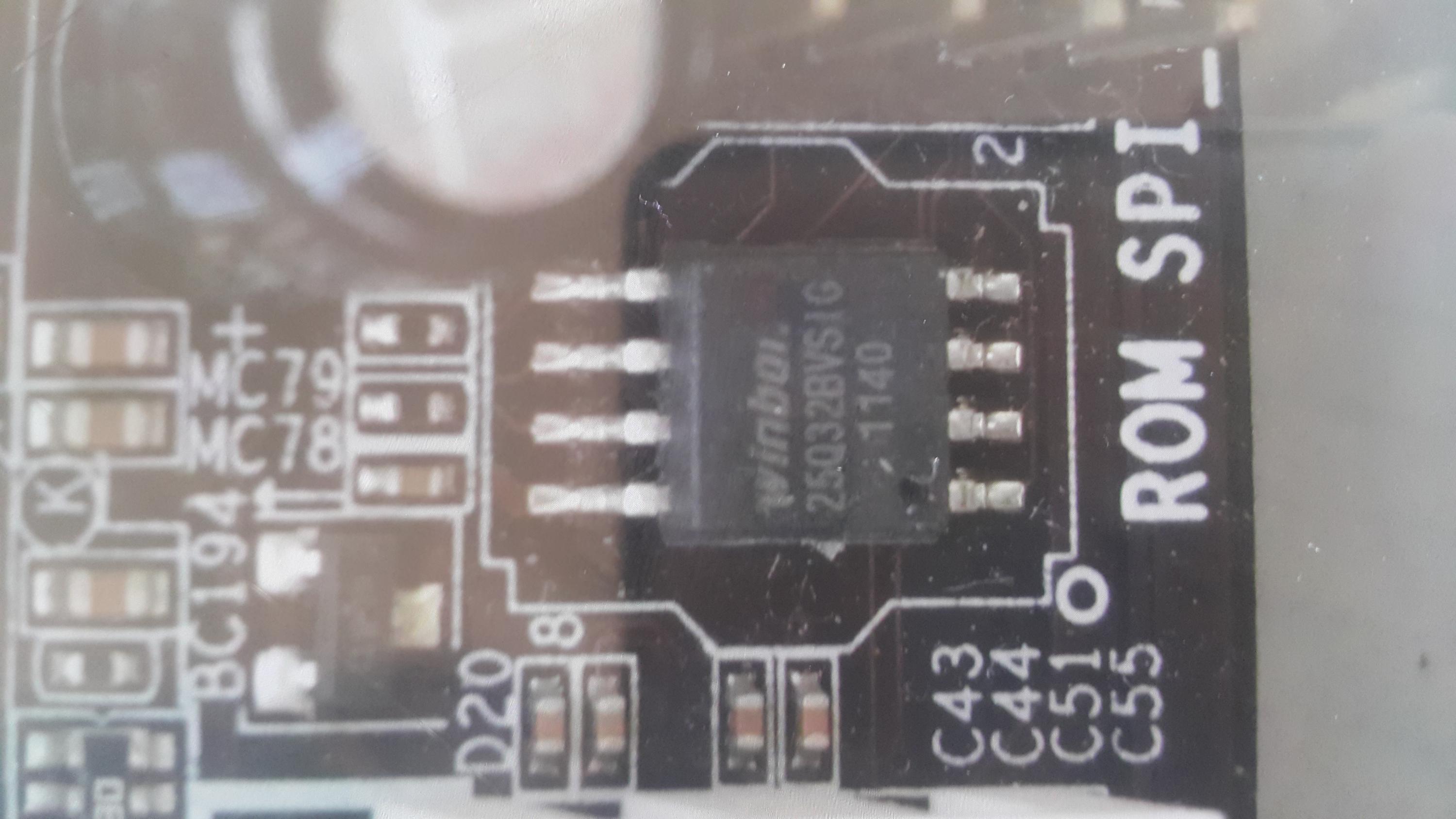

    here .Don`t use a clip with the CH341A the clips don`t work very well ,desolder the bios, and make sure to verify after writing .
