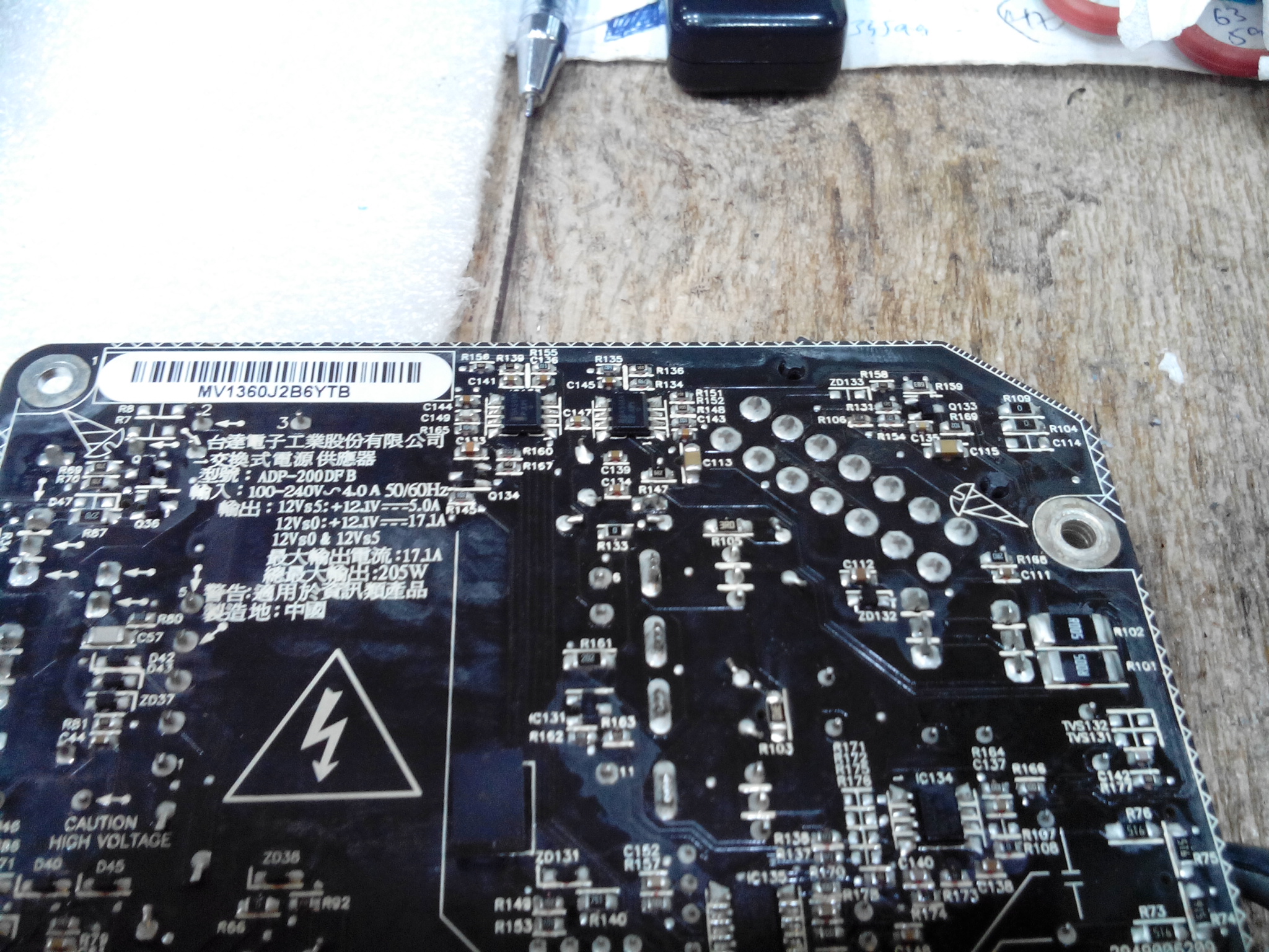

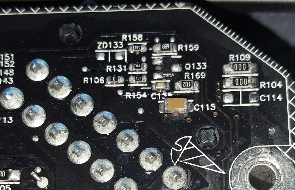

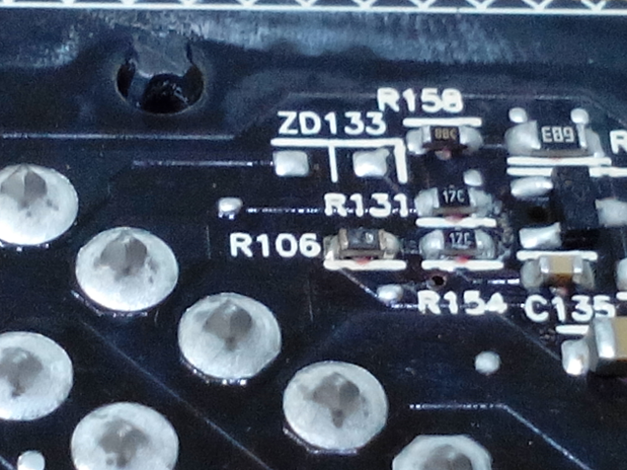

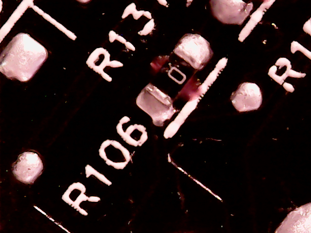

    Dear i Need Power Supply Schematic with boardview for ADP-200DFB (A1311)
    What is value of R106
    NO BACKLIGHT PROBLEM
    Please help me out

    Re: Someone have schematic to Apple iMac Power Supply
    it looks like 0

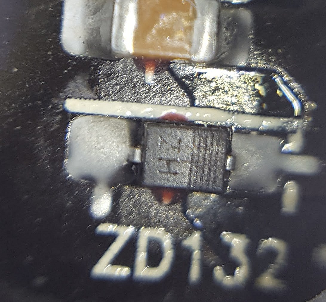

      Any good pic for the ZD132 would be appreciated.
        @Rashid36 -
        R106 is a 0Ω @ 1/10 or 1/16 watt resistor acting as a fuse. Fix the backlight problem first, or you'll be back replacing this again.
        @tibd -
        Here ya go. Same as ZD131.
        ZH marking - SOD323 package - 12V
          thanks a lot, appreciated.
