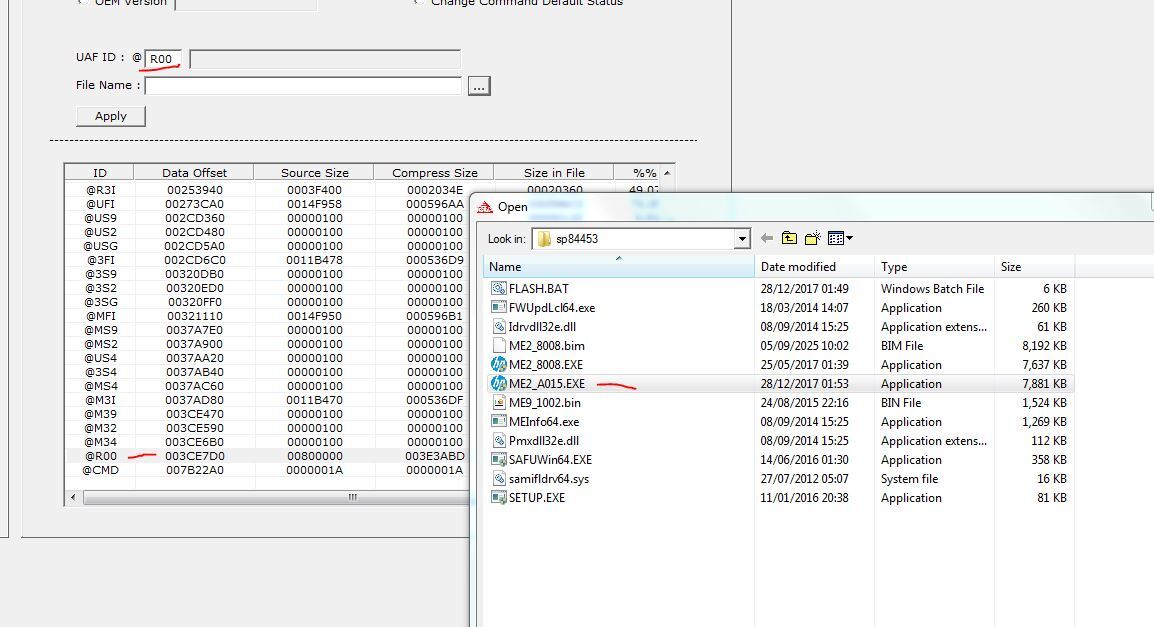

      Originally posted by olfelys
      Already checked HP support & Win-Raid packages (they only contain Intel ME firmware, not the BIOS).
      They do contain bios images inside the executables. You can extract them and the sig files using AMIUCP . Is this the thread you found at win-raid as it has some useful info regarding the bios updater failing to flash due to the file naming
      https://winraid.level1techs.com/t/pr...i-aptio4/33124
