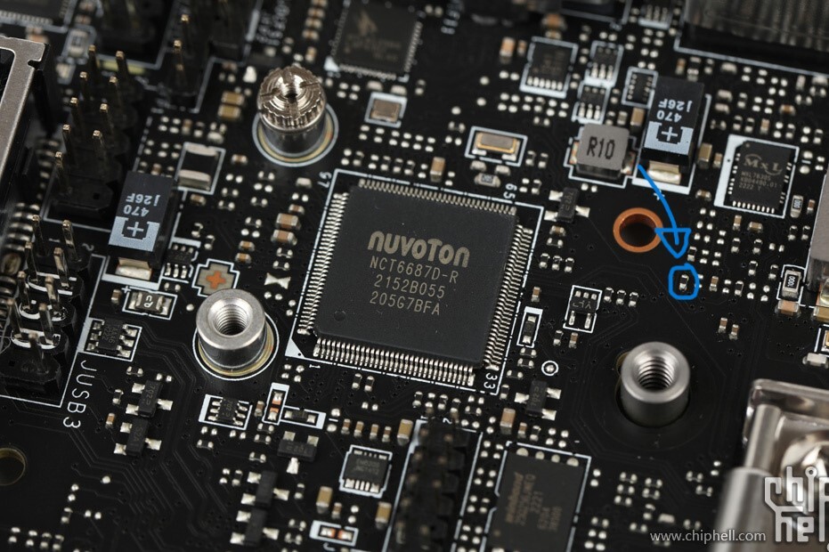

    Hi, i have this motherboard but it is missing one resistor near the MxL7630s chip. The board starts but the CPU/Dram led is always lit and i think this resistor could be the fault.
    I will attatch a picture of the missing resistor, Maybe somebody knows the value of this resistor or have the Schematics/boardview for this?
    Best regards

    Zero, 0 Ohms

      Ok thank you, So can i just bridge that then?

        Temporarily, you can solder the jumper to check the operation of the motherboard. According to the scheme, two zero resistors run in series. But after that it is better to solder the original 0 ohm resistor

          Great, This worked so now i have to order some 0 ohm resistors.
          Many Thanks for helping me with this as this was the last fault i had to fix.
