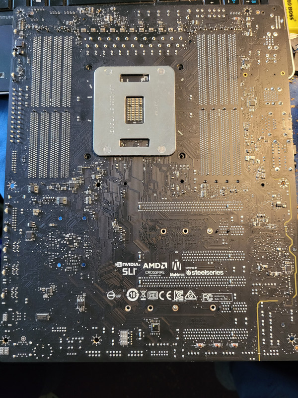

    Hi
    I could´nt find boardview of x299 MS-7A95 V1.1 . Found some missing components and replaced them but there are still some resistors or caps missing...
    thx

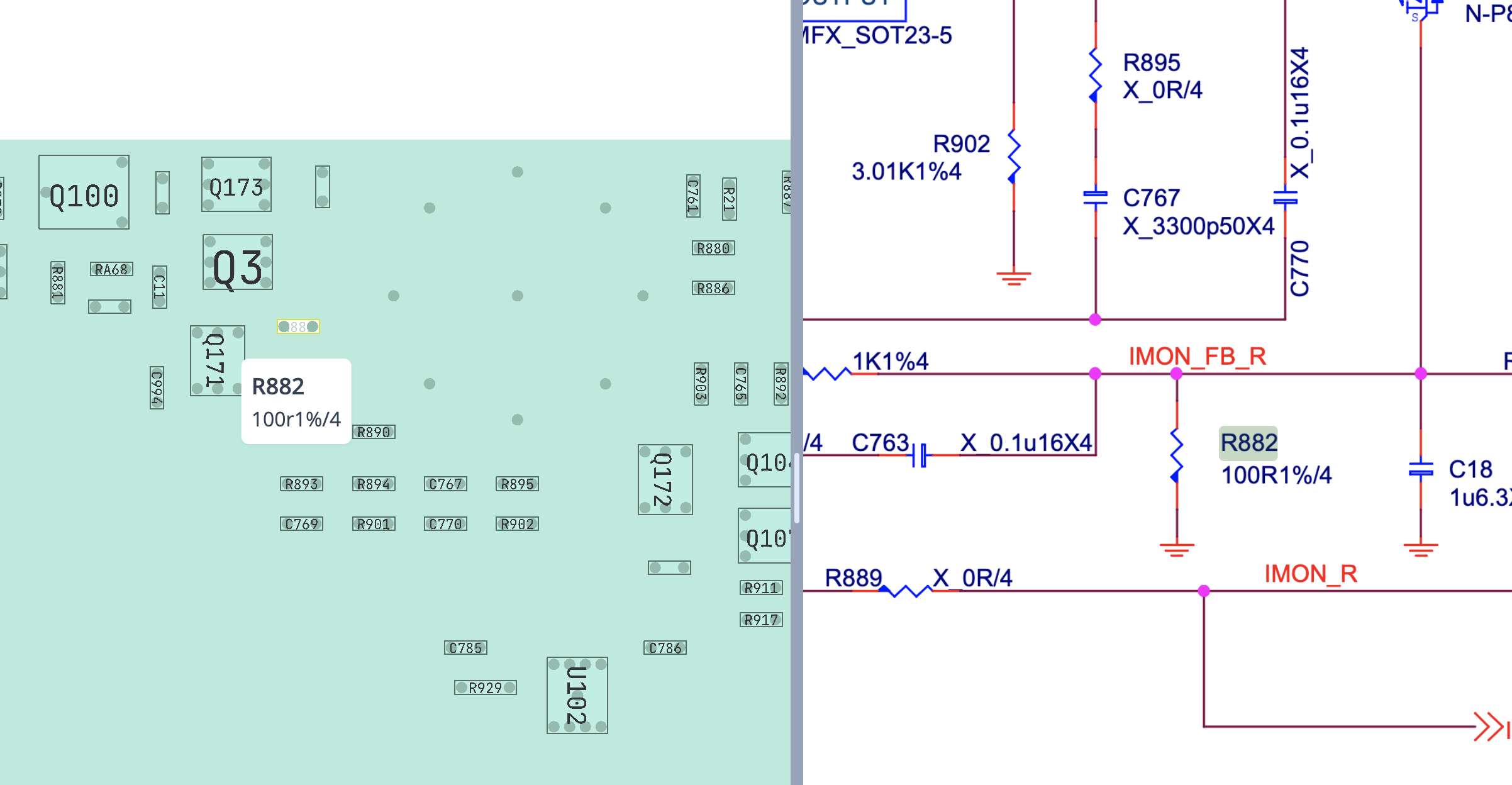

      Here you are:
      Click image for larger version  Name:	MS-7A95 R882.png Views:	52 Size:	218.9 KB ID:	3285149
      Click image for larger version  Name:	MS-7A95 C761.png Views:	47 Size:	263.7 KB ID:	3285150
      • stormanimal83
        • May 2014
        • 74
        ohh my god! thank you soooo much! i appreciate that... you saved me... giong to try it. after the weekend i will let u know if i was succesfull
