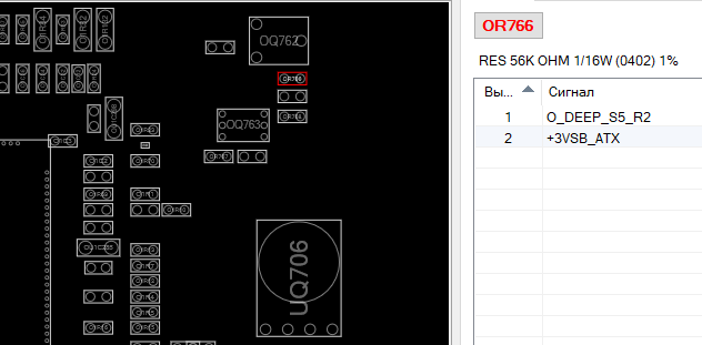

    Does anyone have a boardview or schematic file for an Asus TUF Gaming X570-Plus(wifi) R1.05? I have the boardview file for the R1.04 version of the motherboard, but it's different in the area where my R1.05 board appears to have had a component broken off.

    Hello! It's hard to find the R1.05 boardview and schematics right now. Could you please post a clear image of the broken component area ? That way, someone might be able to help you.

      Here are two pictures showing the area where I suspect a resistor was broken off.

        I have the same motherboard , i will attach the values tommorw morning.

          The 56kOhm resistor

                To follow up, I installed that 56k resistor and the motherboard works now!
