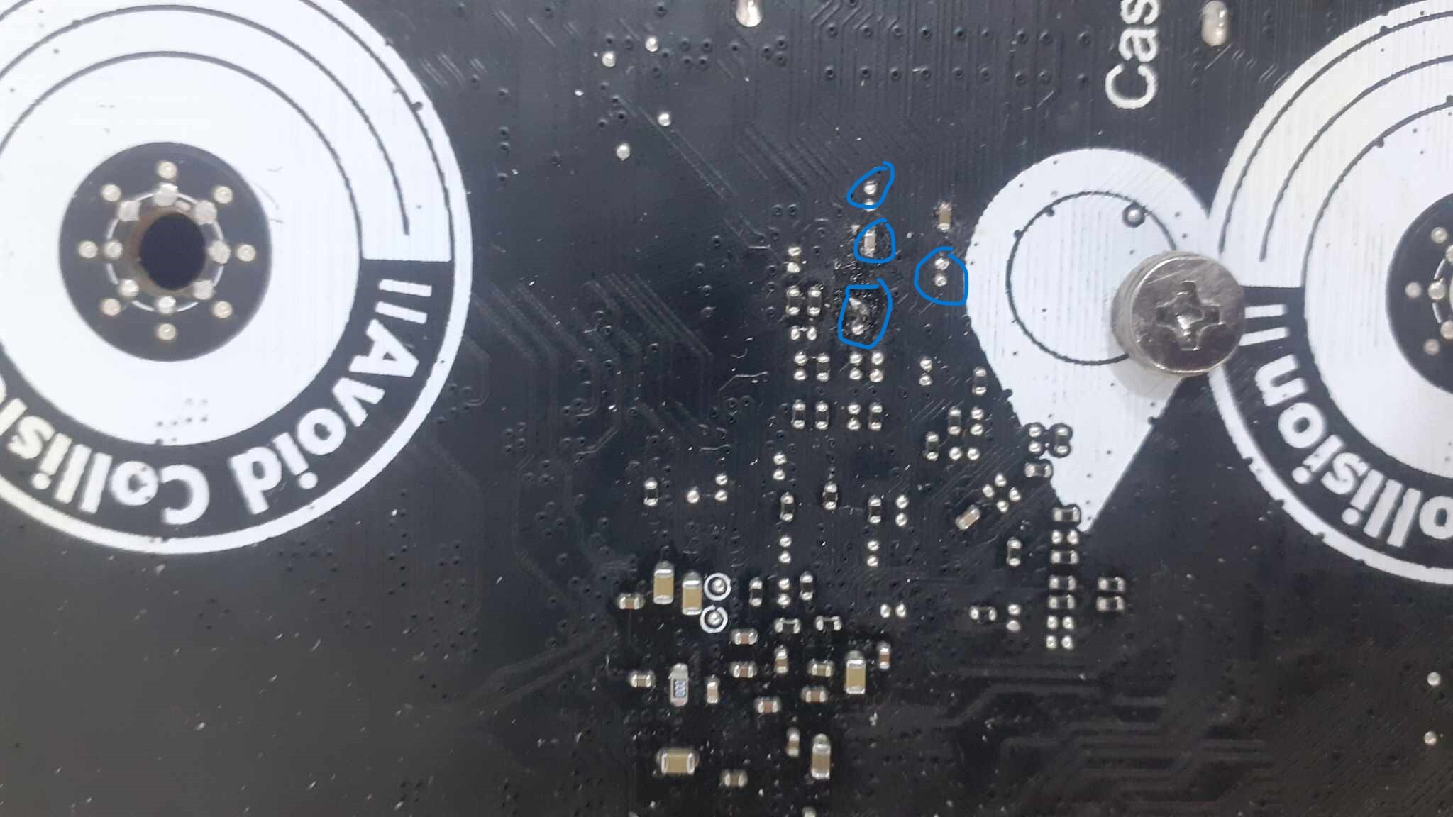

    HI
    i need boardview for msi b660 ms-7d42 because some components are missing behind pch (resistors and capacitors ) the motherboard just stop on yellow dram light

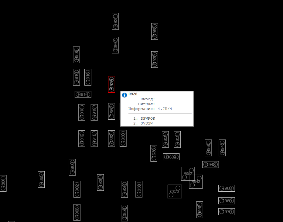

    There is no lower resistor 4.7K Click image for larger version

      but without this reistor motherboard not power on
      please share with me the boardview
