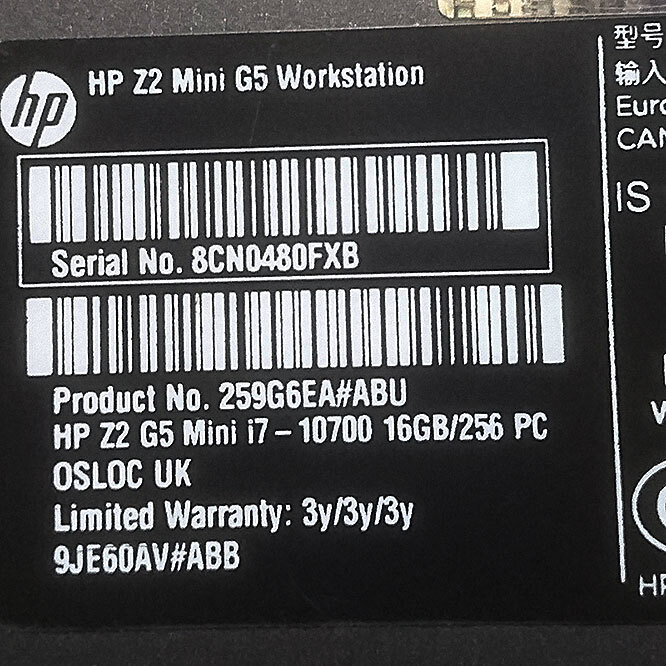

    Serial ?
    • reeluff
      • Jun 2023
      • 32
      serial of what, the main unit, motherboard, or? and where to find it - numbers everywhere. Will add the info, out of interest how does this help diagnose?
        Try it

              • 21173
              The PC serial number.It will be on a sticker.With the serial we can find the right bios update from HP support,and check if the serial on the sticker matches with the one in the bios.Also the serial is required as per the rules
              https://www.badcaps.net/forum/troubl...before-posting
              Click image for larger version  Name:	HPZ2Mini04.jpg Views:	0 Size:	129.6 KB ID:	3158489
              • reeluff
                • Jun 2023
                • 32
                thankyou, it matches what is inside both 32/16 chips.
