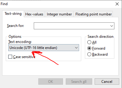

    Hi, Can I ask for some help. The PC starts, there is no display, the led is red. I updated it from HP's site, but it doesn't have DMI and now it doesn't have data and the network doesn't work. How can I copy the old DMI data? Thanks!

                You should to search for it in "Unicode". Go to that Offset (583105h) and you will see your DMI.

                  Now it is working. Thanks for your work!

                      L01_0221 (Just GBE).rar + BCU
                      In the meantime, I checked the 'bin' and realized that I couldn't find the DMI data because there is a dot between each letter...

                        Yes, as I told you in Post #8, you should search using "Unicode".

                          Yes, I did it. Later But at the beginning I didn't know that. It was in the default setting and I couldn't find it.
