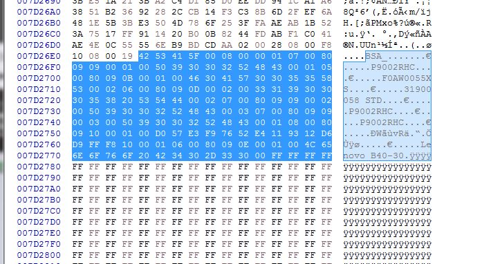

    guys i flashed this Lenovo AIO B40-30 but needed to copy dmi info. i locate dmi part but this bioses looks very different between.

    Search for the word BSA with a hex editor for the DMI. You know how to find the key.

      thanks mate
