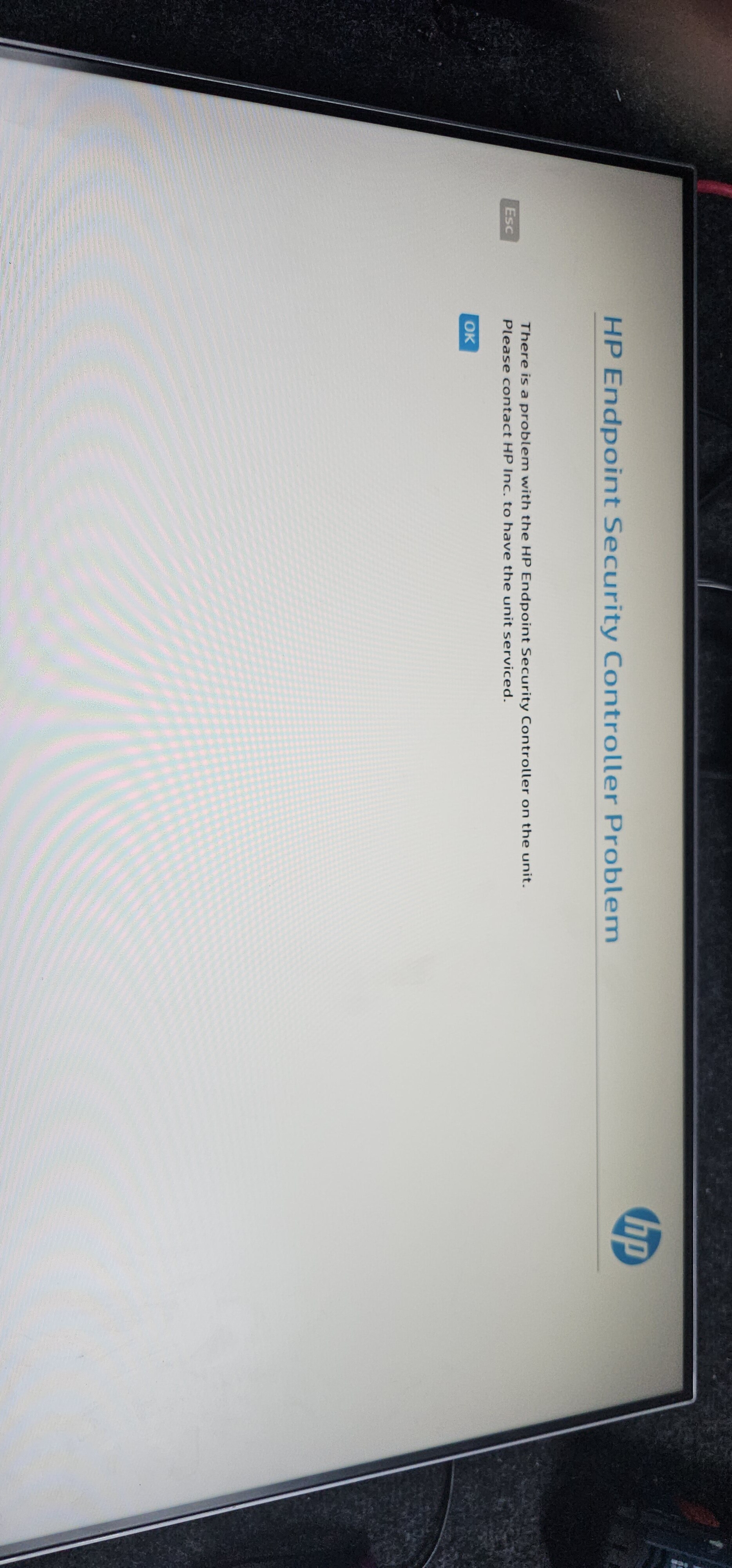

        Hi masters, can anyone help me to clean ME? I tried that with no success (ME analyzer, found right ME, use ME to to inplement it, nothing works) . Finally unit did not start at all, I had to flash back back ups... PCH has been shorted, so I replaced it, need to clean it. Maybe there is other problem with board, but I think ME region problem. Many thanks
        HP EliteOne 800 G4
        DA0N31MB6H0 REV H​

              • hopkok
                • Oct 2014
                • 178
                • Slovakia
                Hi, its working, but on boot getting this error. Is it fixable? Many thanks anyway sir.
                  Uplload ec file
                      EC file
                      ZZZ

                        Need to flash both?
                          Need to flash both?
                          Yes ..

                            Originally posted by hoaca388
                            Yes ..
                            Hi, with this bioses unit not starting at all.
                            So now I made backups of both bioses before flashing. With these files, unit works with error, can you have a look on it one more time please? Thank you
                              Try again .I'm so busy these days
                                  Hi, did not work, I finally used original EC file and your last main BIOS dump. Put DMI back right in BIOS after boot. All works well now.
                                  Many thanks for help mate!!!
