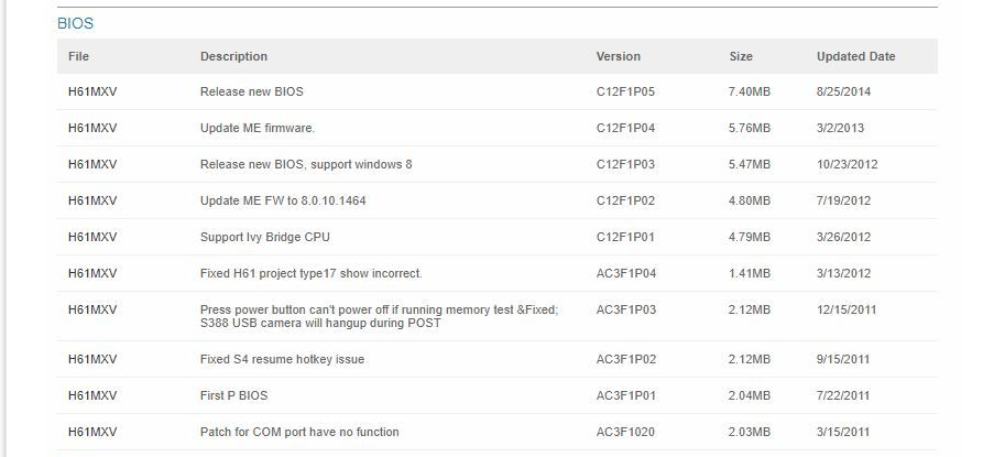

    good afternoon , i need this bios

      Try. H61MXV bios

          with p04 pc power up but shutdown after 2 sec (that was the problem i have at the beginning)
          with p08 pc power up stays on but no screen
          can you send me another rom

            There are two firmware, different versions for this model, maybe you don't have it, check the RAM, clean the contacts ...

              bios c12f1p05 .what cpu are you using ?

                intel i7 second generation

                  Ver. "C12F1P05" is the latest bios, no more bios was released for this motherboard.

                    thanks it works , i replace the ram also

                        Salam, I know its been 2 years but did you flash the C12F1P05.BIN or P04? I flashed P05 but it gave no display like george_gpu on my Foxconn H61mxv Rev 2 with an i5 2500. But P04 worked fine.
                        My Board was second hand and some genius had put an intel DH61BF bios on it and it was glitchy, missing sata ports in windows and pcie ran at x4. That bios was write protected so to flash it I had to take it to a shop.
                        I wanted the latest bios as these boards have an issue where they don't support GT(X) 700+ and RX 400+ gpu. Now I am not sure if that issue is fixed or not unless I borrow a gpu to test it as I wanted to upgrade from an R5 240 to a Radeon WX2100(RX 550 core).
