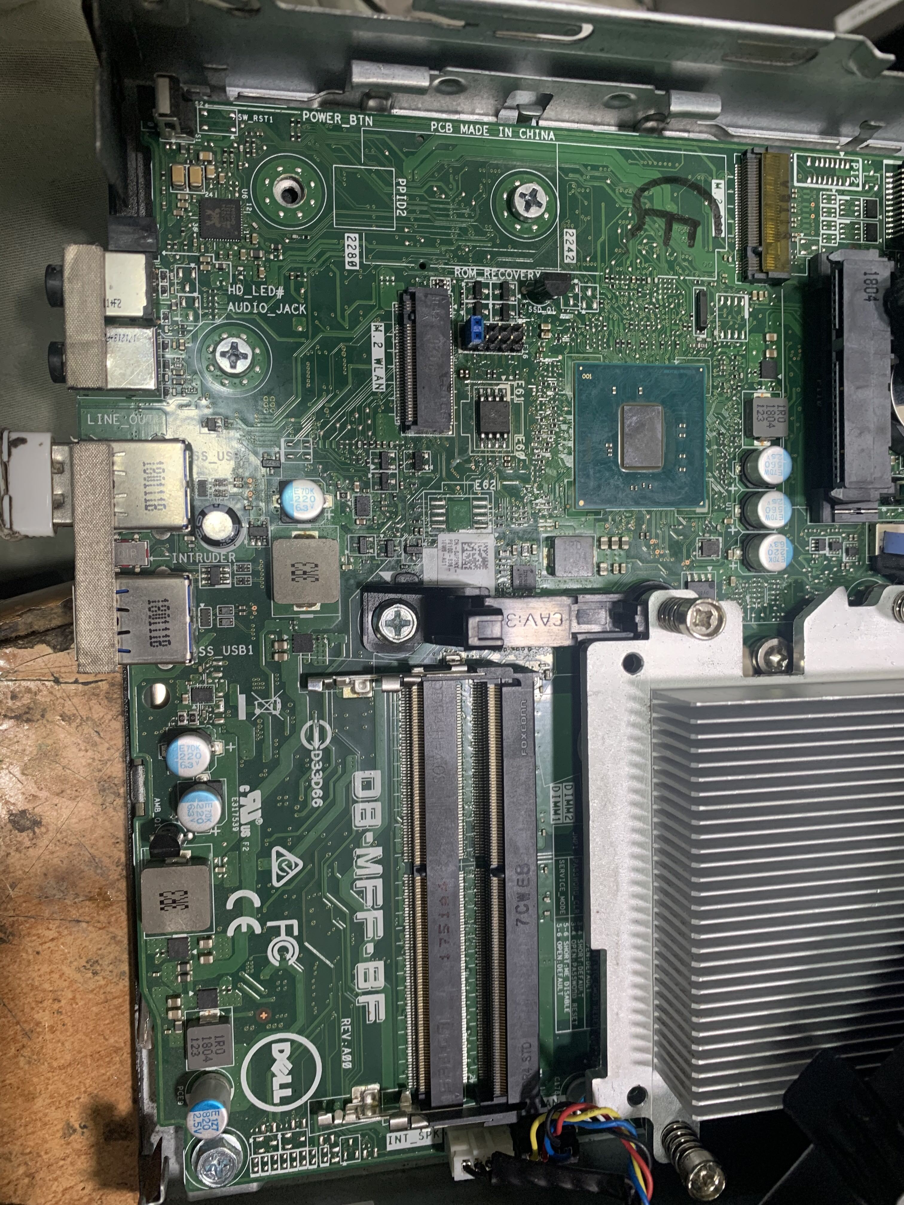

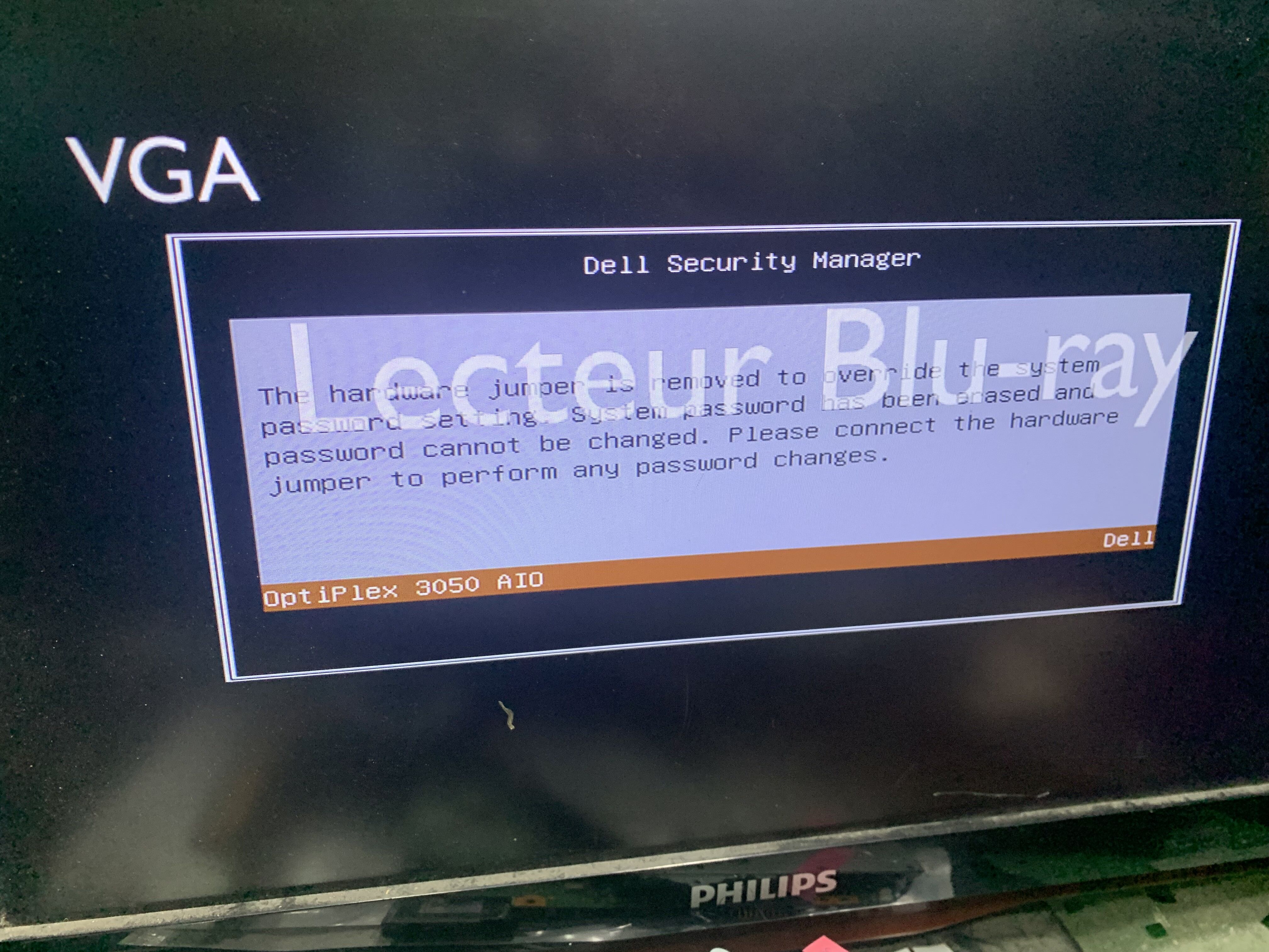

                        • shiriff47
                          • May 2018
                          • 43
                          • Algeria
                          can anyone help me, i have the same problem, i have Optiplex 3050 micro but it not working with any bios i've tried so many dumps with no luck i tried extracting from exe file also with no luck it only works with the bios of optiplex 3050 AIO and it gives me errors in startup like the fan is not working properly & the password jumper is not present, is there any solution.
                          This is the Bios that work but it's the Optiplex 3050 AIO
                            • 20918
                            Why did you even consider using the 3050 AIO bios ? .Even if it does partially work,it doesn`t mean that its right one,thats why you have all those errors. If you have the original backup post it.
                            • shiriff47
                              • May 2018
                              • 43
                              • Algeria
                              it came to me in this situation for repair, the customer gave me this backup and he said that this is the original backup
